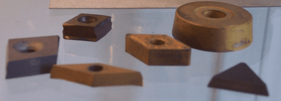

As far as separating out the Tungsten Carbide, just make it a point to toss used inserts, carbide endmills, and other carbide toolling into designated scrap buckets that are never used for anything else.  That makes it easy.
