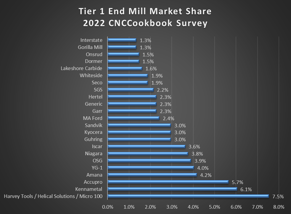

First Tier End Mill Brands
Collectively, this tier garnered 70% of the votes, so they have most of the market share for this audience.
Here is how you voted for these end mills:
The top 3 brands were Harvey Tools, Kennametal, and Accupro.  Compared to last survey, Kennametal moved up 1 place to replace Accupro.  Harvey, while it retains first position, is actually down a bit as we broke out Helical and Micro 100 as their own players in the 2021 survey.  The combined share would have been 6.9% + 4.2% + 1.3% = 12.4%, so it’s been a significant move.
Accupro is MSC’s house brand in case you didn’t know.
Other movements from 2021 – 2022:
  • Amana is up from #7 to #4.
  • Kyocera is up from #22 to #10.
  • Garr has fallen off from #9 to #13.
  • Iscar has risen from #10 to #8.
  • Niagara has gone from #13 to #7.
  • Lakeshore Carbide, Dormer, Onsrud, Gorilla, and Interstate are all peeking in on this group for the first time.
A lot of this is normal market fluctuation, but clearly some brands are moving far enough to indicate they’ve made progress in 2022.

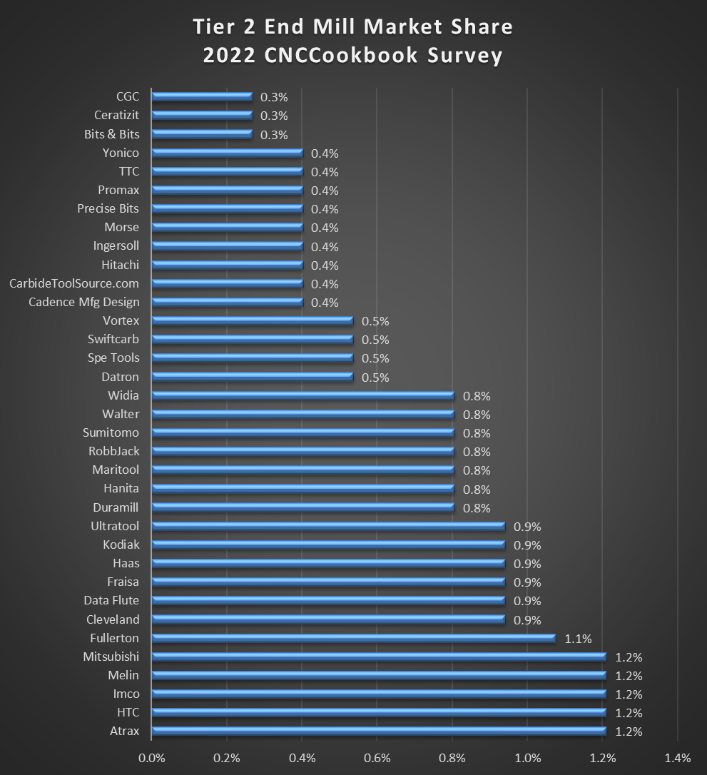

Second Tier End Mill Brands
Collectively, the second tier garnered another 25% of the votes, which brings the total market share of First and Second Tier to 95%.
There are a lot of great brands in the second tier.
The remaining 5%, representing the Third Tier, had 40 brands, each of which garnered just 2 or fewer votes.  That’s too little participation to give us any statistically significant trends.

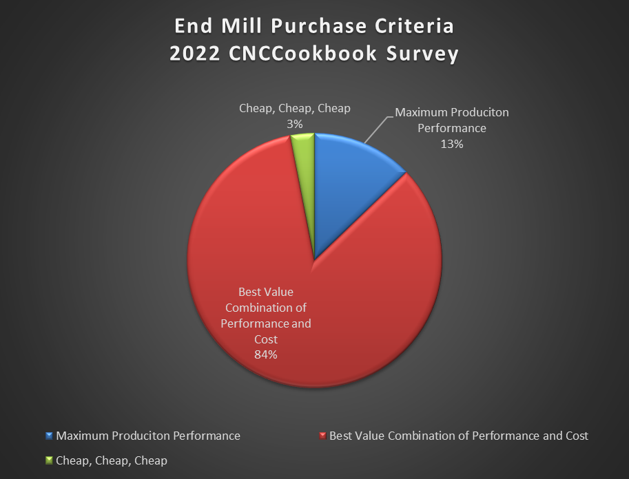

Obviously just straight up brand popularity doesn’t tell the whole story on which end mills might be worth looking into.  We also asked the survey respondents why they were buying with 3 choices:
  • Maximize production performance
  • Best balance of value + performance
  • Cheapest
Here’s the result:
There’ve been some pretty pronounced movements out of the Cheap and Max Production categories into the Value Category.  In 2021 we had 73% choosing vvalue and this year it’s gone to 84%.
How you’re thinking about the value the tool brings is going to affect your choices for sure.  But consider this:

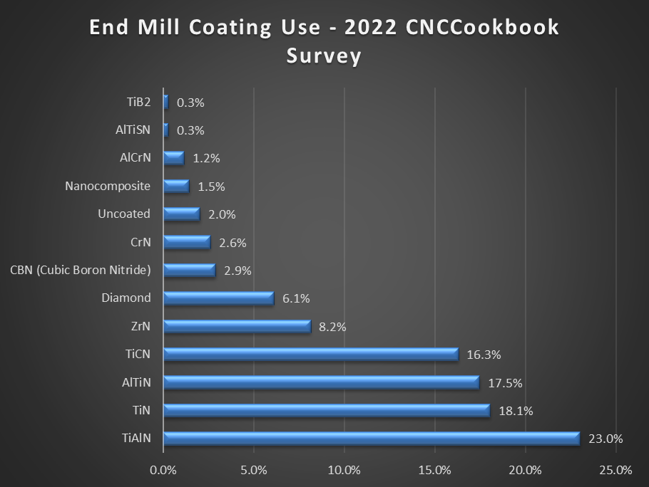

Another question we asked on our survey was which coatings you prefer to purchase.  Coatings can increase the performance of end mills considerably in terms of Tool Life and Material Removal Rates, so it’s no surprise that coatings are very popular.  Here are your choices:
The most popular coatings are TiAlN, TiN, and AlTiN.

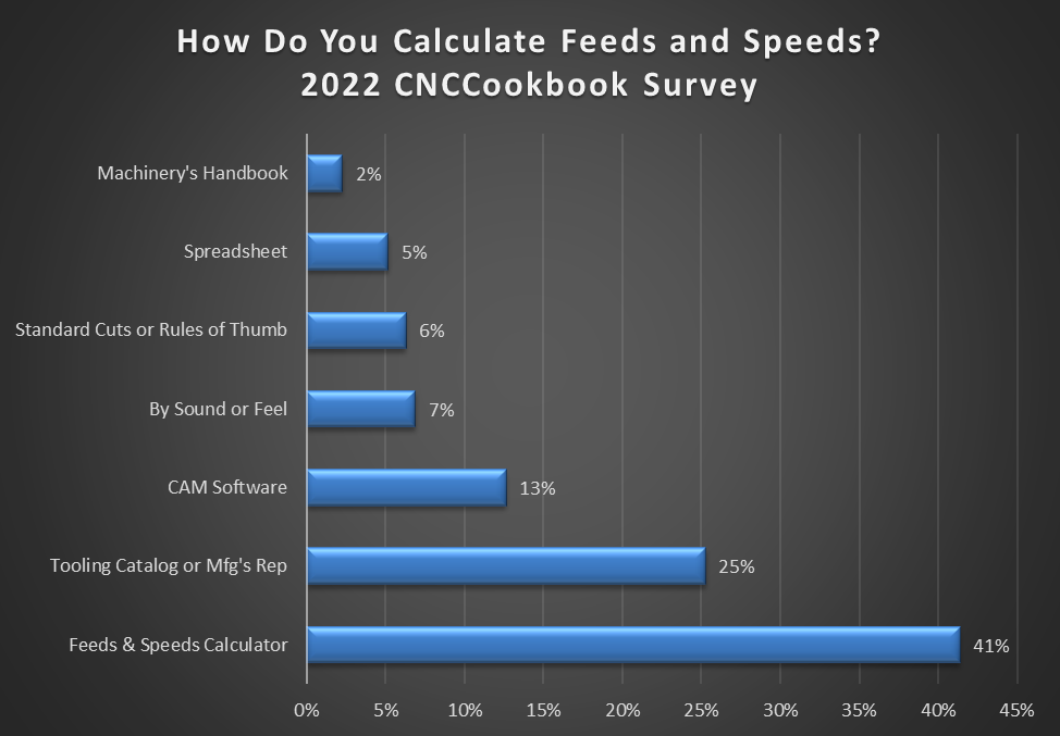

How CNC Machinists Calculator Feeds and Speeds
Feeds & Speeds Calculators are by far the most popular method, and it is up from 39.6% in 2021 to 41% in 2022.

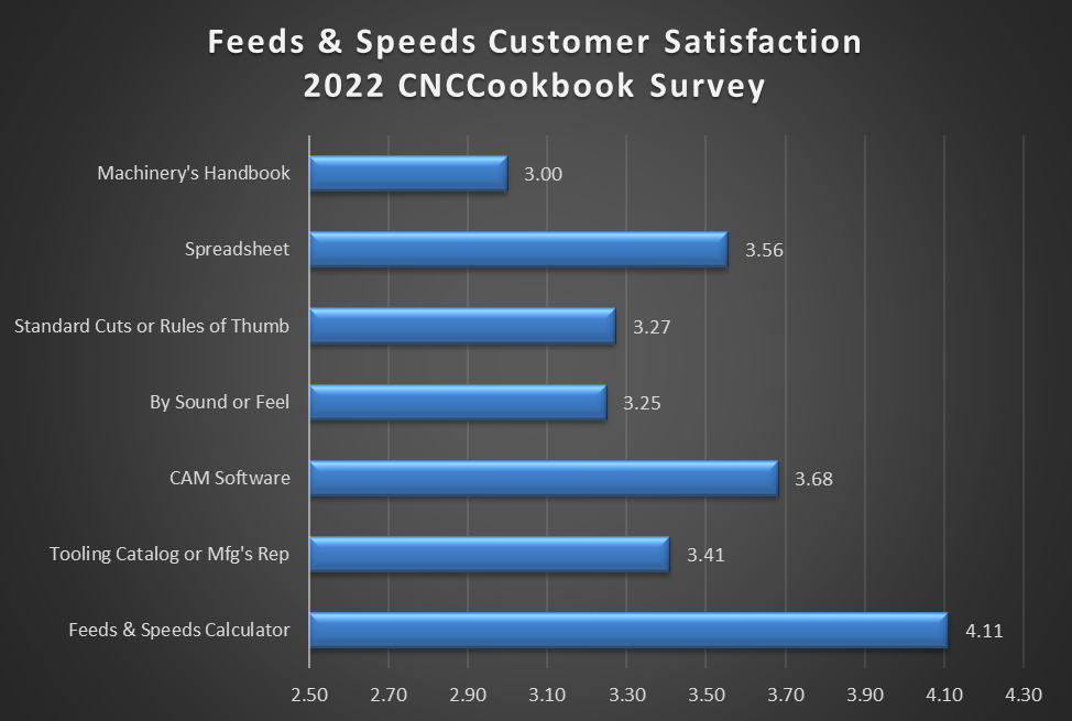

We also asked about Customer Satisfaction.  In other words, “How well are your feeds and speeds working with that method of calculation?”
Here are the results:
Not only is a Feeds and Speeds Calculator the most popular method, it also works the best.  In fact, from Best to Worst here’s what we have:
  • Feeds & Speeds Calculator is nearly all “It Rocks!” ratings.
  • CAM Software is #2, but trails by an appreciable distance.  It really doesn’t work all that well.
  • Spreadsheet:  I started out with a spreadsheet before I wrote G-Wizard.
  • Tooling Catalog / Manufacturer’s Recommendations:  Not surprising that the Mfg has something to contribute.  But remember, you can provide that info to make a Feeds and Speeds Calculator work even better.
  • Standard Cuts or Rules of Thumb.  One size does not fit all when it comes to feeds and speeds, so trying to come up with rules of thumb usually fails.  BTW, nearly every CAM approach uses a database of cuts.  How exactly does that differ from rules of thumb?  Answer:  It doesn’t, except perhaps it has a few more rules of thumb
  • By Sound or Feel is 2nd to last.  This approach is something of a myth.  It sort of works for old Bridgeport manual machines, but not on a modern CNC.
  • By far the worst approach is Machinery’s Handbook.  It has it’s place, but Feeds and Speeds are not that place.
