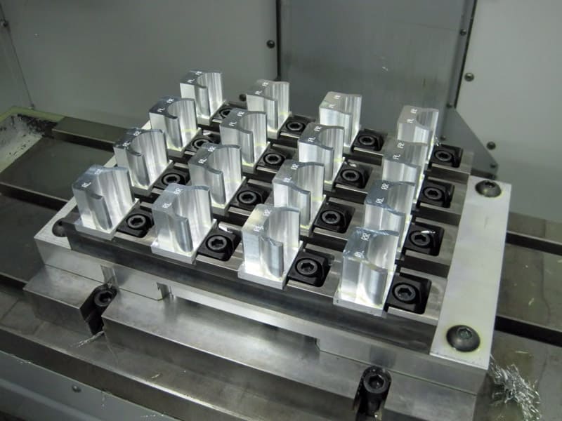

One secret to productivity on the mill is to use as much of the envelope as you can. The more parts you pack onto the table, the more it can get done without assistance while you work on something else. When it comes time to pack a bunch of small parts on, the ubiquitous vise is not the right tool. Instead, consider something more like this shopmade pallet system as seen over on Practical Machinist:
16 parts all neatly held by Mitee-Bite’s “Pit Bull” clamps…
The Mitee-Bite Pitbull’s have a sharp edge that jams the part against a stop on the other side as you tighten the socket head. They’re prefect for this kind of work. Mitee Bite offers a whole line of different cnc clamps worth checking out.
This particular fixture is also part of a shopmade pallet system. A pallet is an interchangeable plate. There is a base mounted on the table, and one or more of the pallets. By using pallets, you can drop a bunch of parts on the mill table, machine them, and them remove them all as a unit. Putting parts on or off the pallet can be done while the machine is working on another pallet, which keeps the machine productive a greater portion of the time.
