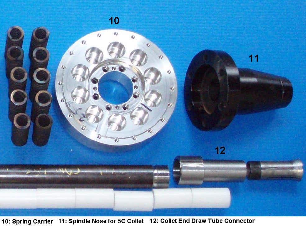

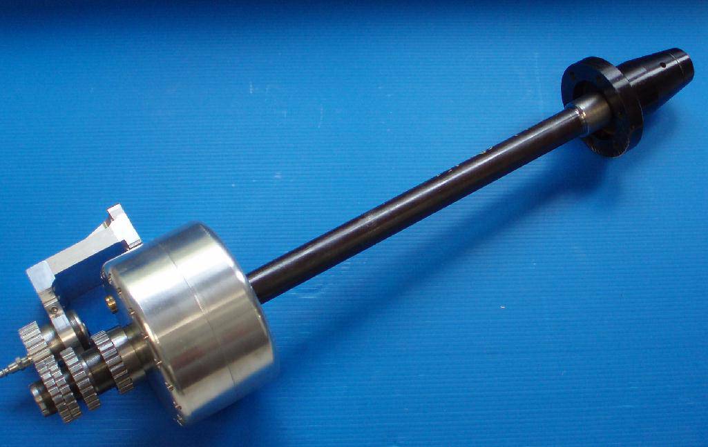

Air-Powered 5C Collet Chuck assembled…

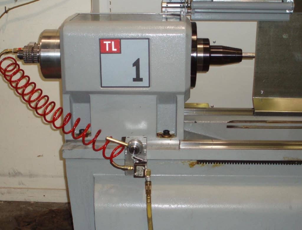

Installed on the Haas TL-1…

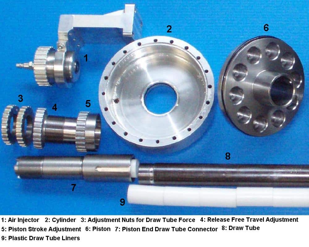

Geof discovered the optimal draw force on the 5C system is about 1200lbs. This is accomplished via 10 springs that act to return the piston to the “locked” position when air pressure is released. The estimated unlocking force is up to 2300 lbs. Based on an air pressure of 85 psi, this calls for a 27 square inch piston. Since the piston is an annulus (donut shaped), the inner ring on the piston (so the bar can pass through the center) is 2.25 inches and the outer is 6.5″. The whole thing is housed in an 8″ OD cylinder assembly made of aluminum. Looks like a big o-ring is used to seal the piston against the cylinder and a smaller one seals the piston hub. These O-rings are standard sizes.
Threaded adjustments on the drawbar end control draw tube force, release free travel, and piston stroke. The release free travel lets the tube travel a short distance to pick up speed so it can knock the collet loose. Plastic liners protect the draw tube’s interior from the bar. The tube is stainless with a 600 grit polish.
The provision to provide air is a novel design. Geof wanted to avoid designing a rotating seal, so the air is injected by temporarily mating the injector against an injection port while the chuck is not moving. The system is designed so there would be minimal damage if the spindle started while the injector was engaged. Note that the injector is not in the center, but offset, so the spindle has to index it into position before it can engage. Air pressure supplies the force to mate the nozzle to the port. All in all, its quite an interesting design. Given how expensive even lever operated closers are, let alone pneumatic chucks, I can see how one might undertake to build such a thing.

I need to make a nose with a D1-4 adapter similar to what’s in use here for my Tormach Slant Bed lathe. The current arrangement puts the end of the collet flat with the flat area where a chuck would go. This doesn’t leave much clearance for any tools that protrude from the turret for doing ID work such as boring bars and twist drills. A tapered nose like this one would help quite a lot.
Interesting design. Downside is changing it out if you need a 3 or 4 jaw chuck. I had to stare at it wondering how it worked with the rotational mass. Does he use an encoder to align the pressure point to release collet? That’s about all I couldn’t figure out unless he is manually aligning to press a pedal on the floor and release. Found this articles loking for ways to implement a pneumatic chuck on my conversion. In fact I want to implement two powered opposing spindle chucks. Considering a hydraulic sub spindle for secondary and doing the c axis work there. So many ways to skin a cat it would be nice if I had machinist friends to talk to on the phone however anyone I talk to glazes over and thinks I’m some genius of sorts when I feel like a lost cat being chased by a dog in the barn. 🙁 lol
Brian, typically changeover to a 3 or 4 jaw from a collet chuck, even a powered one, is easy. You leave the actuator assembly on back and the draw tube. Just unscrew the collet. The “nose” usually mounts just like a chuck. So that’s all there is to it.
