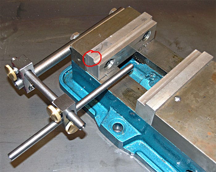

Method 3: Pick a Fixed Location on Your Vise or Fixture
This is my favorite method because it requires the least time and effort for each setup, although it does require a little advance setup be done once.
With the other two methods, you have to find Part Zero every time you drop a new workpiece onto the machine.  With this method, you find it once because it is relative to the workholding.  Let me give an example.  Suppose you use the corner of the fixed jaw of your machinist vise:
Metal vise with red highlighted corner on one jaw, silver-colored metallic jaws on blue base.
Use the corner of the fixed jaw of your milling vise (circled in red) as your part zero...
As an aside, that picture also shows the vise stop I made.  One of the handiest tools in my shop!

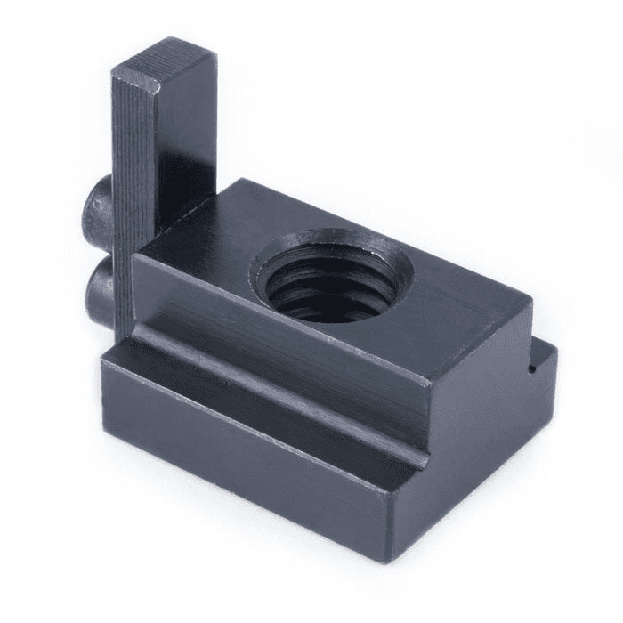

Method 4:  Use a Stop of some kind
The picture above shows a vise stop I made a long time ago.  You can set the stop up to orient a part repeatably to some part zero you measure to.
You could put stop features on a fixture plate as another alternative using stops.  Lastly, you can even get stops that fit in T-slots like these from Tormach:

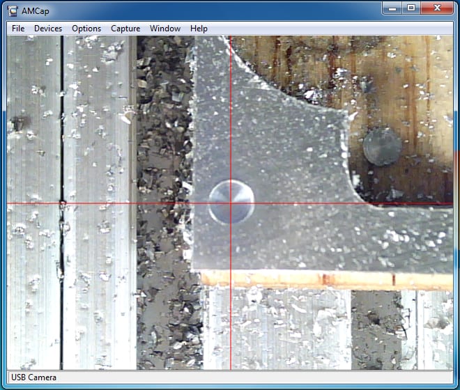

And here's a view of the image captured by the centering scope:
A red crosshair overlay in an AMCap window on a wooden workbench with a metal object.
Using a digital camera to center on a spot drill dimple...
Note that the camera is offset from the spindle centerline.  That offset is fixed, and can be factored in when zeroing.  There are also cameras that go right in a tool holder and will sight right down the spindle axis.
