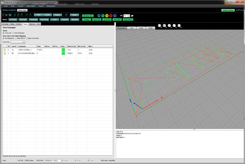

There are certain other tools that can extract information from G-code programs that is useful for Setup Sheets. For example, CNCCookbook's G-Wizard Editor software has tabs that display a variety of information including:
- Tool List: Both the list of tools as well as the list of tool uses. This list has useful information that GWE extracts from your G-code such as how far the tool travels in the cut and how long it is in the cut-those are useful for keeping up with tool life. Another is the Minimum Z for each tool. Note that the Setup Sheet above calls out Minimum Z for the whole program. Min Z info is great for working out whether there's enough tool stickout to reach the bottom of a pocket or how high to run a program to "Cut Air" and prove it out.

GW Editor's Tool Tab has useful information for Setup Sheet creators...
