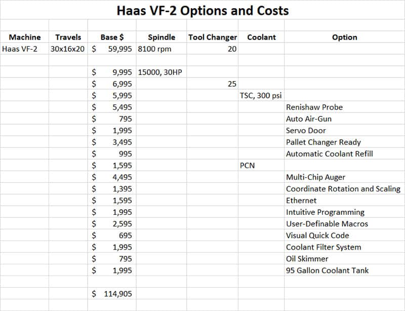

Make a Worksheet for the Fully Optioned Machine
We’ll be using a Haas VF-2 as our example, just because they’re popular machines and Haas makes it easy to determine costs just by accessing their web site.  If you’ve got a price list for some other machine of interest and its options, you’ll be able to apply the same techniques.  What you want to do is make up a worksheet that has the machine and all of the options you are considering.  For this article, I’m going to load it up with options to get to a price of $114,905.  Here’s my worksheet:
HaasVF2Options
As you can see, I’ve loaded in a ton of options for us to analyze.  The machine would clearly be intended for a shop that cuts a lot of software materials as I’ve spec’d a 15,000 rpm spindle.  There were even more options I could’ve considered, but this is plenty to work from!

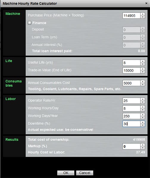

Calculating Your Machine’s Hourly Cost
Our next step is to use G-Wizard Estimator’s Machine Hourly Rate Calculator.  This handy little gizmo takes in all the parameters needed to calculate your machine’s hourly cost.  Here it is with our fully loaded Haas VF-2 plugged in:
HaasVF2Hourly
Hourly rate for our mythical Haas VF2…
I’ve kept the Hourly Rate worksheet very simple.  For example, I did not finance the machine.  You may want different assumptions for things like the machine’s useful life, trade-in value, how much you pay your operator, and so on.  That’s all easy to crank through.  I also did not mark up the hourly rate because we’re interested in understanding cost savings for this exercise.  The bottom line is that given these assumptions, our Haas VF2 costs $37.49 an hour to operate.  Let’s not get too wrapped up in that number, because as I say, you may want to change the assumptions to fit your shop’s practices.  In fact, let’s just round up to $40 so we have a nice round number to work with.

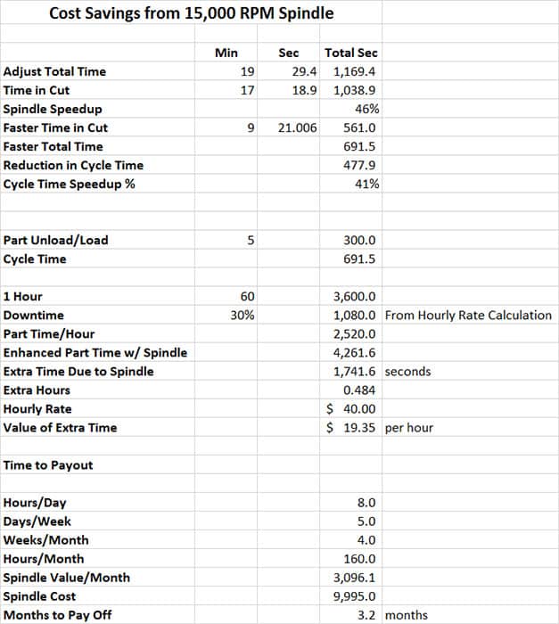

15,000 RPM Spindle Cost Savings
This was an almost $10,000 option, so we want to make sure it’s valuable.  The thing is, as long as we’re cutting materials that are soft enough to run the spindle flat out, and as long as we’re using tooling that can run at those speeds, we can generate savings proportionate to the spindle speedup.  In this case, we have a 46% faster spindle, so all other things being equal, it can spend 46% less time in the cut and still get the job done.  How much time is that, though?  Let’s use G-Wizard Editor to get a quick estimate.  I’m just going to load a part and see what proportion of the overall run time was spent in the cut.
Let’s say our shop typically makes electronics panels.  Here’s a typical part in GW Editor:
PanelEngrave
Electrical Panel…
PanelEngraveInfo
Info on machining the electrical panel…
The GW Editor Info tab tells us what we need to know.  The total acceleration adjusted run time for this part is 19 minutes and 29.4 seconds.  The time spent actually in the cut is 17 minutes and 18.9 seconds.  It is the time spent in cut that the faster spindle can improve upon.  So our Time in Cut will drop down to 9 minutes and 21 seconds.  Nice!
Now we want to translate that to a dollar savings and then figure out how long it takes for the spindle to pay for itself.  I perform this calculation as follows (also shown is the Cycle Time Speedup calculation discussed above):
VF2SpindleCostSavings
Spindle Cost Savings and Payout Time…
At the top, we figure the cycle time speedup.  Then we figure in time to unload/load parts between runs.  After that, we’re figuring on producing this same part continuously and calculating our monthly savings from the new spindle.  We calculate it in terms of its ability to produce more parts per hour.  In that sense, it is worth about $19.35 per hour.  We also have factored in the 30% downtime on the machine because stuff happens.  Tools break.  Work stops for various reasons, and in general, we’re not always perfectly efficient at keeping nose to the grindstone.
All that said, if we can keep this machine busy making parts, our spindle will have paid for itself in less than 4 months.  After 4 months, we get to put the extra $19.35 per hour in our pocket as higher profits (or lower bid prices to gain more jobs).  Taken in that light, it seems like a pretty smart purchase!
