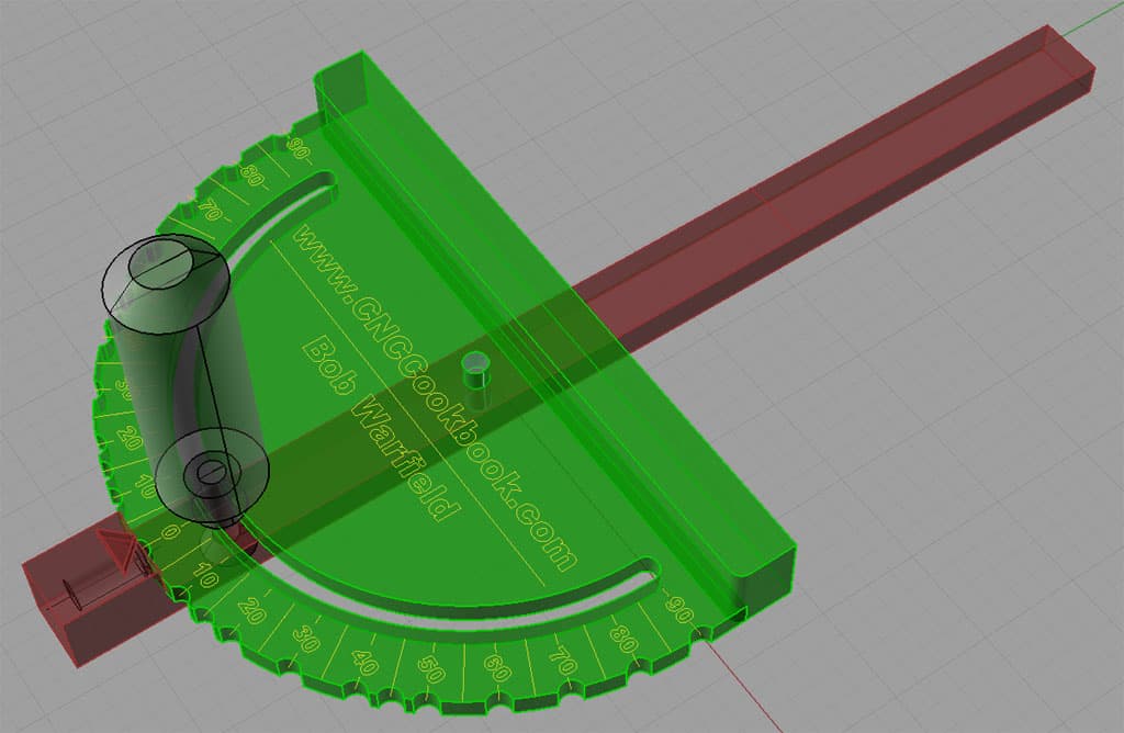

Here is a Rhino3D model of the finished part:
A 3D miter gauge with green body and red handle, featuring precise markings and a circular base.
This miter gage is a straightforward design. Its most interesting feature is a ball detent that makes it easy to set the gage to 10 degree intervals, with extra stops at 15 and 45 degrees. The protractor pivots on a 1/4" dowel pin, and is locked in place by screwing the handle down on a 1/4" flat head cap screw embedded in the crossbar.

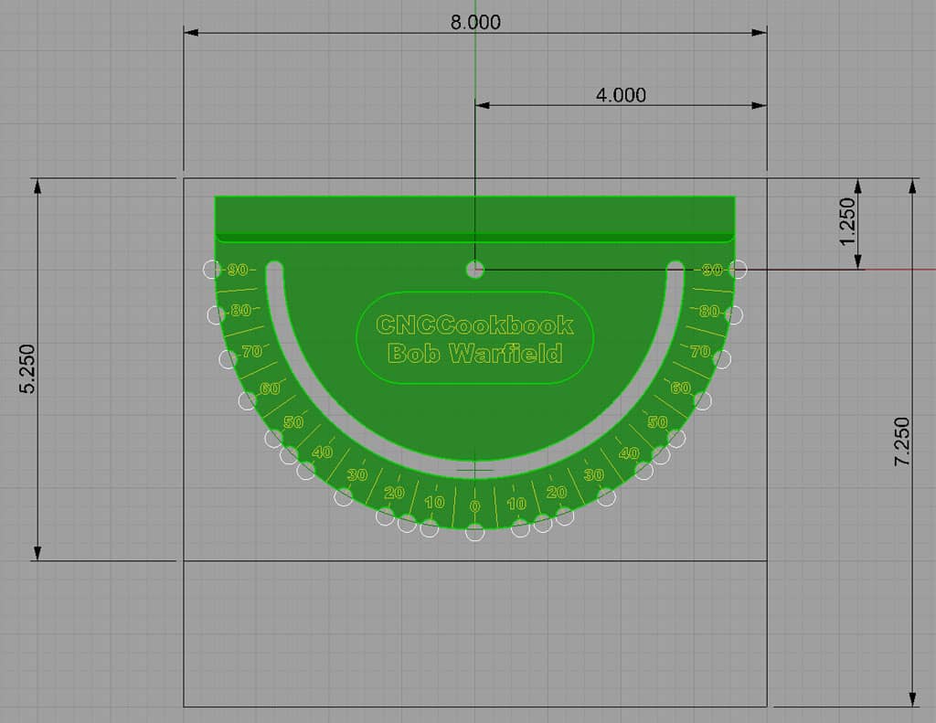

Protractor
Task 1: Cut the stock. The protractor will be machined from a piece of 71/4" wide by 1" thick 6061 aluminum. The overall bounding box for the finished protractor is 7.125" by 4.561" by 0.800". I should start with a block that is sawn to 7.250" x 4.75" x 1".

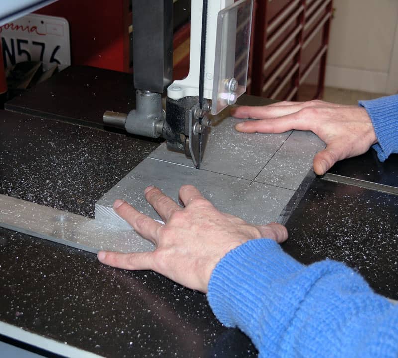

Bandsaw Work to Cut Stock
A green semi-circular object with ruler-like scale, featuring text "CNCCookbook.com" and "Bob Warfield", against a gray background.

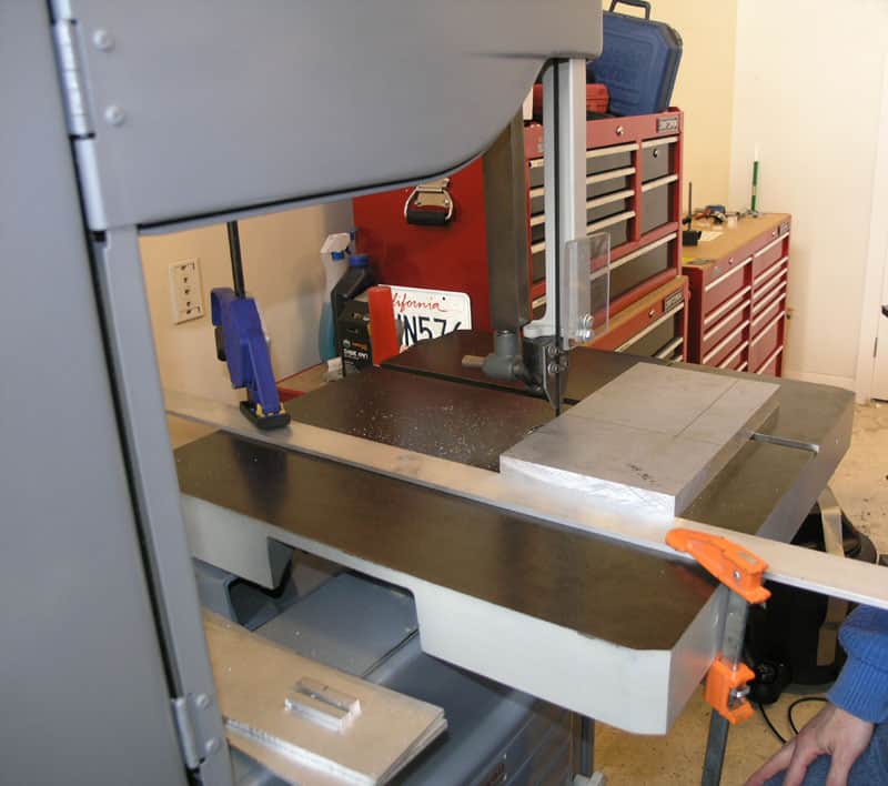

Material is 7 1/2" wide x 1" thick 6061. I'll cut an 8" length and then trim 2" from the edge to leave a piece 8" x 5 1/4" x 1"...
A bandsaw in a workshop setting with various metalworking tools and equipment visible in the background.
A piece of 1" thick 6061 is marked out with Sharpie and waiting on the bandsaw table. A fence has been clamped in place to help guide it...
A person's hands operating a bandsaw on a black table in a workshop cutting through aluminum.
With a new blade on the bandsaw, it's amazing how easily it cuts the aluminum. Very little pressure is needed to move the block quickly through the cut. You almost feel like the block is made of butter!

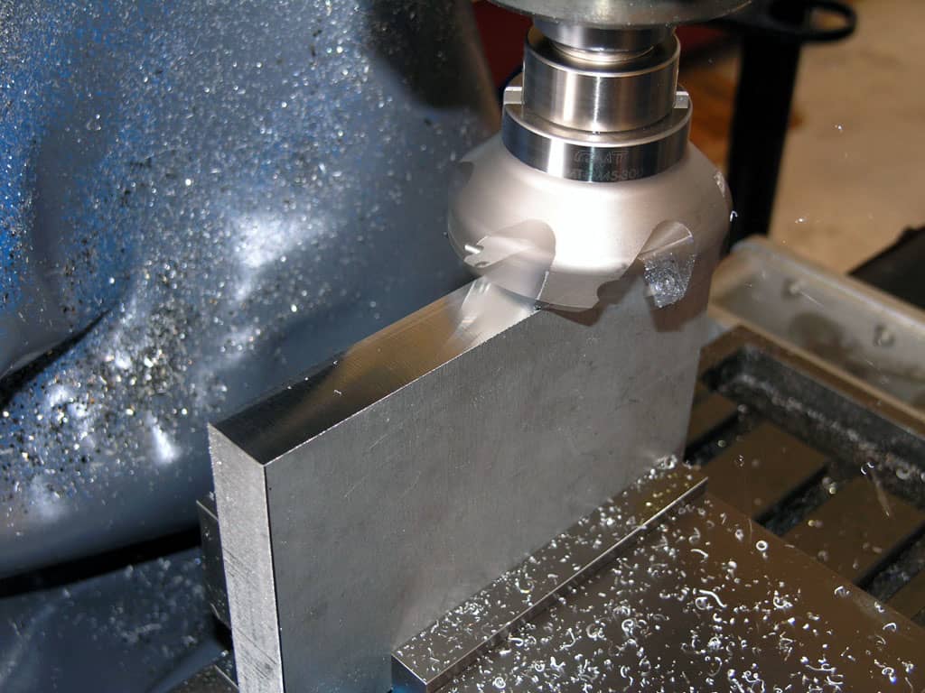

Squaring Stock
We'll square the two long edges. Most of the top face gets milled off, so no need to square it.
Milling machine with rotating cutting tools.
That Glacern 45 degree facemill produces a wonderful finish. I can run it at 90 IPM, but just for grins I made a pass or two at 10 IPM Using the super sharp aluminum inserts, you could see diffraction rainbows and a near mirror finish. This was a very similar finish to what I saw coming off a friend's Fadal with a high dollar individually adjustable insert height face mill and massive flood coolant...

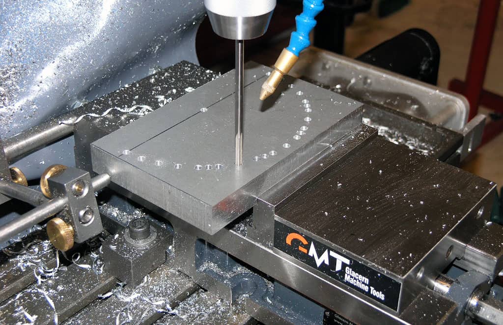

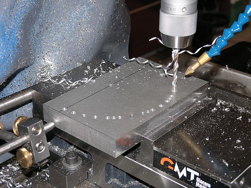

Drill and Ream the Dowel Pin Pivot and Ball Detent Holes
The dowell pin pivot is the 0, 0 datum for all the G-code.
We'll be using a "B" HSS Twist Drill (0.238", which is 0.012" undersized) in screw machine length to drill the hole. Speeds and feeds via G-Wizard:
1600 RPM, 8.9 IPM
The 0.250" Reamer will use 1600 rpm, 15 IPM.
G-code for Twist Drilling
G-code for Reaming
Metalworking machine with precision engineering and robust design.
This peck drilling cycle is the kind of operation where you wonder how you ever got by without CNC. A DRO, at the very least, would be helpful for laying out those holes along the periphery of the miter gage. As it was, my brother and I got to watch the peck drilling cycle while we chatted. Biggest issue is I just don't have the spindle rpms to really break the chips. We stopped once or twice to clear the big stringers that were hanging on.
Metalworking machine in operation with GMT Glacern Machine Tools logo, surrounded by metal shavings and debris.
All holes were reamed...

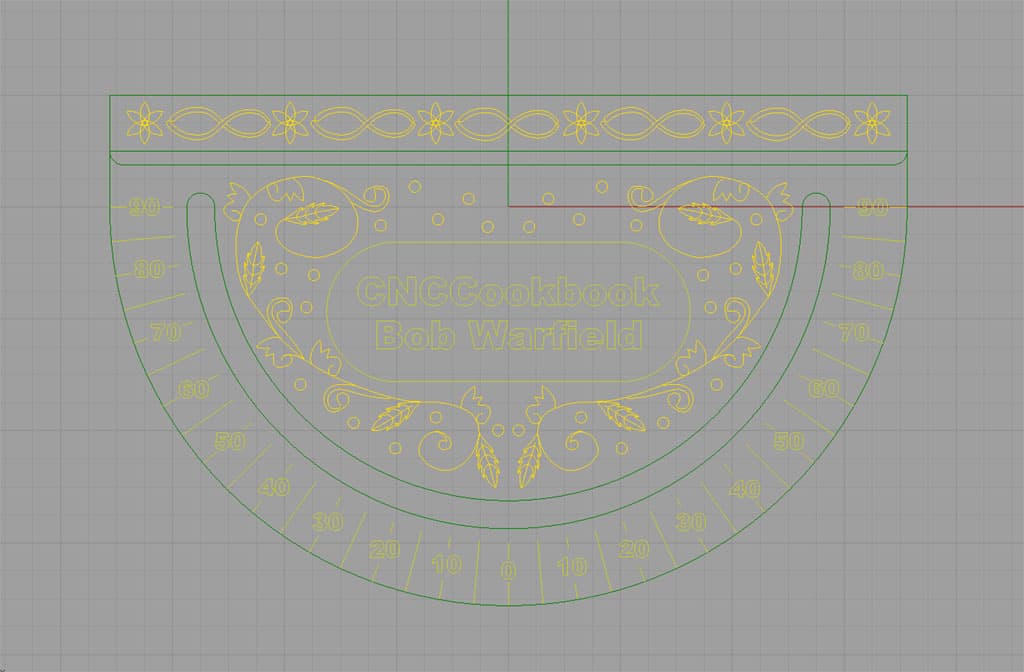

Scrollwork Experiment
Just for the heck of it, and because it is pretty easy to do, I am going to try engraving some scrollwork on the top of the workpiece. It'll all be milled away in the finished gage, so there is no real risk here, just a little time. If I like the result, I will repeat the exercise on the actual miter surfaces that won't be milled away. Here is my artwork, done in the Rhino3D CAD program:
Computer-generated image of intricately designed scrollwork with floral patterns.
I'm going to do the engraving with a 3/16" spot drill, running at 1600 rpm and 3 IPM.

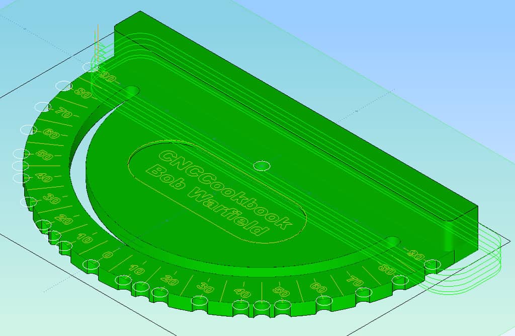

Here is what that roughing toolpath looks like in OneCNC:
Green fence 3D model with curved lines and numbers.

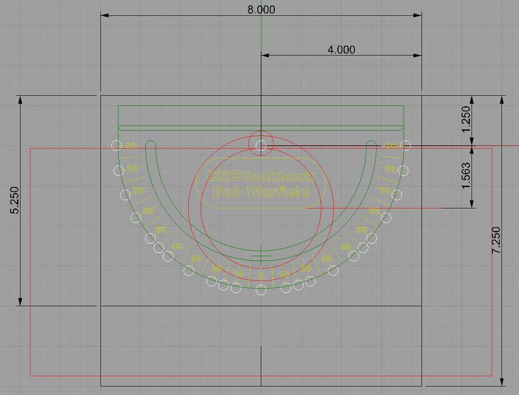

Using my Rhino3D drawing, I overlaid the facemill and the 5/8" Helimill's footprints on the protractor to see what path I needed to put the facemill on:
Facemill clearance chart for machining or manufacturing use.
The red circles represent the 5/8" helimill at top and the 3" facemill (inner big circle is 3", outer is the addition clearance for the 45 degree inserts). The red rectangle is the region to be cleared by the facemill...
The drawing tells us the facemill can come reasonably close while staying within the slot cut by the 5/8" Helimill and leaving clearance for the fence. It takes 2 passes of the facemill at each depth level. I can use a 1" stepover to pick up the lower half. Feeds and speeds for the facemill will be 1229 rpm / 72 IPM. This is with a depth of cut of 0.020", and G-Wizard says I'll be using close to 1 HP. The facemill passes will be 8" long plus overhand, and Y will be -1.563" (the dowel pin is the 0, 0 datum). To generate G-code for this in OneCNC, we simply give it the red bounding rectangle and ask for a facing operation. Starting with Z = 0, I will be stepping down 0.020" per pass.
