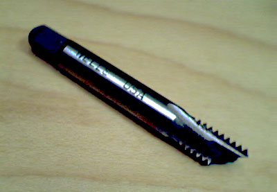

Let’s start with some basics. Tapping requires a coordinated motion in 3 axes: X, Y, and Z. In addition, one of the axes, the one perpendicular to the threads, has to be pretty precisely synchronized to the spindle that’s driving the tap.
That tap wants to move down into the hole at a rate determined by how fast it is rotating versus the thread pitch. If the tap moves down into the hole too slowly, the pull on the threads gets greater and greater as the tap falls behind the place the threads dictate it should be. If it goes down the hole too quickly, it starts to “push” the threads faster than they want to go.
Either way, if the discrepancy in where the tap should be versus where it is becomes too great, the threads will tear or the tap will break. Those are both bad outcomes!
Broken taps are a pain!
There are a number of ways to regulate the speed the tap goes down the hole versus the rate the spindle is turning.

4. Rigid Tapping. With this approach, the tapping holder is rigid, meaning it has no tension/compression play. That means the motion of the spindle and the axis moving down the hole have to be precisely synchronized. Delivering this synchronization is one reason rigid tapping requires a more sophisticated controller. Because these motions are precisely synchronized (at least in theory), the tap holder can be rigid (hence the name).
There are a couple of ways controllers approach rigid tapping. The most common method, used on a majority of controllers, is to let the spindle go, monitor its actual speed with some sort of encoder, and then vary the feedrate of the synchronized axis to mirror the right ratio of spindle rpm to feedrate for the thread being cut. Lately, the smaller machines, especially the “tapping and drilling” centers, use a type of rigid tapping often called “synchronous tapping.” In this method, both the spindle and the axis speeds are dynamically controlled as servos to get the best synchronized result. This is only possible on machines whose spindles have low enough mass and intertia that their rotation can be dynamically modified quickly enough, hence the use on relatively smaller machines.
Synchronous tapping can be done even faster than ordinary rigid tapping because there will be no overshoot of the spindle. With a heavier spindle there will always be a little overshoot. Smarter controls try to slow the spindle down as the bottom of the hole approaches, but that’s a bandaid relative to true synchronization. In addition, true synchronous tapping will experience less acceleration/deceleration related wear in the reversal at the bottom of the hole, so tap life can be better.
