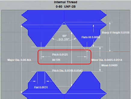

Thread pitch portrayed in G-Wizard Thread Calculator…
Thread pitch is the distance between adjacent threads of a screw or bolt, measured in millimeters or inches. It is an essential factor that determines the compatibility of the screw or bolt with a threaded hole, such as a nut or tapped hole. As simple as it may sound, understanding the concept of thread pitch is crucial for anyone working with threaded components, as it can make or break the success of an assembly.
Two key factors to consider when discussing thread pitch are metric vs. inch thread pitches and external vs. internal threads. These factors play a vital role in defining the thread pitch and ensuring the correct fit between components.

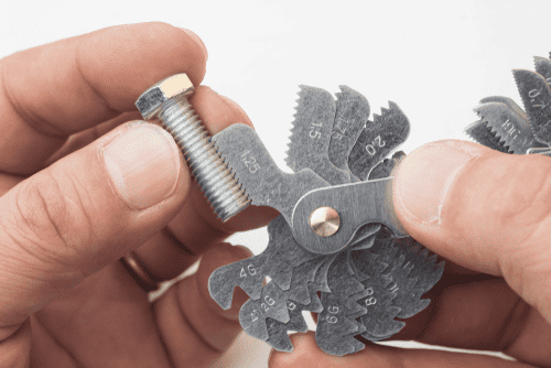

Measuring Thread Pitch using a Thread Pitch Gauge…
Accurately measuring thread pitch is crucial for ensuring compatibility between components and a secure connection. There are two common methods used to measure thread pitch: using a ruler or caliper and utilizing a thread pitch gauge. Each method has its advantages and disadvantages, but both can provide a reasonable approximation of the thread pitch when executed correctly.
In the following subsections, we will discuss each method in detail, providing you with the necessary knowledge to measure thread pitch accurately and confidently.
Using a Ruler or Caliper
Measuring thread pitch using a ruler or caliper involves determining the distance between adjacent thread peaks or valleys. While a ruler can give you a rough idea of the thread pitch, using a high-precision ruler or caliper is recommended for more accurate results. To measure the thread pitch with a caliper, simply measure the distance between two crests of a thread.
Keep in mind that using a ruler or caliper may not provide the most precise measurement, as it is prone to human error. However, this method can still give you a reasonable approximation of the thread pitch, which can be useful for quick assessments or when a more specialized tool isn’t available.
Utilizing a Thread Pitch Gauge
A thread pitch gauge is a specialized tool designed to measure thread pitch by comparing toothed shims to the thread. To use a thread pitch gauge, select the nearest pitch gauge blade and ensure that the teeth are securely engaged with the threads. This method provides a more accurate and reliable measurement compared to using a ruler or caliper.
However, it’s important to note that thread pitch gauges may not be suitable for all situations, such as when working with internal threads or when access to the threads is limited. In these cases, alternative methods, like using a ruler or caliper, may be more appropriate.

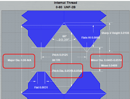

Major, Diameter, Pitch Diameter, and Minor Diameter as portrayed by G-Wizard Thread Calculator…
In addition to understanding thread pitch and its significance, it’s essential to familiarize yourself with thread characteristics and terminology. This knowledge will help you accurately measure and calculate thread pitch, ensuring a proper fit between components and a secure connection.
In the following subsections, we will discuss three critical thread characteristics and their importance: major diameter, minor diameter, and pitch diameter.
Major Diameter
The major diameter, also known as the basic outside diameter, is the largest diameter of a screw thread, measured at a perpendicular angle to the thread axis. The major diameter plays a vital role in determining the size of the thread, as well as the amount of force that can be applied to it, all while maintaining the same point of reference.
To accurately determine the major diameter, you can use a ruler or a caliper. Measuring the major diameter is crucial for ensuring that the threaded components will fit together properly and can withstand the required load for your application.
Minor Diameter
The minor diameter, often referred to as the root or core diameter, is the smallest diameter of a screw thread when measured perpendicular to the thread axis. This diameter represents the base of the thread, which is crucial in determining the strength of the connection between components.
The minor diameter can be measured using a depth micrometer or an optical comparator. Ensuring an accurate measurement of the minor diameter helps guarantee a secure connection and prevents potential failure due to inadequate thread engagement.
Pitch Diameter
The pitch diameter is a hypothetical diameter at which the widths of the threads and the grooves are equal. It is used to determine if two threaded components can be effectively joined together. Accurate measurement of the pitch diameter is essential for ensuring compatibility between components and a secure connection.
Pitch diameter can be measured using a ruler, caliper, or thread pitch gauge. By accurately determining the pitch diameter, you can ensure that your threaded components will fit together properly and provide a strong, reliable connection.
