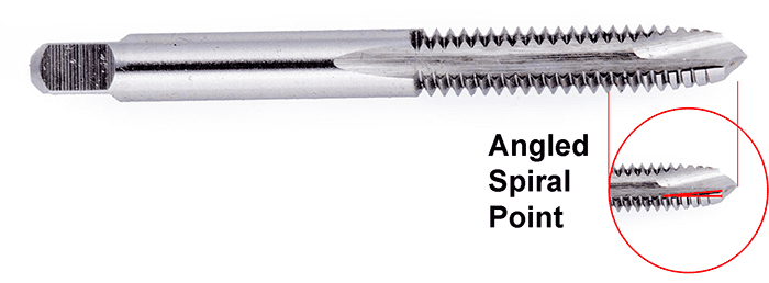

Spiral Point Taps (Gun Nose or Bull Nose Taps)
These thread taps have a spiral cut with relief grooves. They’re common and look like most of the hand taps you’ll see around. But, the spiral angle on the front cutting edges helps eject the chips and the angled edge also gives superior cutting performance. Hence, they’re really the least expensive thread tap you might consider using for power tapping, and can be run at slightly higher speeds than hand taps.
Like hand taps, sprial point taps can be had as a taper tap has a tapered end, or a plug tap (intended for blind holes) has much less taper.
They’re cheaper than the other two types, but I typically prefer the other two. The primary disadvantage of these is they push the chips ahead of the tap–down into the hole in other words. This is not a big deal for through holes, but is a bad idea for blind holes.

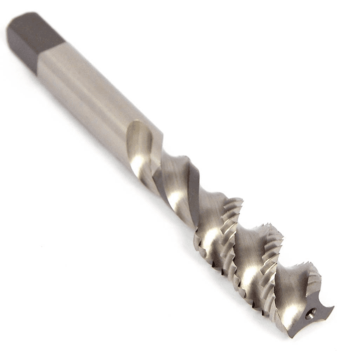

Spiral Flute Taps or Gun Taps
Spiral Flute Taps have an open spiral just like an endmill. Their primary advantage is they eject chips up and out of the hole. They’re always preferable over spiral point taps when you have a blind hole.
They’re also preferable for an interrupted hole where another feature intersects because the spiral helps restart the threading past the open feature.
Sometime, take a spiral flute tap and a regular hand tap and tap a couple of identical holes by hand. You’ll be shocked at how much less effort the spiral flute tap requires. Choosing the right types of taps really helps!

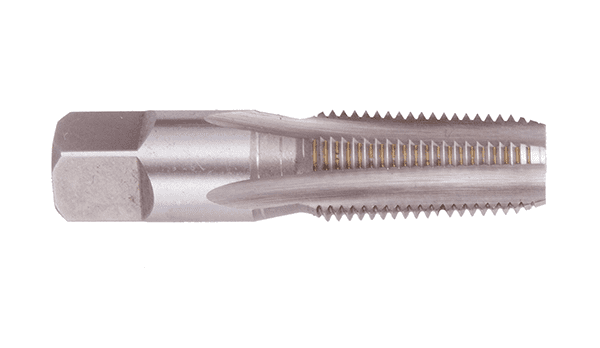

Types of Taps for Tapered Threads: Pipe Taps
As you might expect, Pipe Taps are the types of thread taps used for tapping pipe threads. There are both straight and tapered pipe taps depending on whether the pipe thread is intended to be straight or tapered. The photo shows a typical NPT Thread Pipe Tap. You can see the taper of the NPT thread profile.
Taps for tapered pipe threads have to work harder because you can’t drill a tapered hole. There’s quite a lot more material they must remove at top of hole than bottom. Use a pipe taper reamer to taper the hole so the tap doesn’t work so hard.

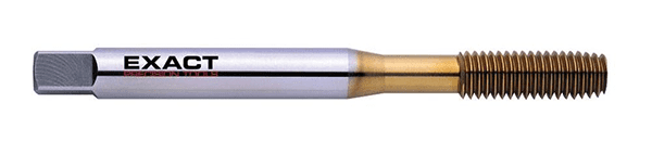

Form or Roll Taps (Thread Forming Taps)
Thread Forming taps don’t cut threads at all. Instead they cold form. Threads made this way are often called “rolled” threads.
With this process, the metal is pushed out of the way and compressed into position rather than being cut. There are no chips to remove. As a result, the taps themselves are less likely to break and the threads they make are stronger. If your application allows Form Taps, they are generally the best thing going for those reasons.
Form Taps do require different feeds and speeds and they require a different starting hole size, so be aware of that before using one.
While many believe they’re only good for soft materials like aluminum, they can actually be used on materials up to a hardness of 36 HRC, which is about 340 BHN. That covers a surprisingly wide range of materials including a lot of steels.
I will almost always choose a Form Tap over a Cutting Tap out of the available types of taps if the material isn’t too hard for thread forming.
Kelly offers this tip for form taps:
“One minor hiccup with quite a few of the roll forming taps…unless they have a groove to allow cutting oil to escape, or there is no room at the root or crest of the thread, the oil will build up back pressure as the tap goes in, and eventually act like solid metal plug blocking further entry of the tap into the hole. I figured this out the hard way after breaking a few taps.”

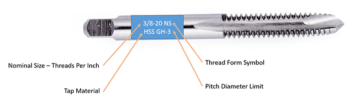

Standard Tap Markings
Taps are marked on the shank so you can tell at a glance what kind of thread tap you’re dealing with. The markings typically will include:
- Nominal Size: This is the description of the thread size that tap will make.
- Thread Form Symbol: This describes the thread family.
- Tap Material: Usually Carbide or HSS
- Pitch Diameter LImit: Tells what tolerance thread will be made.
