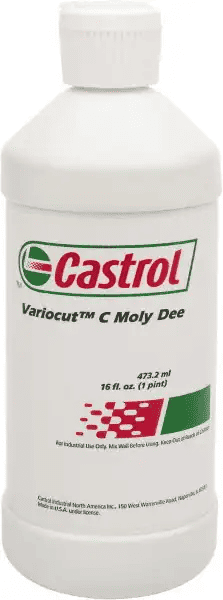

Lubrication and Cutting Oils
Lubrication and cutting oils play a crucial role in minimizing friction and heat generation during tapping operations. Proper lubrication can significantly extend the life of your tap, ensuring smooth and efficient threading.
For optimal tap performance, it is typically recommended to use straight cutting oil. For non-ferrous and non-metallic materials, a coolant or cutting fluid (light oil or soluble oil) is suggested. Additionally, for cold forming taps, a cutting oil or lubricant is preferable to a coolant. Ensuring proper lubrication is essential for successful tapping operations.
