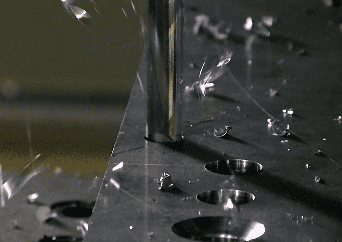

Reaming is a process that focuses on refining the interior walls of an existing hole, such as those created by a drill bit. It aims to generate even walls with a highly accurate and smooth surface finish using rotary cutting tools called reamers. On the other hand, boring is a metal-cutting operation. It enlarges an existing hole diameter using a single-point cutting tool or boring head. In both cases, the actual cutting tool is called a Boring Bar. Both processes involve material removal, but they differ in terms of the cutting tools used and the quality outcomes they produce.
Reaming Explained
Reaming is a cutting process that utilizes a rotary cutting tool. It creates smooth interior walls in an existing hole of a workpiece. The primary objective of reaming is to refine and smooth out the inner surface of already drilled holes by removing any irregularities and improving the hole’s dimensional accuracy. Reamers, the cutting tools used in reaming, are multi-point cutting tools that evenly remove material from the hole’s interior walls, resulting in a high-quality surface finish.
Reaming is often performed after other machining operations, such as drilling or boring, to finish the inner surface of the hole. It is a versatile process that can be carried out using a milling machine or drill press, depending on the specific requirements of the application. The material removal rate of reamers is significantly lower than that of drill bits, making reaming more suitable for refining existing holes rather than creating new ones.

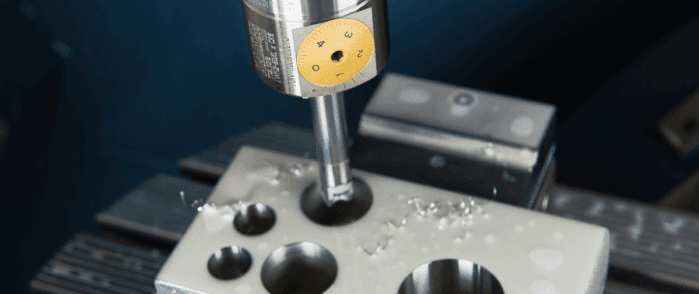

Boring is a metal cutting process that involves the enlargement of an existing hole diameter. It is done using either a single-point cutting tool or a boring tool. Boring tools, also known as boring bars, are used to remove material from the existing hole to create a larger, more precise hole diameter. This process is typically employed to create holes that cannot be achieved with standard drilling methods, such as those with a high length-to-diameter ratio or a specific surface finish requirement.
Machines such as drilling, lathe, and milling machines can be used to perform tedious operations. They are helpful when performing repetitive tasks. The single-point cutting tool used in boring is less efficient as it takes more time for machining and a rough surface finish is acquired. However, the accuracy level of this tool is very high.
The boring hole process is a versatile technique that can be applied to various materials and applications, such as engine cylinders, hydraulic cylinders, and other components requiring precise hole enlargement.

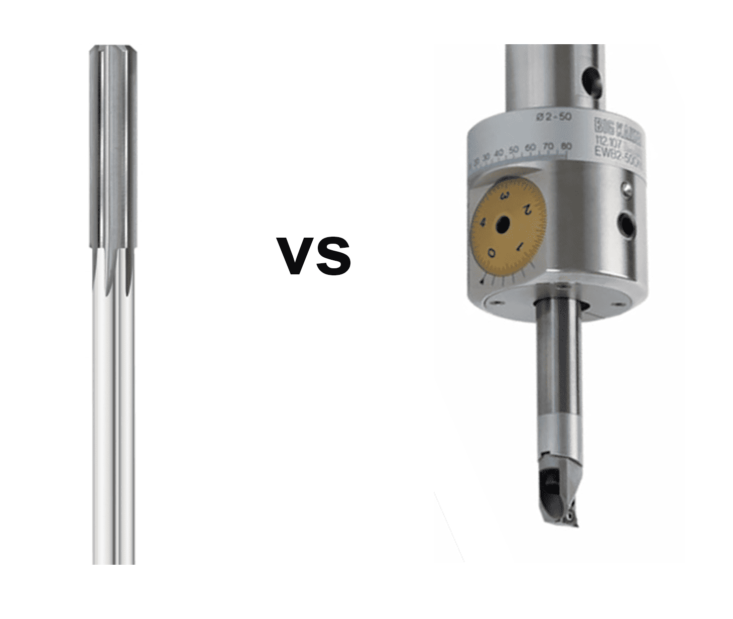

Cutting Tool Characteristics
The cutting tools used in reaming and boring operations are different in terms of design and function. Reaming employs a multi-point cutting tool called a reamer, which is used to refine and smooth the interior walls of an existing hole. Reamers have multiple cutting edges that evenly remove material from the hole’s interior walls, resulting in a high-quality surface finish.
On the other hand, boring utilizes a single-point cutting tool, also known as a boring head. This is used to enlarge an already existing hole. Boring tools have only one cutting edge that removes material from the existing hole to create a larger, more precise hole diameter. A single-point cutting tool is commonly used in boring. This typically results in lower material removal rate, longer machining time, and a rougher surface finish than other methods; however, it does offer high accuracy.
