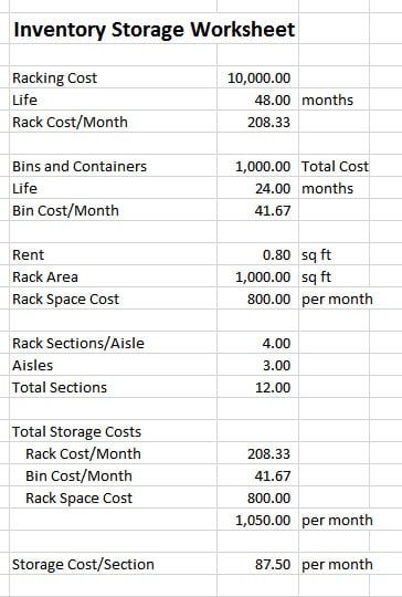

A simple spreadsheet can help you bake in some quick inventory cost estimates for your Job Quotes. For example, here is a worksheet around storage costs:
Simple Storage Space Cost worksheet…
It covers the basics of racking, storage containers, and rent in a manner similar to the way we did the machine hourly cost calculator for our CADCAM Estimator software. It’s pretty simple, and gives you a month cost that you can apply across jobs to get those costs assigned to your jobs and understand how they’re affecting a job’s profitability. The idea would be to estimate how many rack sections a job would use and for how long and then charge that back at the monthly cost of a section. You could do another worksheet to assign your material handling costs:
