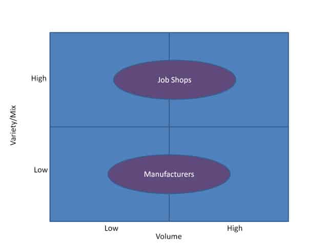

Let's leave aside the issue of size for a minute, because there are very large organizations doing job shop work and there are very small organizations making the same parts in quantity day in and day out. What really sets these various shops apart is volume versus variety. Let's look at it as quadrants on a grid:
It's really all about whether we're emphasizing the Mix (making a wide variety of different parts) or the Volume (making the same part for long periods). If we make the same part long enough, we can really get that whole process dialed in and optimized. We can keep running Kaizen Events and coming up with new ideas to make our part with higher quality, faster, or more cheaply. But as a Job Shop, we're dealing with such a wide variety of parts that change so often and are manufactured in relatively brief spurts that it is much harder. If we focus on optimizing some single part, we may be all done making it forever before we've been able to improve the process very much.
