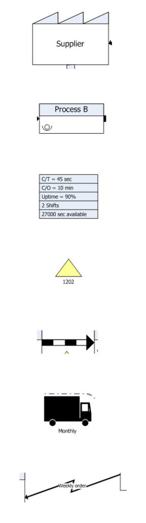

Standard Graphics
On the right are some of the standard graphical symbols taken from the diagram above:
– Customer/Supplier Icon
– Dedicated Process Icon: A process, operation, machine or department through which material flows.
– Data Box Icon: Collects the important data required for analyzing the system.
– Inventory: Shows the inventory level between two processes.
– Push Arrow: Represents the “pushing” of material from one process to the next.
– External Shipment Icon: Represents external transport logistics either from suppliers or to customers.
– Information Flow: This one has the jaggie that depicts electronic information flow. A straight arrow reflects manual information flow.
