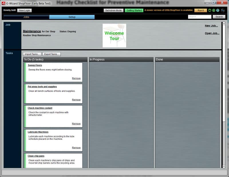

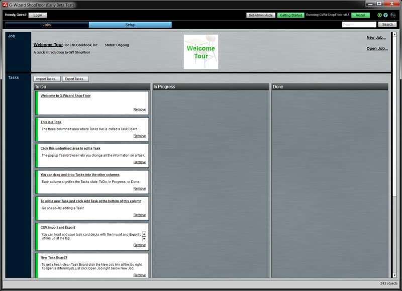

Kanban can even be done electronically. Here is a bit of Kanban software we’re working on at CNCCookbook for our future G-Wizard ShopFloor product:
Kanban Software (GW ShopFloor) showing routine shop maintenance tasks…
As you can see, the Kanban board becomes a sort of visual scheduling and task management tool. Think of it as a two-dimensional ToDo list where you can see what the status of every task is and communicate changes in status by dragging the cards into new columns. Good Kanban software makes it possible to customize the board layout, change the columns, customize the cards, and do all sorts of other things to make the tool better suited to various tasks. Once you go electronic, the potential control and convenience goes up exponentially.
We’ll have a lot more to say about these electronic Kanban boards over time as they’re one of the centerpiece functions of G-Wizard ShopFloor.
