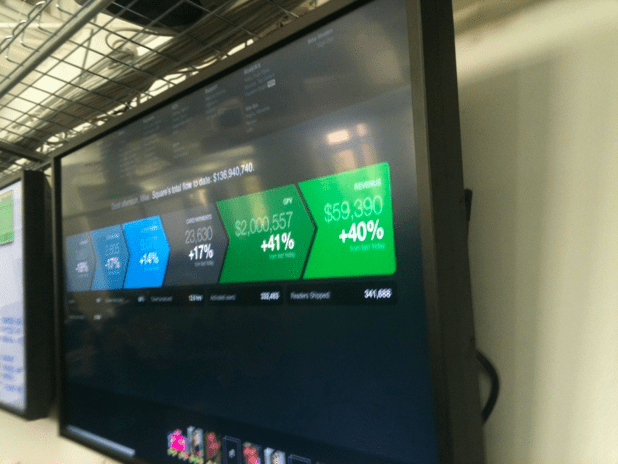

Various kinds of scoreboards can be used for Process Metrics.  One trick seen often in Silicon Valley is to set up a home theater-style projector to display live data being generated by software.  The information is projected in some prominent place, such as the entrance to the break room, where people can see it as they walk by.  Here’s one such from a Silicon Valley firm:
square_dash
The nice thing about projectors and screens is they’re software driven so they can be flexible and even switch back and forth to show multiple displays.  The area where this sort of information is located is often called the “Information Center” in Lean parlance.

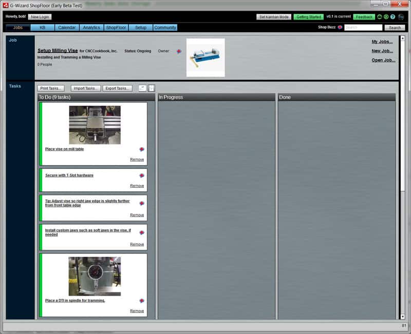

Having the steps needed for a particular process display as a sign or handy laminated checklist would be another good example of the Visual Factory.  There are even sophisticated systems that can do this using software.  For example, the Kanban-based system in G-Wizard ShopFloor does this.
MillingViseJob
Consider adding photographs to your process steps, just like the GW ShopFloor Kanban system shows.  For Job Shops, your Setup Sheets are your Process Steps, so add photographs to make them as visual as possible.

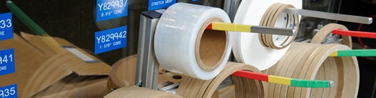

One could imagine all sorts of visual indicators like this for preventative maintenace and similar purposes.  Get a timer with a suitable timespan and hook it up to a colored light.  Now you’ve got a reminder of when it’s time to check the coolant on a machine or perform some other periodic task.  How about this nifty visual system to tell when it’s time to order more tape:
TapeQuantity
