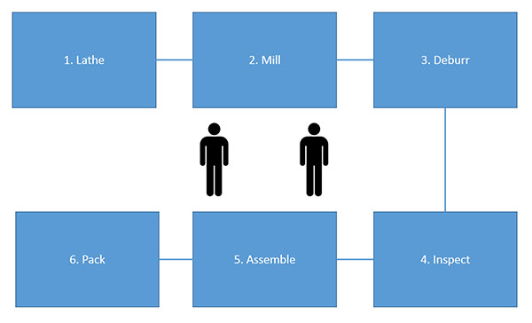

Given those basic inputs, we’re ready to tackle the physical layout of a Cell. Some Best Practices for physical layout:
– Cells are often U-Shaped so the beginning and end of a manufacturing process are near one another. This makes re-balancing and reassignment of tasks easy because workers are near every part of the Cell and can quickly move across the aisle.
