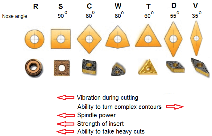

Nose Angle
Nose Angle is largely a function of the insert's shape.  Larger Nose Angles result in stronger inserts.  Select the largest possible Nose Angle to maximize strength.  You need to ensure that the Nose Angle will clear all the features of the part you are machining.
Turning Inserts Nose Angles Visual Guide
Turning Insert Nose Angles, courtesy of CADEM...
