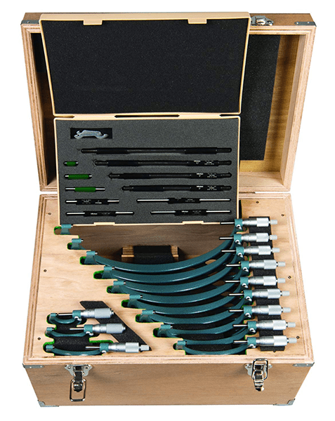

Micrometer Sets & Size Ranges
Micrometers work using a precision screw that moves the anvils together or apart.  As such they have a fairly limited range of measurements they can take.  It's common to have boxed Micrometer Sets so that you can take micrometer readings for a wide range of sizes.
Wooden box containing precision measuring tools, calipers, and micrometers.
Mitutoyo Vernier Micrometer Set, Sizes 0-12"
Pictured is a set of Mitutoyo Vernier Micrometers with a combined range from 0-12".  A set like this one is quite expensive-$2141.70 on Amazon as I write this.
On the other hand, a somewhat lesser brand like Fowler offers a set from 0-6" of Vernier Micrometers for just $311.46.  For just a little more, you can even get a 0-6" set of Digital Micrometers.  Available on Amazon from iGaging for $395.00.

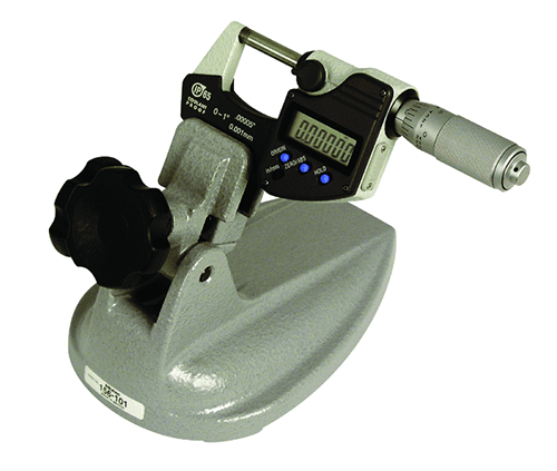

Micrometer Stand
Digital micrometer with Mitutoyo branding, digital display, black body, silver handle, and blue buttons on a white background.
A Micrometer Stand can lead to more accurate measurement.  It avoids transfering your body heat to the Micrometer, and makes it easier to take a measurement without juggling.

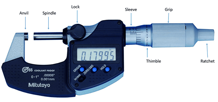

We saw above how to read a Vernier Micrometer.  Aside from that skill, the two key things about using a micrometer are keeping the object you're measuring parallel to the anvils and applying even consistent force to the micrometer when  you take the measurement.
Just like Calipers, you can force the measurement by applying too much torque to the micrometer.  One way to ensure consistent measurements is to get a Ratchet Thimple.  This is a little built-in torque wrench.  Turn the little ratchet handle that sticks out of the main handle until it clicks a few times and you'll be taking your measurement with the same torque every time.

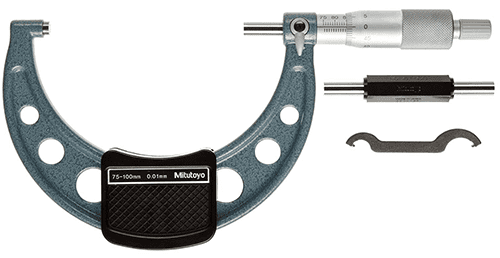

Larger micrometers come with Micrometer Standards.  These are precision rods that are great for zeroing on the shop floor.  They're not recommended for actual calibration because they're not accurate enough.
Pictures are worth a thousand words, so here is a great video from Mitutoyo on calibrating your micrometers:
Most micrometers include a small spanner wrench that can be used to set the device to zero if it isn't reading zero when fully closed (perhaps on a standard for larger mics)

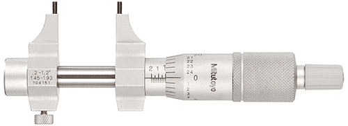

Just as calipers can be used to measure inside dimensions, you can purchase micrometers set up for it.  They're called inside micrometers:
Precision measuring tool with engraved markings.
Mitutoyo 0.2-1.2" Inside Micrometer, Caliper-style.  About $216.95 on Amazon.
The two little tips sticking up are round.

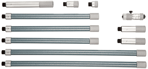

The one pictured is the "Caliper-Style."  You can also get Tubular Inside Micrometers.
Cylindrical objects with rounded ends.
Tubular Inside Micrometers are less commonly seen, but handy for larger openings.

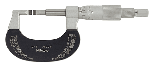

Blade Micrometer
A vernier caliper with stainless steel body and graduated markings for precise measurements.
Blade Micrometers can be used to measure the outside dimensions of grooves.

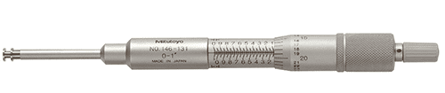

Groove Micrometer
Precision measuring instrument with slender shaft and pointed tip.
Here's an odd beast, but where there's a tolerance there will be a corresponding measuring device.  The Groove Micrometer uses concentric rods that have discs affixed.  Put one disc in each groove or perhaps one in a groove and one in an outside edge or face and you can measure how far apart they are with great precision.

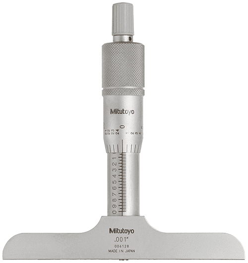

Micrometer Depth Gage
Precision tool with silver metal body, Mitutoyo logo, textured cylindrical section, flat base, and measuring scale.
We saw in the section on Calipers how they have a depth gage feature.  It should come as no surprise that when there's a need for more accurate depth readings, there is a micrometer to the rescue: introducing the Micrometer Depth Gage.
