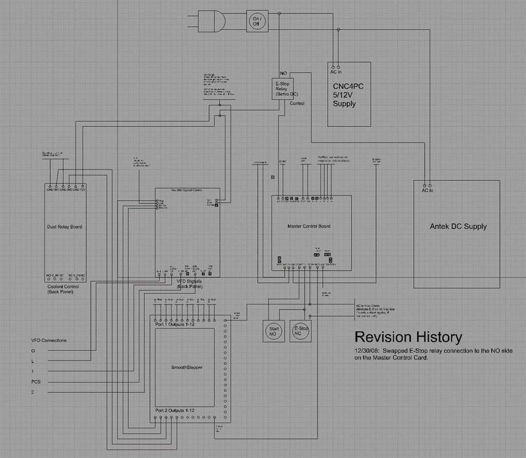

Overall Scematic
Here is the overall schematic for the enclosure:
Preliminary, and for informational use only. Do not use as a plan for your CNC machine!
For clarity, I have not specified the wiring to the axis modules. Each axis module requires servo DC and ground from the DC supply and Geckodrive step/dir signals from the Smoothstepper.
Some points to call out on this schematic:
– The details for how the VFD and spindle control is achieved may be found on the VFD page.
– The E-stop functionality is handled by the master control board. An E-stop condition is triggered by a manual E-stop switch, a charge pump failure (i.e. the PC is no longer communicating with the system), or a servo fault as signalled to the Master Control Board by the Geckodrive. When an E-stop is generated, the normally closed VCC supply access (+12VDC) is shut off. This causes the main AC supply relay to open, and the 12VDC supply to the spindle control and coolant relay boards to be shut off. The AC supply relay supplies AC to the DC Servo Power supply.
– There are 3 front panel controls: On/Off, which physically interrupts the main AC relay. E-stop (the other is mounted on the mill itself) which will shut the system down if pressed. And lastly, a Start button that is used to tell the Master Control Board to turn off the E-stop condition and make the spindle, coolant, and DC servo supply available for operation.

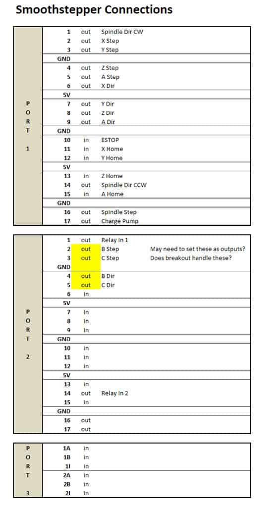

Smoothstepper Pinout
Here is how I’ll be using the I/O pins on the Smoothstepper ports:
The yellow shading on Port 2 pins 2-5 indicates some confusion on my part. The Smoothstepper at this stage is not very well documented, and there seems to be no doc at all on my CNC4PC breakout board that the Smoothstepper plugs into. My desire is to use those 4 pins as step/dir outputs to control the remaining 2 axes, but I am not sure exactly how to make this work. Either the breakout board won’t handle it at all, in which case I won’t have enough outputs to run 2 more axes, or more likely I have to access some setup utility to decide which way these bi-directional parallel pins are to be used (as inputs or outputs). Needing a B and C axis is somewhere out in the future, so I’m not going to worry about it while doing the initial conversion. I expect to use them to control a toolchanger rather than to actually try to run a 5th or 6th axis as well.

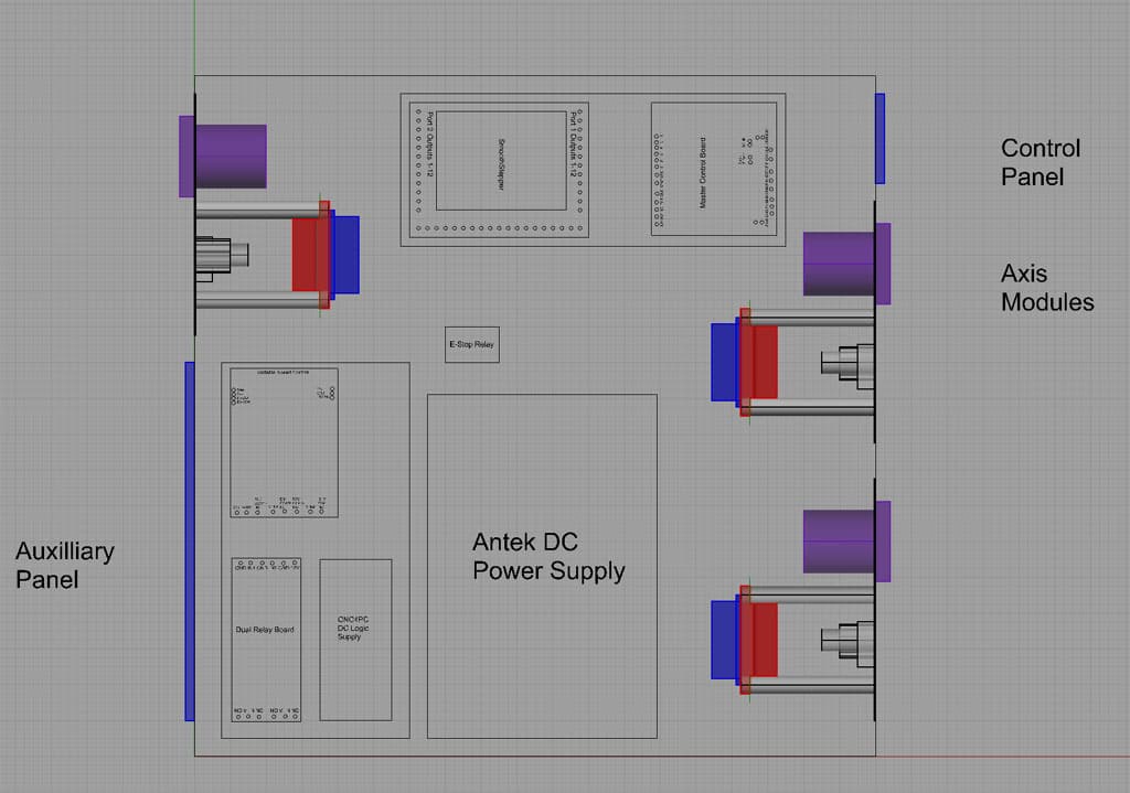

Enclosure Board Layout
Based on the schematic above, one can get an idea of what the wiring paths will look like. Here is a schematic of the mounting positions for the various sub-boards inside the enclosure:
