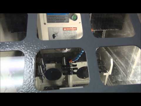

This is Dave De Caussin’s Mill: A Baby Fadal
Dave was one of the Founders of Fadal and he is back with a new little milling machine and a new company: Fadec Engineering. Here is his UMC-10:
It’s fascinating to compare these two mills. The ‘Trak packs more work envelope into a much smaller footprint.
Likes:
– Dave designed it.
– At $22K, I bet it’s a lot cheaper than the Prototrak. Online boards put the Trak 2Op in the low 30’s price range.
– 3 HP 6500 rpm spindle. Faster than the ‘Trak, same HP.
– 8 station toolchanger, just like the Trak. Interesting how the Trak’s works in the video. That accounts for some of the Footprint efficiency, I expect.
Dislikes:
– Work envelope smaller than Trak at 14″ x 8″ x 8.5″–quite a bit more Y and Z on the Trak.
– Proprietary taper and toolholders based on a radical modification of the R8. The BT30 holders used by the Trak are beefier and easily obtained from many sources.

anyone know the max rapid speeds on the UMC-10?
I could not find it in the specs, but at least it is servo driven.
But the non-standard tool holders makes me want to stay away from it anyway.
Thank you for the feature of the UMC10 Bob!
The max rapid speeds are 500 inches per minute.
The R8 tool holders are proprietary, but we keep a lot of them in stock.
