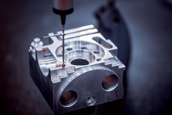

Probes are normally positioned in 3 dimensions–X, Y, and Z.  However, more sophisticated machines can also allow the probes angle to be changed allowing measurement in places the probe wouldn’t otherwise be able to reach.  Rotary tables may also be used to improve approach-ability of various features.
CMM’s are often made of granite and aluminum, and they use air bearings
The probe is the sensor that determines where the surface of the part is when a measurement is made.

Coordinate Measurement Machines are used in roughly three general ways:
  • Quality Control Departments:  Here’s they’re typically kept in climate-controlled clean rooms to maximize their precision.
  • Shop Floor:  Here CMM’s are down among the CNC Machines to make it easy to perform inspections as part of a manufacturing cell with minimum travel between the CMM and the machine where parts are being machined.  This allows measurements to be made earlier and potentially more often which leads to savings as errors are identified sooner.
  • Portable:  Portable CMM’s are easy to move around.  They may be used on a Shop Floor or even taking to a site remote from the manufacturing facility to measure parts in the field.
