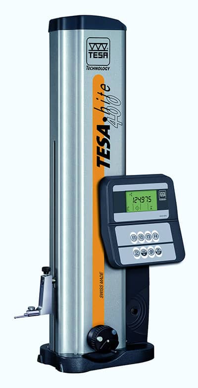

I get a lot of use out of my granite surface plate, height gage, and various accessories. For a long time, I have wanted to upgrade my existing Mitutoyo Height Gage to one of the fancier motorized height gages, such as this one from Tesa:
Tesa Digital Height Gage…
A variety of companies make these, and they come up from time to time at quasi-reasonable prices on eBay–several thousand dollars. It would be an expensive luxury, but it would take my measuring capabilities to the next step.
