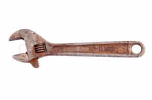

rust protection BreakFree rust preventive oilIt’s a real heart breaker to pull out a tool you haven’t looked at in a while and discover it has rust. Nasty stuff. I live within sight of the ocean, so my shop is particularly susceptible.  That’s made me a believer in rust protection.  Once rust sets in, we can clean it, but better if you never give it a toe hold.

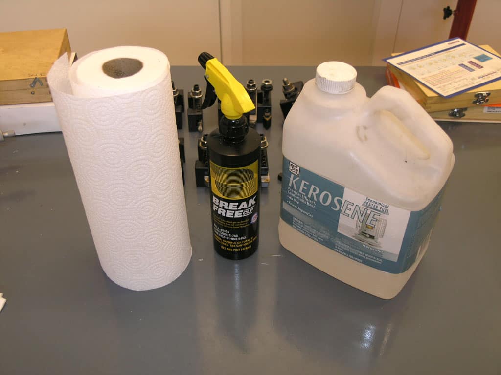

Once the items are logged into the spreadsheet, the next step is cleaning and rust protection. I clean any cosmolene (or other gummy residue) off with kerosene or brake cleaner, depending on how tough the residue is.  BTW, WD-40 will also clean the stuff off since it is mostly kerosene with a little light oil.
That makes the tools shinier, but it also exposes them to potential rust. So I immediately wipe them down with a rust preventive oil. As mentioned, I like a product called “Break-Free”, which is used by the US military and others as a firearm rust preventive oil.  It passes the military’s uber-tough PD-48 specification for rust protection.
Break-free is available as an aerosol, but I prefer the pump bottle as is shown.  I’ve taken to using the pump style with WD-40 too–I still use WD-40 for lots of things, just not as a rust preventive oil.  You can order a bottle of Break-Free from Amazon for a little over $20.
I live on Monterey Bay, and there’s often a sea breeze.  The breeze is nice, but it’s full of moisture and salt.  Having a good rust preventive oil like Break-Free helps me sleep better.  I’ve never noticed any rust on my tools because of my proactive approach to rust protection.
On tools I use a lot, I may give them an extra wipe down before they go back in the tool box once a year or so.  After a good wipe down with kerosene followed by some Break-Free rust preventive oil and the tools are ready for use!
