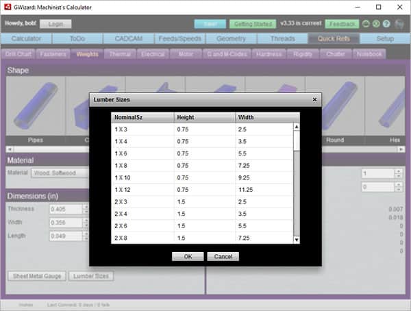

Access Lumber Sizes More Conveniently With a Special Calculator
We’ll present all the lumber size data in tabular form below, but before we do that, we wanted you to know about our G-Wizard CNC Calculator. This inexpensive software has built-in lumber size information that’s extremely easy to use:
Lumber Sizes in the G-Wizard Machinist’s Calculator…
It’s accessed by clicking the “Lumber Sizes” button from within our standard Weights Calculator…
