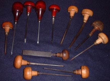

Engraving is the art of carving a design into a hard surface.  Typically its done by hand, using an assortment of hand engraving tools:
Graver tools with wooden handles and metal tips on a gray background.
Image via Wikipedia
This is a laborious and difficult to learn process.  Fortunately, CNC machines are capable of very sophisticated engraving.

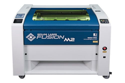

Laser Engravers and Machines
Gray and blue EpiLog Laser Fusion M2 machine with glass window and control panel.
Image courtesy of Epilog Laser...
Lasers can be used to engrave in two ways.  First, if the laser engraver is powerful enough, it can cut the material.  Second, even if it isn't powerful enough to cut the material, it can discolor it in a visually distinctive way using a process called Laser Marking.
In many ways, laser engravers can be simpler than machines that use rotating cutters.  The reason is a simple XY position will suffice-no Z axis is necessary with the laser.

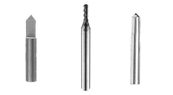

Engraving Tools: V-Bits, Drag Engravers, and Such
The typical cutting tools used for cnc engraving are V-Bits, small Ballnose End Mills, and Drag Engravers:
Metalworking tool with pointed tip and cylindrical body.

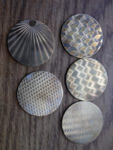

Guilloche, Rose Engines, Jeweling, & Engine Turning for Artistic Machining
Three silver coin-like objects with intricate guilloche designs and triangular arrangement.

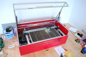

Red laser engraver with glass lid and silver interior on light-colored wooden table.
Homebrew DIY Laser Engravers
