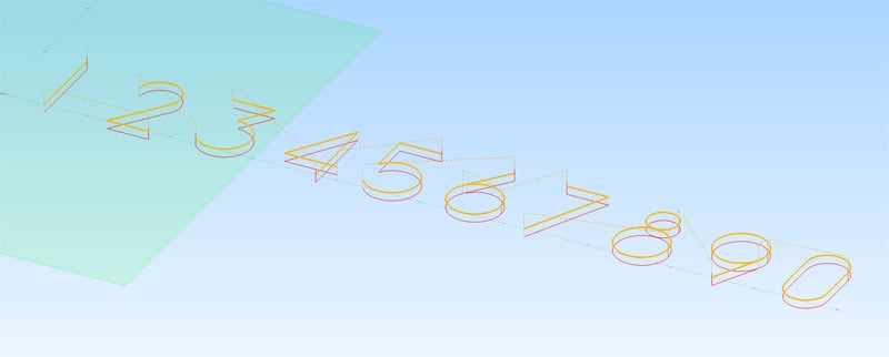

To start out, I wanted to create a “stick font” for the digits. I used my CAD program (Rhino3D) to create a DXF file of the 10 digits (right click and select download on this link to get the DXF file). I was careful to only use line segments and arcs, since those are the only shapes we can create in g-code. In addition, I scaled this alphabet so each digit was 1″ high and 1/2″ wide. They look pretty good printed in 1″ x 1″ squares.
I loaded that DXF file into my OneCNC CAM program and was very quickly able to post g-code. Here’s what the stick digits looked like with their OneCNC toolpath for engraving:
OneCNC Stick Digit Engraving
Stick Digits in OneCNC…
The digits are not bad looking and are drawn on 1″ x 1″ squares. They are simple enough it would have been easy to hand code the g-code by referring to the CAD drawing, but since I have good CAM handy, why not take avantage of it?

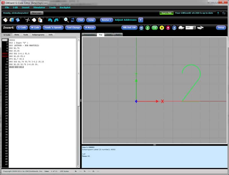

Shifting the coordinates left was just a matter of updating the “X” words with a little address arithmetic using G-Wizard Editor. Here’s what the basic program with backplot looks like before we shift:
Note the “2” digit is offset 1″ to the right of the origin…
Here is the Adjust Addresses screen set up to subtract 1 from every X word’s address:
G-Code Address Adjustment
Adjust every X by subtracting 1 from its address.

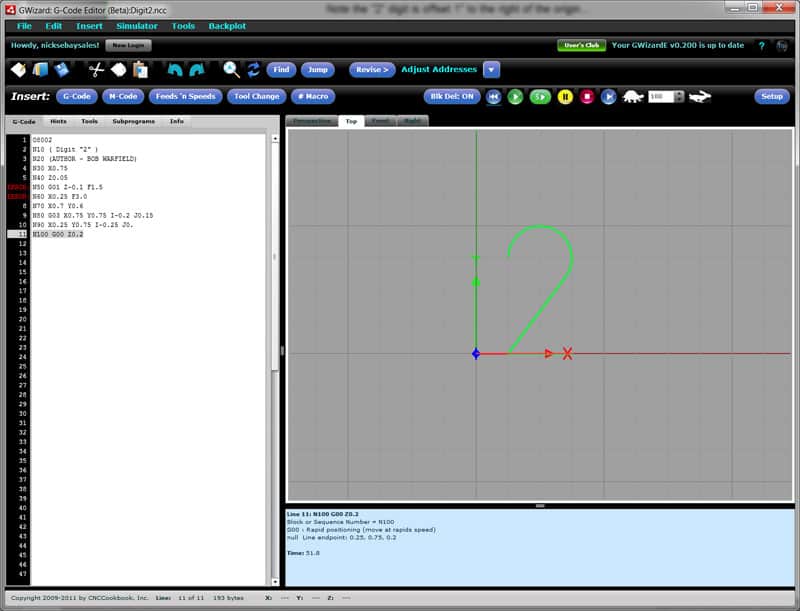

And here is the result after adjustment:
G-Code for the "2" Digit
“2” digit after shifting left 1″…
As you can see, Adjust Addresses is a pretty handy command. I still need to parameterize the program for the “2”, but we’re close. To finish a set of macros suitable for engraving digits, I need to go through and perform these operations on all the remaining digits too.
