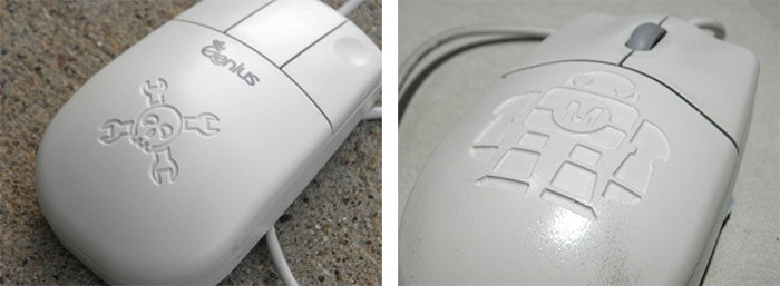

Engraving or machining on a flat surface is the norm–all CNC’ers figure out how to do it in short order. But what if you want to engrave or machine on an irregular surface? Let me show you what I’m talking about:
Engraving or machining on irregular surfaces is hard…

And there is–you need a little software utility I recently came across called “G-Code Ripper.” The GCode Ripper is a cool free CNC utility written by a guy who calls himself “Scorch.” It does all kinds of nifty things including the 4th Axis Wrapper stuff you may also find useful every now and again. A 4th Axis Wrapper will take flat XYZ gcoded artwork and wrap it around a cylinder. It just creates an easy way to machine things onto a cylinder.
GCode Ripper does all that, but it can also arbitrarily warp your 2 1/2 D GCode onto an arbitrary surface, such as the mouse pictured above. It does this by creating a “Map” of the surface using a probe, which it then uses to “warp” the flat gcode to fit the surface. Here it is in action in this YouTube video:
