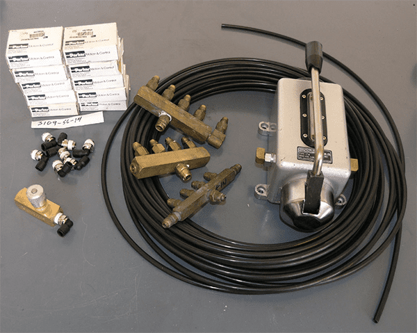

The bits I started with when I built my way oiling system...
The photo shows the bits I started with when I built my way oiling system.  There's a manual way oiler (pump), flexible tubing, push-on connections, and metering valves.

Manual Way Oiler
My first Way Oiler was a manual unit with a pump handle on the side.  Give it a few pumps while jogging the axes and you're done.  Just don't forget!  And BTW, how often should I be pumping while a job runs?
I won't have a machine without buying the automatic way oiler for it again.  A Manual Oiler is better than nothing, but not really good enough in the end.

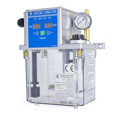

Automatic Oiler / Automatic Lubricator
Here's a typical Automatic Oiler:
Electric lubricator with settings display and pressure gauge.
It runs on a timer to ensure consistent deliver of enough oil.  That particular one is the unit that Tormach sells for their machines.

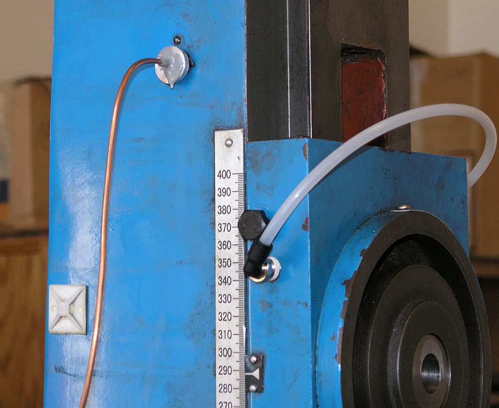

Plumbing involved first adding fittings to the original milling ports on each axis plus connecting those passages to the new oil distribution grooves.
Metalworking tool with blue component in a machining or metal fabrication context.No need to be super accurate locating this hole as we are drilling a much bigger hole.  I just used a spud to help line it up quickly.

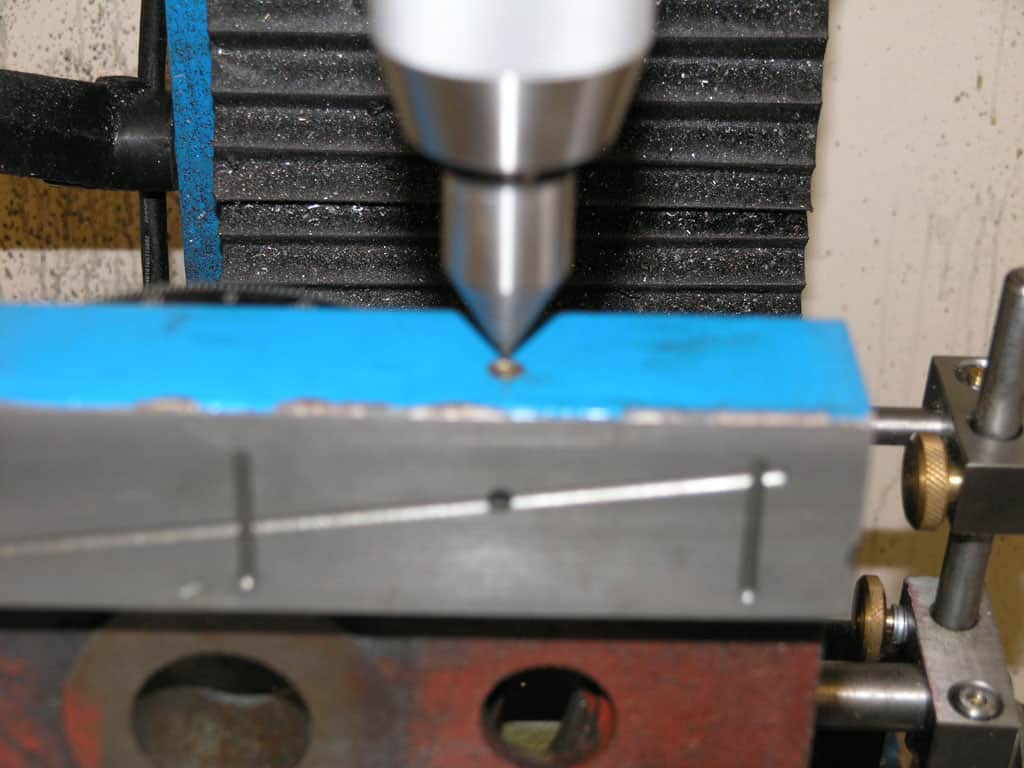

First line up on the old ball oiler location with a spud. On the Z-axis, this hole goes all the way through already (nice!). So we just get rid of the ball oiler (mine had to be drilled out)...
Metal workpiece on a drill press in a workshop setting.
And now drill the hole you'll tap for the fitting.  Did you use the best hole size for the tap?  G-WIzard will tell you what that is!
Blue metalworking lathe in a machine shop or workshop environment.
And tap. That fitting will be in the way of the gib locks, but I won't be using them anyway. I will likely put bolts of the same size into the holes to block them off...

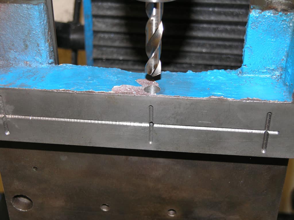

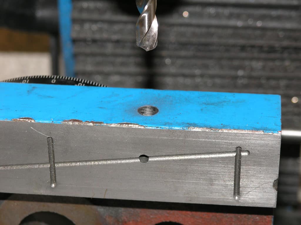

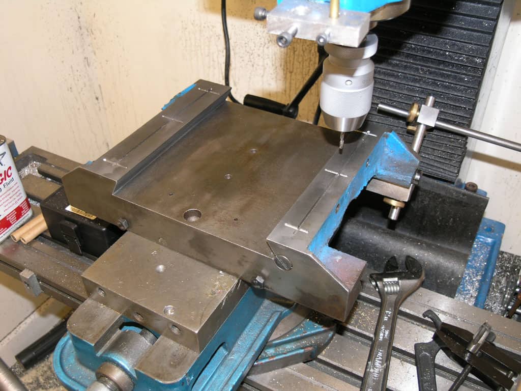

The saddle has no handy holes to work from. I'm drilling at the intersection of the middle cross grooves and centerline groove. The saddle is held by gently opening the Kurt vise with aluminum jaws against the ways. All holes are 0.450" deep.
Blue milling machine with metal base plate and tools attached.

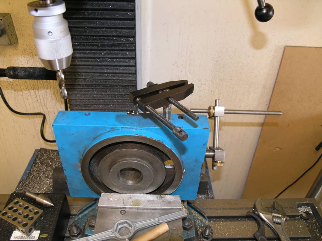

With both sides drilled, it's time for the cross passages. My 6" Kurt was too big, so I took it off the table and installed my 4" Kurt. The vise has to fit between the X-axis slides that stick out.  Not many machines with this much Z-travel!
Metalworking setup with drill bit or end mill on machinery.
Swap bits (almost not enough vertical room with my big keyless chuck!) and drill the fitting hole you will tap...
Note the cross-connecting hole I drilled before this one.

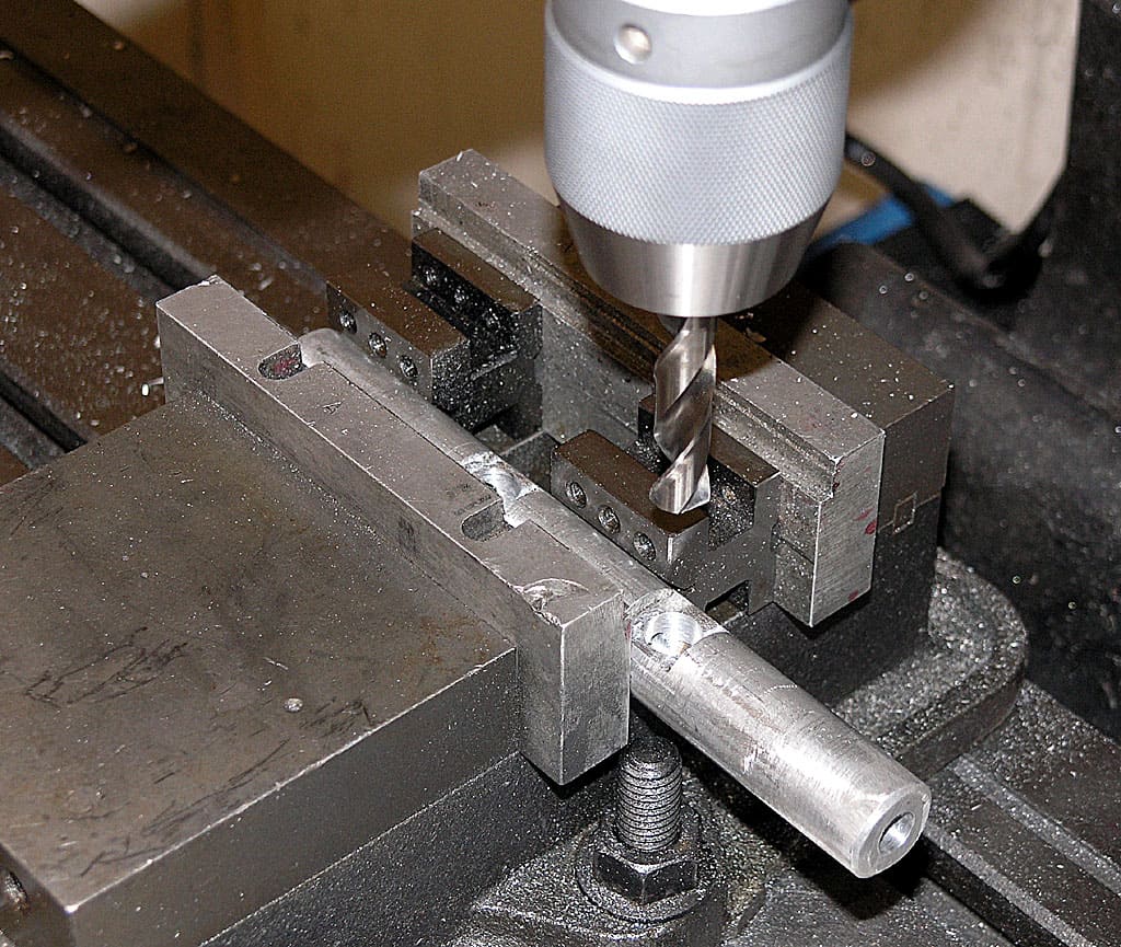

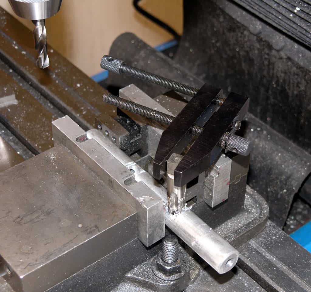

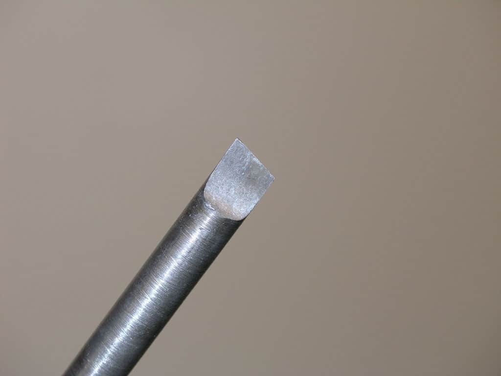

I wound up making a manifold, and as it was a long piece of alumimum rod needing a center hole all the way through, I needed a bit longer than I had on hand. So, I used it as an excuse to try my hand at a homemade D-bit:
Metal tool with square-shaped tip, shiny surface, likely used for cutting metal.
A D-Bit I made to bore the center hole in the manifold...
It cut fine, but loaded up with chips so fast it was a very slow process of having to withdraw every quarter inch or so to remove the chips. It seemed like it took hours, though it was probably only an hour and a half. Next time I'm ordering an extra long twist drill!
Silver drill bit with spiral flute attached to drill press chuck over metal workpiece on a vise in a machine shop setting.
I took a 3/4" endmill and made cuts, then drilled with 7/16".  The flats make for better drilling and give the fittings something to seat against.
Metalworking setup with drill bit and tools on a drill press or milling machine, surrounded by metal shavings and dust.
Since my tap wrench isn't big enough for this chunky 1/4" NPT tap, I used a machinist's parallel clamp...

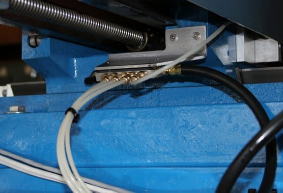

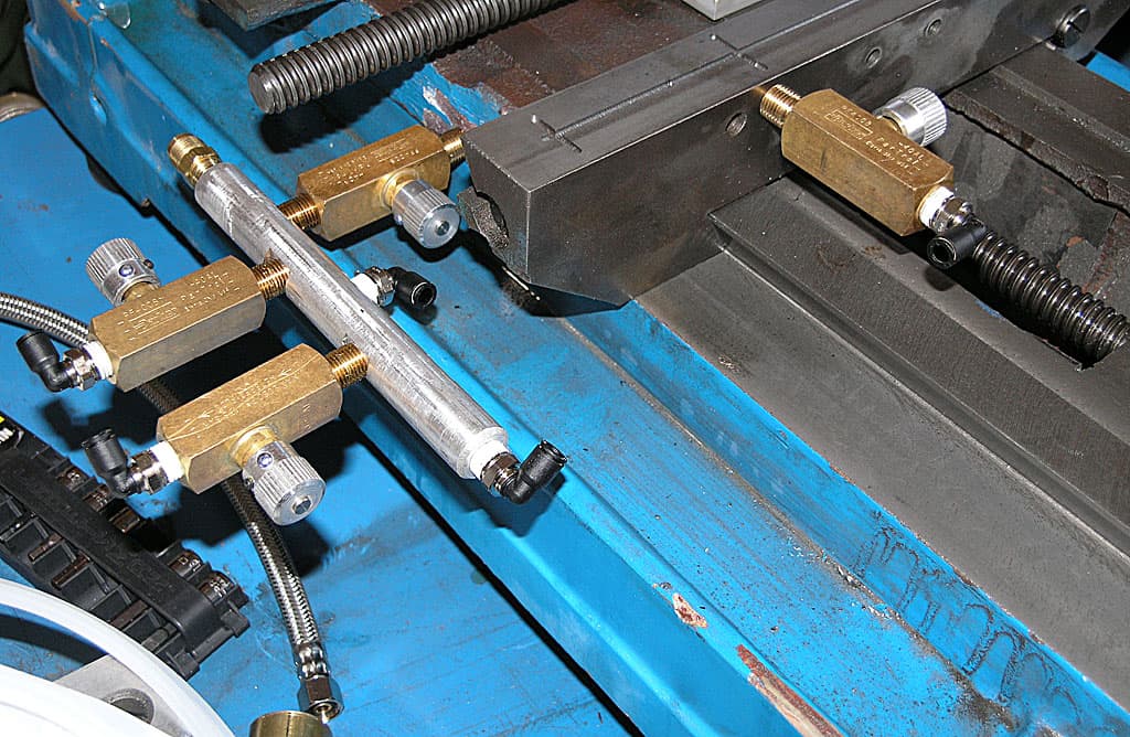

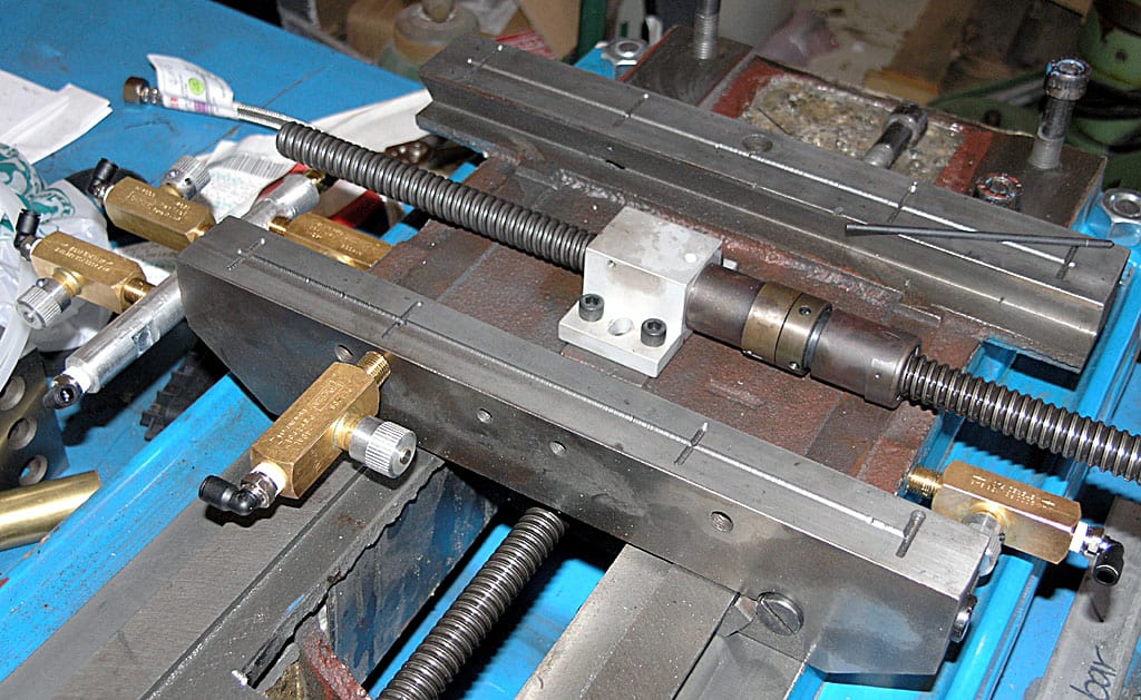

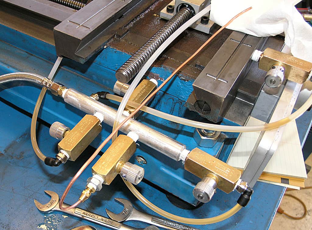

Here's what the manifold looks like trial fitted with the flow control valves and Legris push-on ells. I'll be using translucent tubing so I can verify visually that the oil is flowing...
A sturdy metal vise on a workbench, with adjustable jaws and robust frame.
A little broader view. There is a Legris on the back side of the saddle that goes to the top left flow valve. The valve right below it will be plumbed up to the ball screw lube port you see on the ball screw mount. I added that port!
Machining tools and equipment on a blue workbench in a metal fabrication setting.
Clear tubing makes it easier to monitor the oil. I adjusted valves until the oil was arriving everywhere at about the same time...

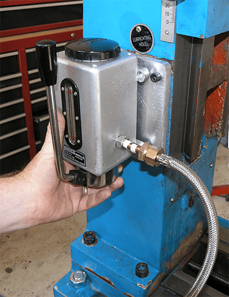

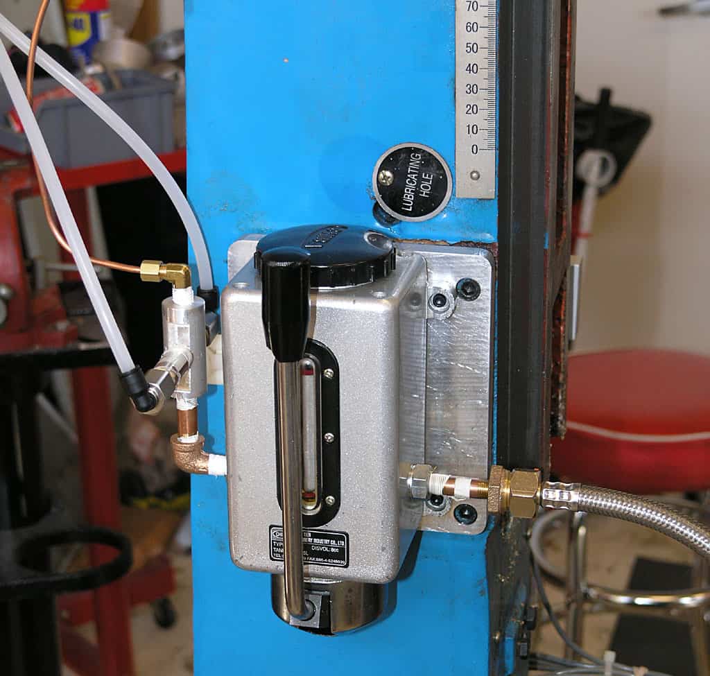

Oil Pump Mounting
A hand-held lubricating oil canister with a silver body and black knob on top attached to a blue metal machine with a hose.
Metal device in workshop/machine shop setting with tubes, wires, and dials.
Here's what the finished pump mounting looks like. The front line goes to the saddle. The rear line goes to the little manifold which has a vinyl tubing connection for either way on the Z saddle and the copper tubing goes up to oil the ballscrew. The rear circuit would benefit from a flow control valve, but I ran out of fittings. The flow control valve has two benefits. First, the check valve would keep the line charged so there'd be no need to pump oil up so far. Second, the current circuit flows a little too freely relative to the other circuit, so I get a bit more oil on this circuit than I'd like. It isn't terrible, so I don't know if I'll fix it or not.
Industrial device with blue body, copper tube, white gauge, and black knob in a workshop or laboratory setting.
I reused the original oiling hole for the ballscrew oiling. I turned a little press fit piece of aluminum and JB welded the copper tubing into the proper position. The oil flows out onto the top of the ballscrew where it can drain down through the grooves all the way to the ballnut.
While a little change here or there might improve the system (for example, a flow control on the Z-axis circuit), I am calling the one shot oiler done. It works extremely well and will give me a lot of peace of mind about the mill's durability and proper oiling. It was well worth the amount of effort I've invested in the project.
