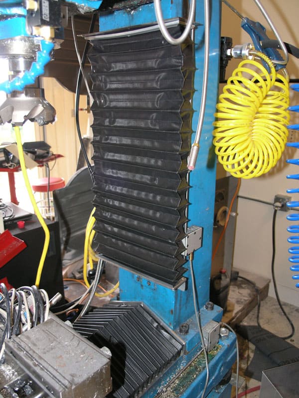

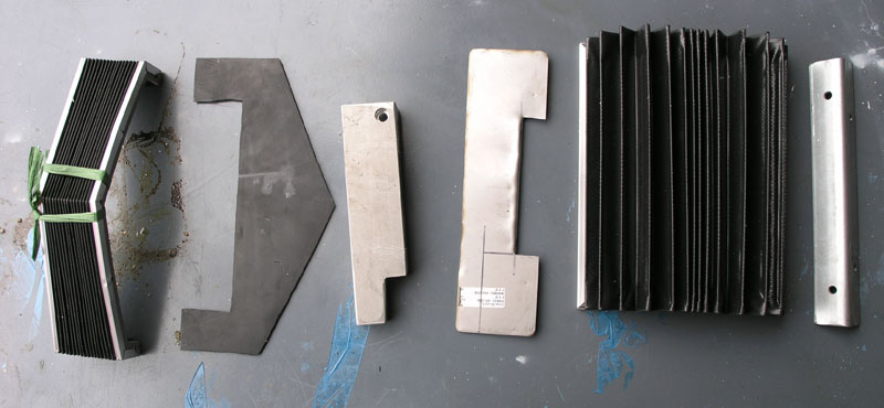

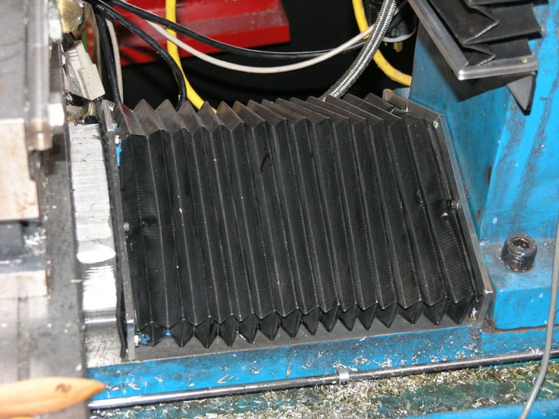

It took a little bit of fabrication of some adapter plates, and I had to drill and tap a few holes in the column, but here is what I came up with:
Set of parts including the bellows and the adapter plates I fabricated…
There is the Z-axis way cover in place…
And there is the Y-Axis way cover. You can see some of the mess these covers are designed to deflect away from the sensitive areas of the ways and ballscrews!

How thick is the Y axis cover when closed? Looking to see if it’ll fit my RF-31
You can see it there before installation. It’s a couple inches thick.
