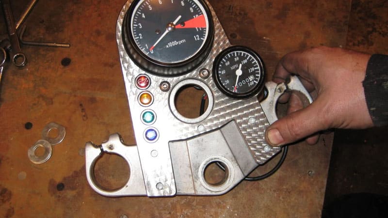

Here’s a motorcycle instrument pod done by reader Nate:

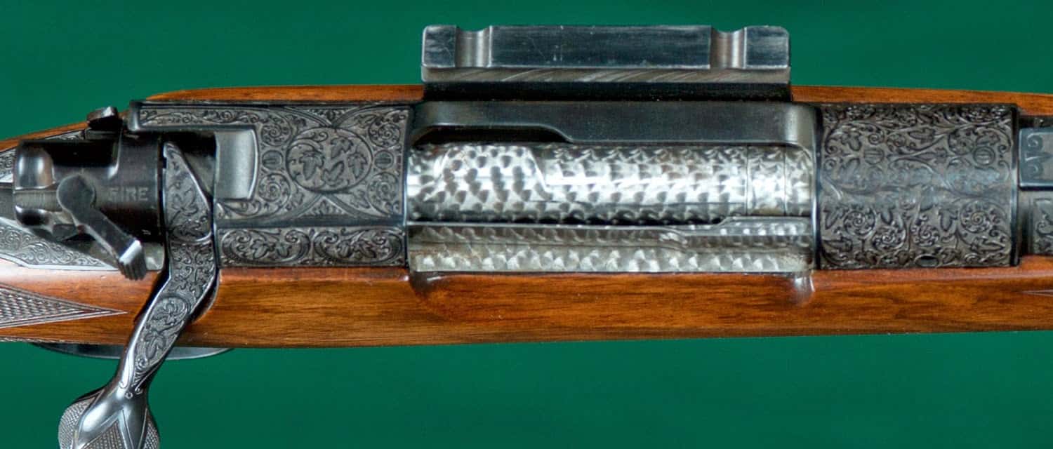

It’s often scene on the bolt and other parts of firearms as a decorative touch:

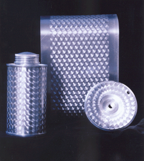

How to do engine turning and jeweling of bolts and other parts

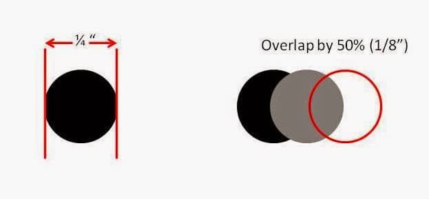

Engine Turning is very easy to do, at least in principle. You take an abrasive of some kind, put it on a rotating brush or buff, and drop it down onto the work in a pre-defined pattern. Typically, you overlap the plunges by half the diameter of your jeweling “cutter”:
Image via Tin Can Bandit’s Gunsmithing Blog…
Most jeweling is done by hand, often with a drill press, but a CNC machine can make short work of the task and CADCAM software can achieve a perfect layout. Try programming a plunge milling toolpath to achieve the desired effect.

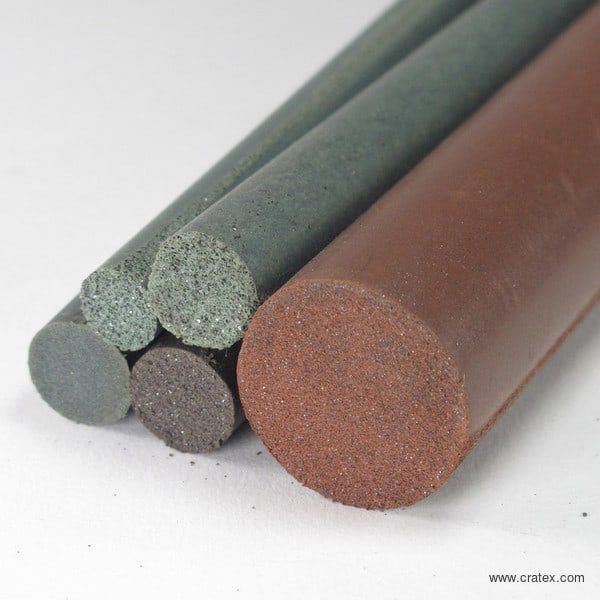

This technique works, but is messy and a bit fussy. A method I like better is to chuck up an abrasive stick, such as a Cratex:
Cratex rubberized abrasive sticks…
Cratex sticks are just abrasive embedded in rubber. Use with a little WD-40 or other convenient lubricant and they work great. On a CNC, your machine’s normal coolant should be fine–no need to contaminate it by adding oil.
I use Cratex sticks quite a lot around the shop, so I bought their big assortment of sizes and grits. But, you can also buy single sticks very cheaply.
Engine Turning, also called Damascening, is a very straightforward process. It’s not hard, but it does require a lot of time and you need to be painstaking about how you overlap the pattern for best effect.
I prefer engine turning softer materials like aluminum. Obviously a rifle bolt will be quite a bit harder, so it will take longer.

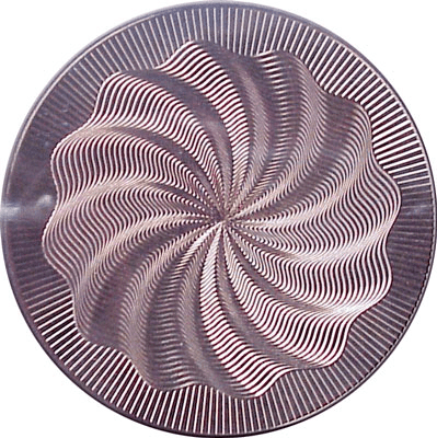

Guilloche, Rose Engines, and Ornamental Turning
Fine jewellers scoff at the idea of engine turning being “jeweling.” It’s entirely too coarse a method for their needs.
Instead, they use a technique called “Guilloche” and a machine called a “Rose Engine” to do Ornamental Turning. BTW, it’s pronounced “Gee-o-shay” and is a French word. I will take this opportunity to apologize for not using the proper accent on the term Guilloché, but it is just easier to type without it and the use of the term without it appears to be commonplace on the Internet.

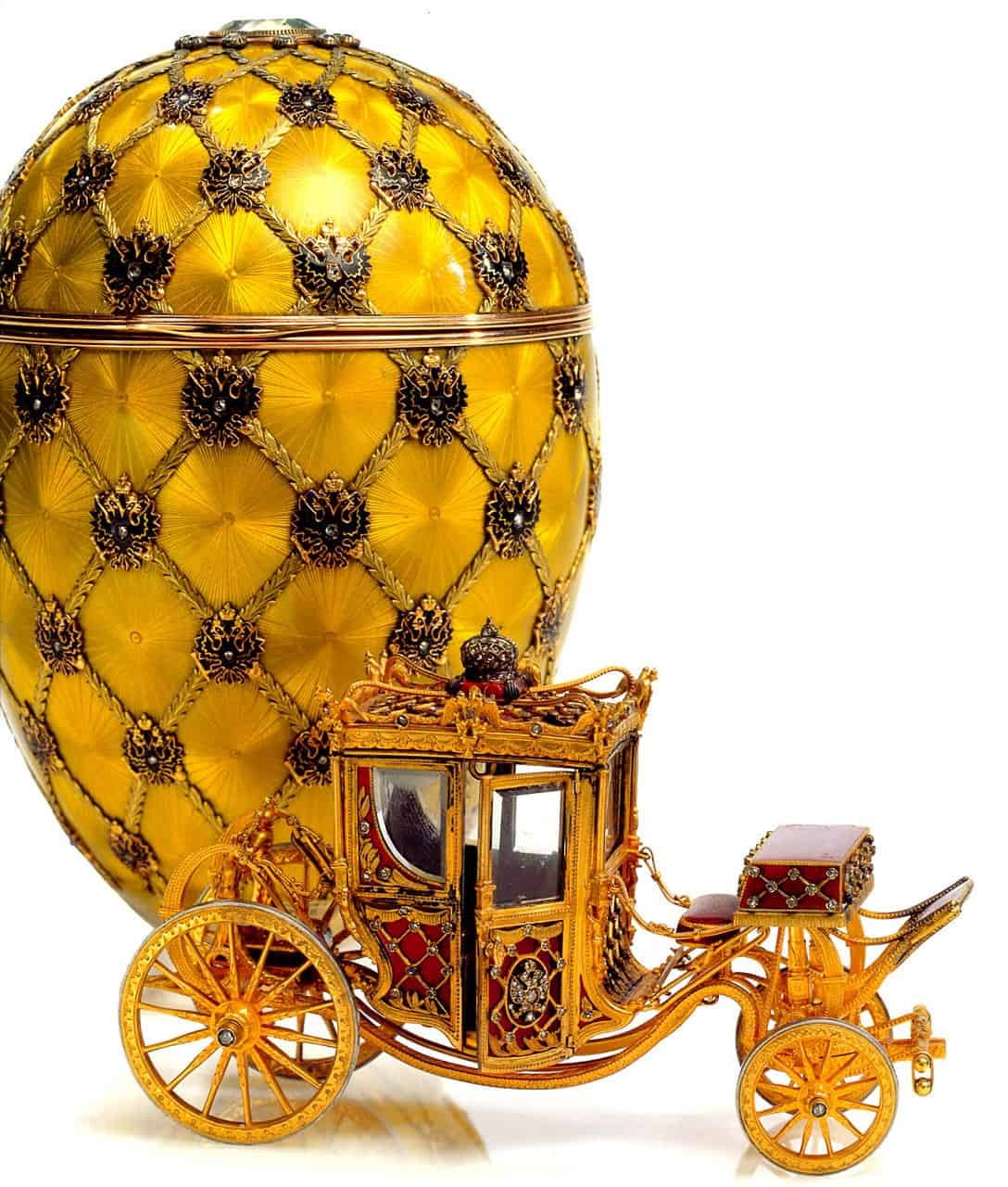

Their results are often spectacular:
The finally engraved patterns on the Faberge Egg are guilloche…

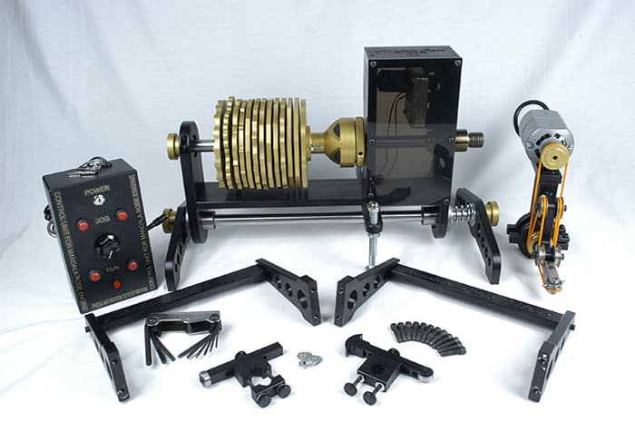

Traditionally, Guilloche is created using a Rose Engine. Machinists will recognize it as an odd combination of lathe, 4th axis, and shaper. Complex and very Old School, but also very cool!
It turns out one of our G-Wizard Customers makes Rose Engines if you would like to look into purchasing one:
Mandala Rose Works Rose Engine…
I wrote a Customer Spotlight about Wade Wendorf’s great little company and products that you should check out.

As you can see from the video, Guilloche is done with a machine that’s more like a very specialized shaper than a lathe or milling machine. This results in the markings on the material having a much different character and a lot more texture.
In addition, these old machines are entirely hand powered. They use cams (called “Rosettes”) to give the workpiece a periodic “wobble” that results in the distinctive curves and curlicues that are characteristic of Guilloche. If you watch closely, you can see that the operator has to manually start, stop, and position the cutter to keep the design within the outline it is bounded by.

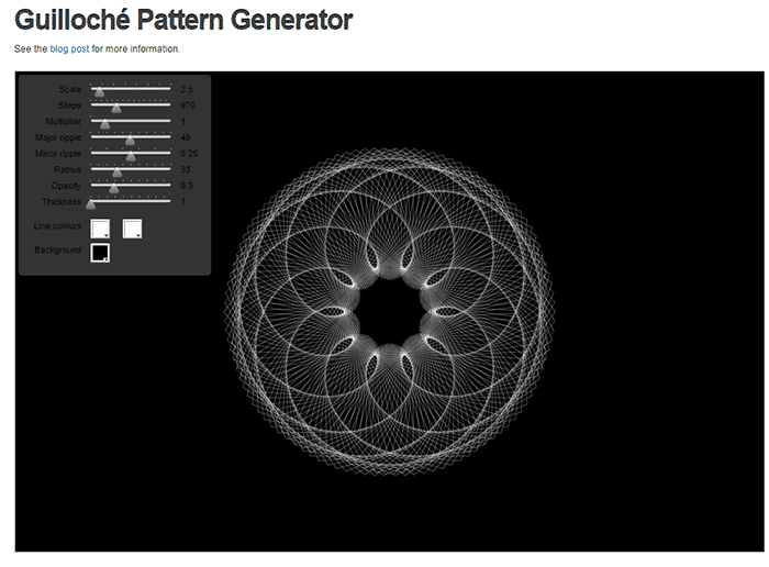

Also, much as I would love to write a Guilloche program of my own, there are already some very nice ones out in the world.
Guilloche patterns can be generated mathematically, for example by this program.
That’s quite a nifty little free program to get started with.

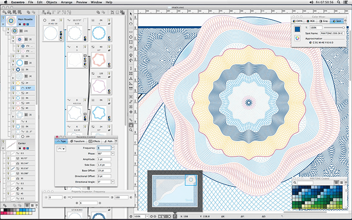

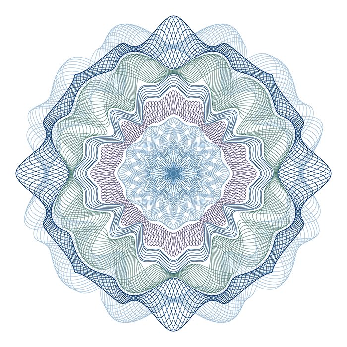

I also have a copy of what is probably the world’s foremost and sophisticated Guilloche software:
It’s called Excentro and it is quite sophsiticated. Apparently it has been used to design modern guilloche patterns for modern banknotes of several countries, so it is likely the ultimate.
There are other packages out there, so you’ll want to pick one that you’ll use to create your patterns.
Their output is a vector graphics file, so your next step will be converting that to a DXF file so your CAM software can access it. Adobe Illustrator, Inkscape, and other vector drawing programs can do this.
Once you have a DXF, you are ready to import it into your CAM software and generate an engraving toolpath from the pattern.
