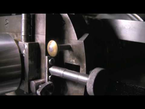

As you can see from the video, Guilloche is done with a machine that's more like a very specialized shaper than a lathe or milling machine.  This results in the markings on the material having a much different character and a lot more texture.  In addition, these old machines are entirely hand powered.  They use cams (called "Rosettes") to give the workpiece a periodic "wobble" that results in the distinctive curves and curlicues that are characteristic of Guilloche.  If you watch closely, you can see that the operator has to manually start, stop, and position the cutter to keep the design within the outline it is bounded by.

I believe this video is from Victorinox, and there are some fascinating insights to be found in it.  The discussion of how the Guillocheur uses his sense of touch and visual indication of chip size and formation to create the best effect is wonderful.  Also note that this Rose Engine has not only the normal Rosette cams, but an additional cam at right angles that he uses to create more geometric patterns.  Heretofore I had associated Guilloche primarily with curves, but we can see this is not a requirement.
