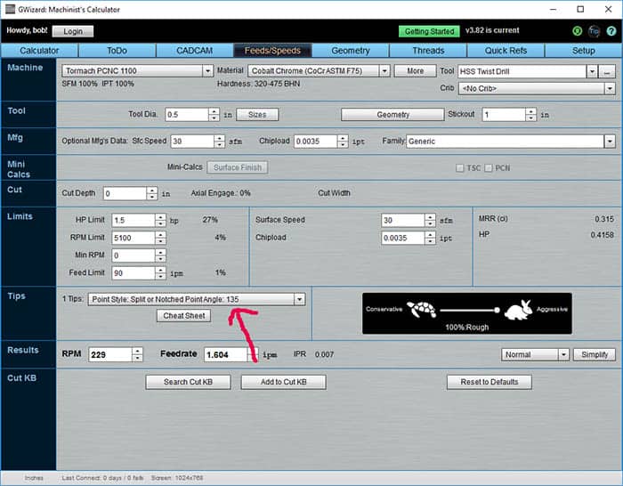

But, our G-Wizard Calculator has a feature called “Tips” that keeps up with this sort of thing for you. Here’s that Cobalt-Chrome twist drill tip, for example:
Twist Drill Point Angle Tip…
