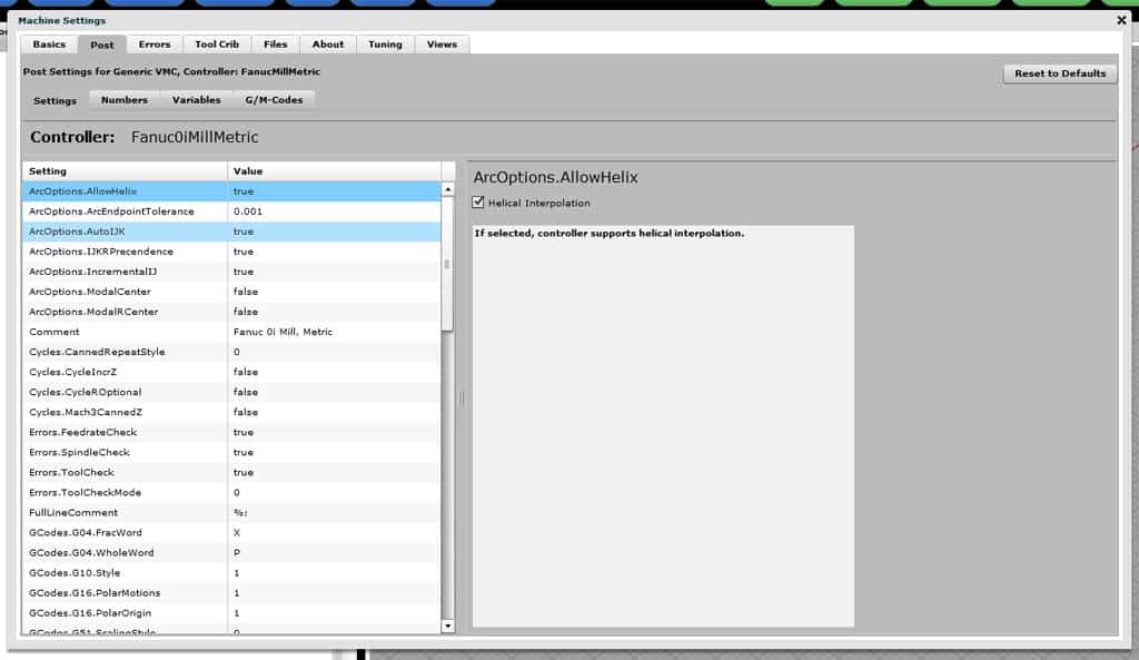

The Post Settings tab gives you access to a number of different variables that define the controller’s behavior. You select the variable (or setting) from the scrolling list on the left and the editing pane on the right will tell you more about what the variable does as well as allow you to change it.
Here’s a list of each of the Settings Tab’s options along with a brief description of what that option does:
ArcOptions.AllowHelix: If selected, controller supports helical interpolation.
ArcOptions.ArcEndpointTolerance: Endpoint radius tolerance. Its an error if distance from arc center to each of the endpoints differs by more than this amount.
ArcOptions.AutoIJK: Ignore IncrementalIJK and use Auto mode if true. Auto mode will try to choose the mode (incremental or absolute IJK) that minimizes the arc errors.
ArcOptions.IJKRPrecendence: If selected, when both IJK and R are specified, R has precedence (Fanuc). Otherwise, IJK has precedence.
ArcOptions.IncrementalIJ: IJK is incremental if checked and absolute if not.
ArcOptions.ModalCenter: If true, IJK Centers are remembered (modal) once set until they’re changed.
ArcOptions.ModalRCenter: If selected, R is modal. Note: With both IJK and R present, IJK are ignored.

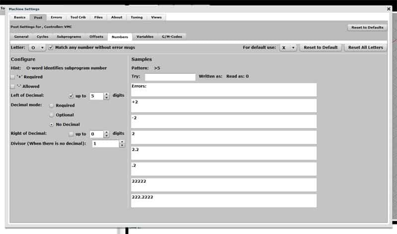

The Numbers tab under Post is used to set the options for how the numbers found throughout a g-code program are to be interpreted. Each g-code word is a letter such as “G”, “M”, “F”, or “S”. Associated with each letter or group of letters is a set of options that determine what kinds of numbers can go with the letter.
Here is the Numbers tab:
The Numbers tab…
To use the Numbers tab, first select the letter you want to customize. Here are your choices:
O: The “O” word identifies programs. It is generally followed by a number that identifies a particular “N” line, so you typically want to use the same options with “O” that you use with “N”.
N: The “N” word is used to label a particular block (a line of g-code) using a number. The number is typically 4 or 5 digits and must be positive.
G: “G” is for G codes like G01 and G2. Note the leading “0” when I wrote “G01”. Some controllers care about that leading zero and some don’t. You can tell G-Wizard whether to force a leading zero or not here.
F: “F” is for feedrate.
X: “X” is for any coordinate word including X, Y, Z, I, J, and K.
S: “S” is for spindle rpm.
M: “M” is for M codes (Miscellaneous codes). They’re usually formatted just like G codes, so for example, you need a mandatory leading zero for single digit m-codes on your controller.
After selecting the desired letter, the Numbers will show the options associated with numbers for that letter in the left column and some examples on the right.
Let’s go through our list of options:
Option Purpose
“+” Required Determines whether a “+” sign is required for positive numbers. Some controllers require one.
“-” Allowed Determines whether the number can be negative. If so, it requires you to designate negative numbers with the minus sign.
Left of decimal “up to” checkbox If the “up to” box is checked, it means the number of digits can be any number up to the specified number. If it is not checked, the number of digits must be equal to the number specified, with leading or trailing zeros required to make up any shortfall.
Left of decimal digits The number of digits left of the decimal point. The whole number part.
Decimal mode
Right of decimal “up to” checkbox If the “up to” box is checked, it means the number of digits can be any number up to the specified number. If it is not checked, the number of digits must be equal to the number specified, with leading or trailing zeros required to make up any shortfall.
Right of decimal digits The number of digits right of the decimal point. The fractional number part.
Divisor After the number has been captured, but before it is used by the controller, it is internally divided by this value.
In the righthand column are some tools designed to help you understand what the options you set are doing. You can enter samples into the “Try” box and see what G-Wizard thinks the value of the number is and whether it has any errors.
Below the “Try” box are a series of examples that show what will happen in various cases.
“Pattern” is a shorthand way of writing out the options that is used by a great many CAM programs as well as by utilities for postprocessing such as Posthaste. If you know the pattern of your number, being able ot see what pattern G-Wizard thinks you have set up should help you to match the two up.
When you’ve got the options the way you want them, press the “Save” button below. Note that each letter must be individually saved. You can also reset the options to the default letter by letter, or at the top is a button labelled “Reset All Letters” that will go through and change all of them to the original G-Wizard defaults.
Note that there is also a default format, which is chosen at the top right of the screen. When no format is defined for a particular address (letter), the format associated with the default is used.

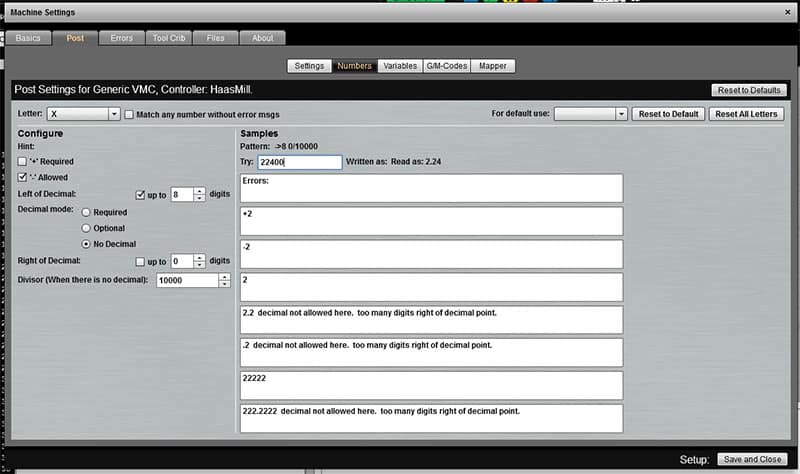

Number Example: Controllers that Use no Decimal Point
Some controls like the Acramatic 900 don’t use decimal points. On a control like this, if you want to rapid to X = 2.25 and Y = -1.75 you would write the following line of code:
G00 X22500 Y-17500
It’s easy to set up GWE to handle that sort of number format for coordinates. Here is what the settings should look like:
Setting coordinates up so they don’t use a decimal point…
I made the following changes to make this work:
1. Select Letter “X”, which is what coordinates are tied to.
2. Make sure “Match any number” is not checked. This forces the new formating to be used. We only had to do it in this case because we want to divide the number and not just format it. If it was just formats and we didn’t care about error messages, we could leave it checked.
3. Increase the number of digits available left of decimal by 4.
4. Set “Decimal mode” to “No Decimal”.
5. Set right of decimal to 0 and made sure the “up to” checkbox was not checked.
6. Set the Divisor to be 10000.
After making those settings, be sure to go enter a test value where it says “Try” in the right half of the screen. I entered “22400” as my test value and it shows this will be interpreted as “2.24”, which is exactly what I want. Now just press “Save and Close”.
Note that you’ll have to do a “Save and Close” for each letter you want to change.

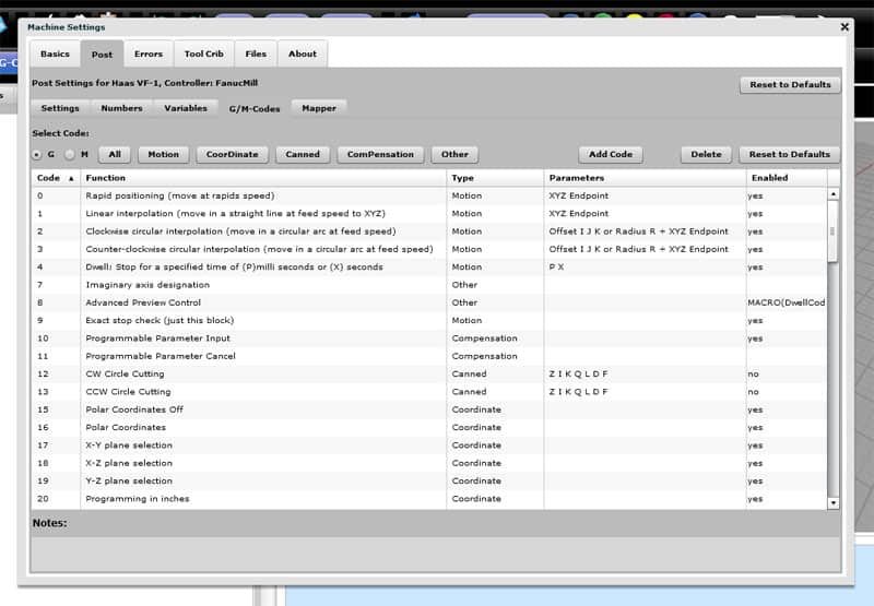

G/M-Codes
The purpose of the G/M-Codes tab is to let you tell GWE which g-codes your controller actually implements and to create custom G/M-Codes. Work on custom g- or m-codes is all done on the Setup | Post | G/M-Codes tab:
The Setup | Post | G/M-Codes tab…

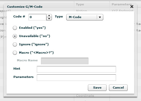

Adding or Deleting Simple G- and M-Codes
Adding simple g- or m-codes is easy. What we mean by “simple” is these are codes that don’t much that is visible to the backplot or that affect other codes much. Machines often have all sorts of codes that fall into this category. Things like activating clamps, chip augers, and turning coolant on or off, all fall into this category.
To add a code, click the “Add Code” button and you’ll see this popup:
Add G- or M-Code Popup…
The popup is pretty simple to use:
1. Enter the code #. So, to add a G113, put “113” into the “Code #” box.
2. Classify what type of code it is on the “Type” dropdown. Types are the same as those that appear across the top and are largely a search aid. There is only 1 type for M-Codes, so if you’re creating a new M-Code, you must use the M-Code type. Otherwise, you’re free to choose whichever type makes the most sense to you.

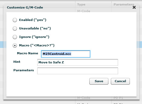

3. The behavior of your new g- or m-code will be decided by your next choice:
– “Enabled” makes it do whatever G-Wizard would do with the code by default anyway.
– “Unavailable” makes it an error to use the code. This is how you turn off or delete codes that your machine won’t handle.
– “Ignore” causes the code to be accepted without error, but GWE just ignores it. This is how you add codes such as chip augers and the like that don’t affect the backplot or other simulator behavior.
– “Macro” is the most complex option. It lets you write a g-code macro that is executed whenever your code is encountered in the program. More detail on how to do that later.
4. The “Hint” field lets you specify the message that will appear in the hints for the line.
5. The “Parameters” field is a comment to remind users what the parameters are to be used with this code. For example, you might put “XYZA” with G00.
That’s all there is to creating simple g- or m-codes. Save from the popup and close the Setup and your new g- and m-codes (or deleted codes) will be part of your post.

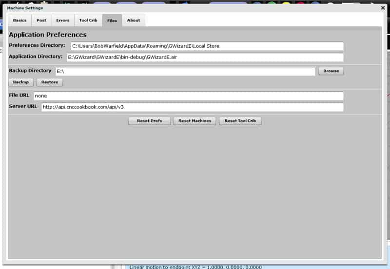

Now place that macro into a file called “M25Centroid.ncc”. It doesn’t really matter what you call it, just remember what the name is. Next, you need to store the file in the “Posts” directory, where G-Wizard Editor will look for it. You can find this directory by bringing up the “Setup” page and clicking the “Files” tab:
Files tab shows where to find Preferences Directory…
The very first entry at the top is the Preferences Directory. If you go to that Directory (or Folder if you prefer that term), there is a sub-directory called “Posts”. That’s where you want to put your macro files.
Note: That directory also contains the as-downloaded latest versions of the canned posts. However, when you select a post for a machine profile, it gets copied to the Preferences directory. That’s the post that gets modified by the Setup page, so the ones in the Post Directory stay pristine.
Now that we have our macro file written and put into the Posts directory, the last step is to bring up the “Add G/M-Code” popup and configure M25:
Setting up M25 to call the M25Centroid.ncc macro…
Select the “Macro” choice, enter the file name into “Macro Name” and give it a hint if you like. Now you’ve set up a new M-code that will call this macro each time it is encountered in the code.
You could enter much more complex macros than this, but you’re limited by the g-code syntax your currently selected post supports. Because of that limitation, if you need complex macro-simulated g-codes, you’ll want to base your post off a post like Fanuc that has good macro facilities.

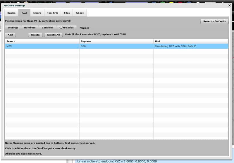

Using Mapper to Change Your G-Codes to Something GWE Can Use
Another useful capability is the Mapper. Essentially, Mapper does a quick search and replace on a line of g-code before the simulator accesses it. This lets you change all sorts of things around. For example, this is how the SETVN functions allow symbolic names for macro variables instead of numeric names–they use Mapper to convert the symbolic name to the right number. You could use Mapper to shift around G- or M-Codes. For example, we could take the Centroid M25 example and set up a Mapper rule that simply replaces “M25” with “G28”. The reason we didn’t do that is because the macro option allows for a little nicer debugging playback, but Mapper would’ve worked pretty nearly as well. In general, if you can use a macro, that’s the preferred method, and if not, use Mapper.
The Mapper is accessed via the Setup | Post | Mapper tab:
Here’s Mapper set up to replace M25 with G28…
Remember, Mapper just does a simple textual search and replace on your g-code line before the simulator executes it. The resulting string is not saved anywhere you can see it. Each search and replace is executed in order from top to bottom.
To create a new Mapper rule, click “Add”. You’ll get a new row that tells you to double click each cell to type in your search and replace values. The Hint gets added to the block whenever a rule is triggered.
Another important note: For performance reasons, Mapper can not be used to change simple lines containing only XYZ moves!
To see an example of Mapper in action, have a look at the FADAL Mill post. It uses Mapper to convert FADAL’s “Exx” work offset syntax to a Fanuc-style “G54.1 Pxx” syntax.

Number formats are handled similarly:
Word.A = ->5.>3;
It’s easier to review that in the Post | Numbers tab, but it is saved as that post variable.
