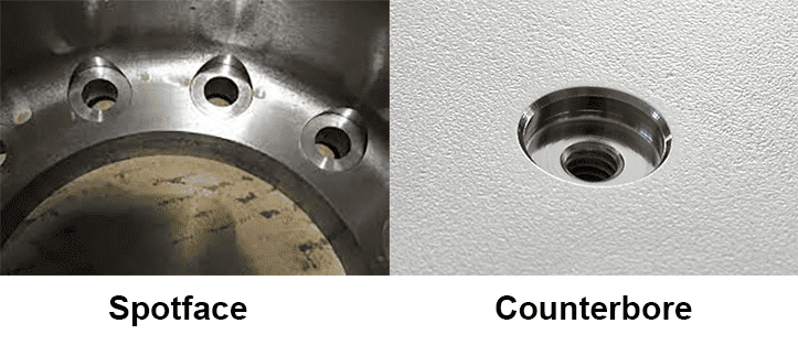

Spotface: Definition and Purpose
A spotface is a shallow counterbore that provides a flat, accurately located surface with a smooth finish. The primary purpose of a spotface is to offer a level surface for the screw or fastener to be seated on, ensuring accurately located surface stands. Spotfacing is executed to generate a smooth, level, and consistent surface for fasteners, while counterboring creates a cylindrical recess for fastener heads.
Creating a spotface involves machining a shallow, circular indentation on the workpiece’s surface. The spotface is typically achieved by cutting a shallow counterbore that is just deep enough to make the surface flat. This process ensures a smooth and accurately located mounting surface for fasteners such as bolts, nuts, and washers.
Counterbore: Definition and Purpose
A counterbore is a cylindrical recess machined into a part to accommodate a screw head or other fastening component. The primary purpose of a counterbore is to protect the head of the fastener and enable it to sit flush with or below the level of a workpiece’s surface. This is achieved by enlarging a drilled hole for a section of its length, allowing for the placement of a screw head in the counterbore screw hole. The section of the hole that has been enlarged is also referred to as a counterbore. Counterbore holes are essential in various applications where a clean and flush finish is required.
In essence, counterboring creates a cylindrical, flat-bottomed hole that is deeper than a spotface and specifically designed to accommodate screws with flat-bottomed heads. This machining process ensures a secure fit for fasteners, providing a flush and recessed mounting surface for screws and other fastening components.

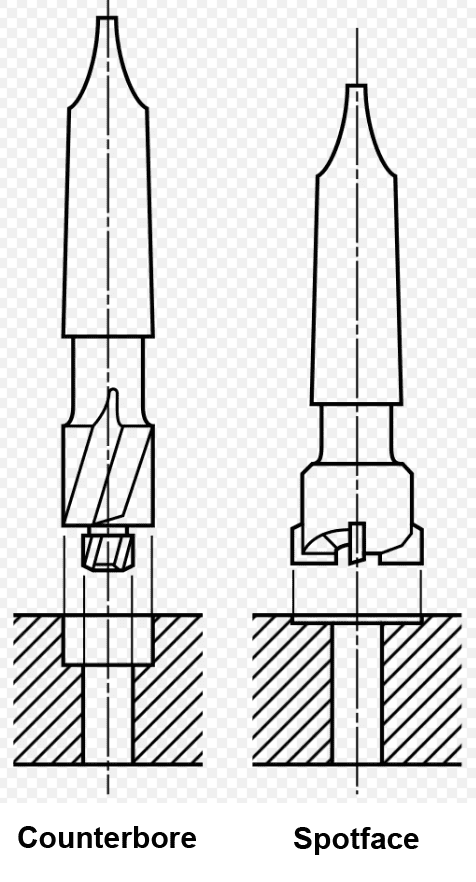

Depth and Function
The primary distinction between spotfaces and counterbores in terms of depth is that counterbores are typically deeper than spotfaces. The purpose of a counterbore is to position the head of a fastener beneath the surface of a part, while spotfaces are shallower and intended to create a flat area on the surface. The depth of a counterbore allows for a recessed mounting surface, ensuring that the head of the fastener is flush with the surrounding material.
In terms of function, spotfaces create a flat mounting surface for various types of fasteners, while counterbores are specifically designed to recess the head of a fastener, such as a screw or bolt, beneath the surface of the workpiece. This difference in function is essential for determining the appropriate machining process for your specific application.

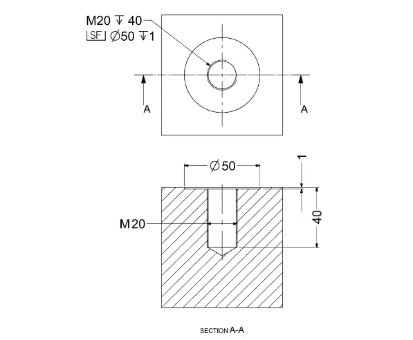

Spotface Symbol
Mechanical component technical drawing with dimensions.
Complete callout for a Spotface...
The spotface symbol is the counterbore symbol with “SF” in the middle, as per the ASME Y14.5 standard. This symbol denotes a spotface feature on a technical drawing, indicating the need for a flat, accurately located surface to accommodate a fastener, such as a bolt or nut.
By including the spotface symbol on a drawing, engineers and machinists can ensure that the required spotface feature is created during the machining process.

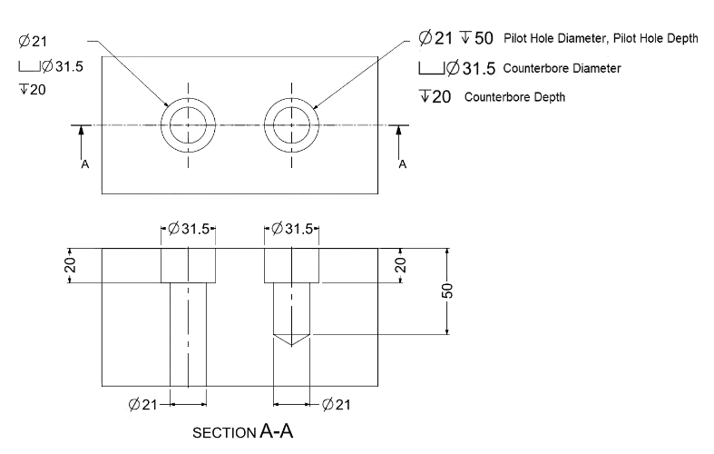

Counterbore Symbol
Pilot holes with dimensions and labels.
Complete callout for a Counterbore...
The counterbore symbol is a circle with a smaller, concentric circle inside, according to the ASME Y14.5 standard. This symbol is used to indicate the need for a counterbore hole feature on a technical drawing, providing a recessed area for a fastener head, such as a socket head cap screw, in a cylindrical hole for a bolt hole, to sit flush with the surrounding material.
By incorporating the counterbore symbol on a drawing, engineers and machinists can ensure that the required counterbore feature is created during the machining process.

Dimensioning a Spotface
Dimensioning a spotface involves specifying its diameter and depth. The diameter corresponds to the flat, smooth surface that contacts the washer, nut, or bolt-head, while the depth is typically about 0.0625 inches deep. By dimensioning a spotface accurately, engineers and machinists can ensure that the spotface provides the required support for the fastener and that the connection between the fastener and the workpiece is secure and precise.
It is essential to ensure that the minimum perfect diameter, as specified in the dimension, is reached when machining a spotface. This guarantees that the spotface will provide an accurately located surface for the fastener, ensuring a secure and flush connection between the fastener and the workpiece.
Dimensioning a Counterbore
Dimensioning a counterbore involves specifying the diameter of the counterbore, the depth of the counterbore, and sometimes the diameter of the pilot hole. The diameter of the counterbore corresponds to the recessed area for the fastener head, while the depth determines how far the fastener will sit below the surface of the material. The pilot hole diameter is critical, as it defines the size of the counterbore and ensures a secure fit for the fastener.
By accurately dimensioning a counterbore, engineers and machinists can ensure that the counterbore provides the required recess for the fastener head and that the connection between the fastener and the workpiece is both secure and precise.
