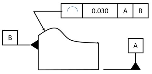

Profile of a Line on Drawings
gd&t profile of a line symbol callout example
Profile of a Line Callout on a drawing where the drawing is a cross-section of a complex curved surface…
Above is a typical example of a callout for Profile of a Line on a drawing.
