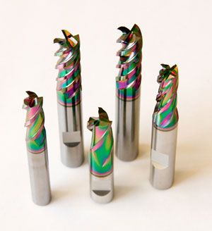

Metal endmills with diamond-like carbon coating on white background.
Endmills with a diamond-like carbon coating...
Go through your Operations List created in the previous step and add a column of information that will be the list of Cutting Tools that will be used for each operation. If you find the operation needs multiple tools, break it down into multiple operations. For example, a hole might be drilled and then reamed or threaded.
Not all tools are equal. You may want to choose tools that are on hand, or you may want to minimize the need for special tools that are not part of your shop's normal inventory. This may create opportunities to go back and change the Design of the part so it won't require the special tooling to be ordered.
