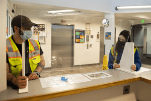

Sneeze Guards
A simple portable sneeze guard...
Sneeze Guards perform essentially the same role as Full Face Shields, but nobody has to wear a Face Shield. As such, they're friendlier in environments where they make sense. Any situation where you need to walk up to a counter and talk to someone is a potential Sneeze Guard application. There are portable sneeze guards, counter sneeze guards, and what I would call "partition sneeze guards."
You can use floor standing / partition sneeze guards to protect coworkers that have to sit near each other in regular desks.

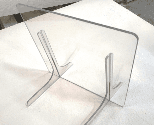

Sneeze Guard DXF Files
Much like Medical Face Shields, you can download DXF files for sneeze guards from a variety of sources, such as the Fabricators Fighting Covid-19 site.
Sneeze Guards are apt to be much more custom than Face Shields, so you're going to want to get your own CAD models going that you can update to customize as needed. You're basically looking at a family of parts that include:
- Legs and feet to hold the Sneeze Guard
- Brackets or slots to attach the Sneeze Guard to the Legs and Feet
- Templates for cutting out the Sneeze Guard itself.
Spend a little time getting ideas by browsing the web, borrow some DXF files, and start modifying to create your own designs. If yours look better or have other features and advantages you'll have an advantage in the sales call.
Be sure to consider custom touches like adding the customer's logo or other messages via engraving, laser, or masking off and sand blasting.

Custom Sneeze Guards
Sneeze Guards (and many other items in the store like the checkout desks and store displays) are made on a CNC Router, such as the American Made, M-Series CNC Router by C.R. Onsrud.
Typically, these dividers will be machined from a sheet of polycarbonate, acrylic, plexiglass, or other types of clear plastic polymer.
To hold up the dividers, feet or stands are then needed. These stands are also machined on CNC Routers and can be made of many different types of materials as well, depending on the type of look the business wants. Some companies will opt for a simple plastic foot for a more portable design, while others may choose to make a stylish or heavier base out of aluminum or wood to have a more permanent presence.
Other dividers are simply attached to existing counters or hung from overhead. Additional types of protective shields like Intubation Boxes, Splash Guards, food shields, barrier shields, face shields, and more, can also be made on CNC Routers. These items are made through similar processes out of much of the same materials.
