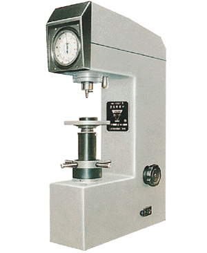

Indentation Hardness
A typical hardness tester…
Indentation hardness measures the resistance of a sample to deformation due to a constant compression load from a sharp object. After the material under test is subjected to a specially loaded and dimensioned indenter, the dimensions of the indentation left behind in the test subject determine the hardness.
This is the most common method of hardness testing used for CNC and machining purposes, and the Rockwell, Vickers, Shore, and Brinell Hardness scales are all based on Indentation Hardness.

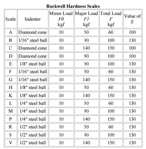

Rockwell Hardness Test (HR)
In the Rockwell Hardness Test (whose values are referred to with the abbreviation “HR”), a diamond cone or steel ball indenter is used. The indenter is forced into the test material under a minor load, usually 10 kgf. When equilibrium is reached (i.e. no further indentation at that load is happening), a datum position is established. An additional major load is applied, which increases penetration. Removing the major load results in a minor recovery of the material in most cases. The difference between the indentation after that minor recovery and the datum established by the minor load may be used to calculate the Rockwell hardness number.
The various Rockwell Hardness Scales differ in the nature of the indenter as well as the Major Load:
Testing parameters for the various Rockwell Hardness Scales…
The Rockwell Hardness Test is conveient to automate, but it suffers from many arbitrary scales and possible effects from the specimen support anvil. The Vickers and Brinell methods don’t suffer from this effect.

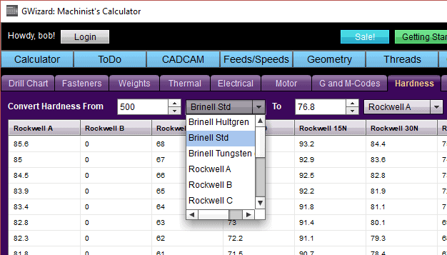

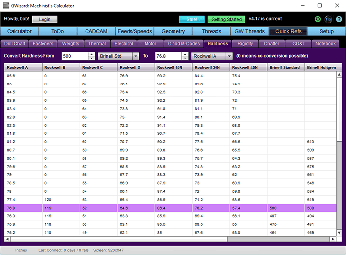

G-Wizard Hardness Conversion Charts & Calculator
Our G-Wizard Calculator software includes a hardness conversion calculator because it has a full set of hardness conversion charts and a calculator built right in on the “Quick Refs” tab:
Hardness conversion calculator for Rockwell, Brinell, Vickers, Shore Scleroscope, and Tensile Strength…
The Hardness Conversion Calculator is particularly handy. Enter a from value, select the from units, enter the “to” units, and G-Wizard will give you a value (if there is one) in the new hardness units. Here’s a closeup of the unit selector:

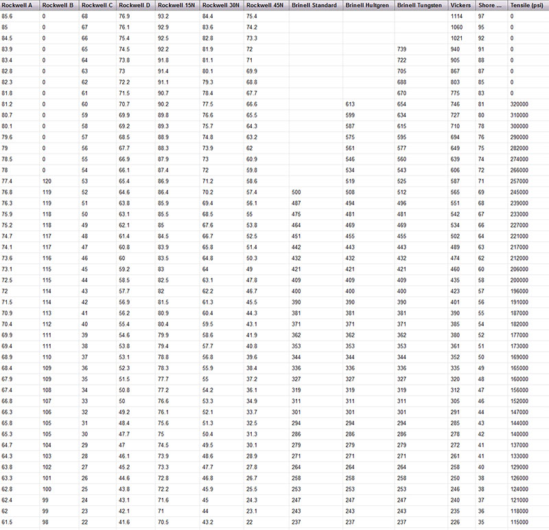

Hardness Conversion Charts and Tables
Rockwell A | Rockwell B | Rockwell C | Rockwell D | Rockwell 15-N | Rockwell 30-N | Rockwell 45-N | Brinell Std | Brinell Hultgren | Brinell Tungsten | Vickers | Shore Sclero-Scope | Approx Tensile Strength (psi) |
85.6 | 68 | 76.9 | 93.2 | 84.4 | 75.4 | 1114 | 97 | |||||
85 | 67 | 76.1 | 92.9 | 83.6 | 74.2 | 1060 | 95 | |||||
84.5 | 66 | 75.4 | 92.5 | 82.8 | 73.3 | 1021 | 92 | |||||
83.9 | 65 | 74.5 | 92.2 | 81.9 | 72 | 739 | 940 | 91 | ||||
83.4 | 64 | 73.8 | 91.8 | 81.1 | 71 | 722 | 905 | 88 | ||||
82.8 | 63 | 73 | 91.4 | 80.1 | 69.9 | 705 | 867 | 87 | ||||
82.3 | 62 | 72.2 | 91.1 | 79.3 | 68.8 | 688 | 803 | 85 | ||||
81.8 | 61 | 71.5 | 90.7 | 78.4 | 67.7 | 670 | 775 | 83 | ||||
81.2 | 60 | 70.7 | 90.2 | 77.5 | 66.6 | 613 | 654 | 746 | 81 | 320000 | ||
80.7 | 59 | 69.9 | 89.8 | 76.6 | 65.5 | 599 | 634 | 727 | 80 | 310000 | ||
80.1 | 58 | 69.2 | 89.3 | 75.7 | 64.3 | 587 | 615 | 710 | 78 | 300000 | ||
79.6 | 57 | 68.5 | 88.9 | 74.8 | 63.2 | 575 | 595 | 694 | 76 | 290000 | ||
79 | 56 | 67.7 | 88.3 | 73.9 | 62 | 561 | 577 | 649 | 75 | 282000 | ||
78.5 | 55 | 66.9 | 87.9 | 73 | 60.9 | 546 | 560 | 639 | 74 | 274000 | ||
78 | 54 | 66.1 | 87.4 | 72 | 59.8 | 534 | 543 | 606 | 72 | 266000 | ||
77.4 | 120 | 53 | 65.4 | 86.9 | 71.2 | 58.6 | 519 | 525 | 587 | 71 | 257000 | |
76.8 | 119 | 52 | 64.6 | 86.4 | 70.2 | 57.4 | 500 | 508 | 512 | 565 | 69 | 245000 |
76.3 | 119 | 51 | 63.8 | 85.9 | 69.4 | 56.1 | 487 | 494 | 496 | 551 | 68 | 239000 |
75.9 | 118 | 50 | 63.1 | 85.5 | 68.5 | 55 | 475 | 481 | 481 | 542 | 67 | 233000 |
75.2 | 118 | 49 | 62.1 | 85 | 67.6 | 53.8 | 464 | 469 | 469 | 534 | 66 | 227000 |
74.7 | 117 | 48 | 61.4 | 84.5 | 66.7 | 52.5 | 451 | 455 | 455 | 502 | 64 | 221000 |
74.1 | 117 | 47 | 60.8 | 83.9 | 65.8 | 51.4 | 442 | 443 | 443 | 489 | 63 | 217000 |
73.6 | 116 | 46 | 60 | 83.5 | 64.8 | 50.3 | 432 | 432 | 432 | 474 | 62 | 212000 |
73.1 | 115 | 45 | 59.2 | 83 | 64 | 49 | 421 | 421 | 421 | 460 | 60 | 206000 |
72.5 | 115 | 44 | 58.5 | 82.5 | 63.1 | 47.8 | 409 | 409 | 409 | 435 | 58 | 200000 |
72 | 114 | 43 | 57.7 | 82 | 62.2 | 46.7 | 400 | 400 | 400 | 423 | 57 | 196000 |
71.5 | 114 | 42 | 56.9 | 81.5 | 61.3 | 45.5 | 390 | 390 | 390 | 401 | 56 | 191000 |
70.9 | 113 | 41 | 56.2 | 80.9 | 60.4 | 44.3 | 381 | 381 | 381 | 390 | 55 | 187000 |
70.4 | 112 | 40 | 55.4 | 80.4 | 59.5 | 43.1 | 371 | 371 | 371 | 385 | 54 | 182000 |
69.9 | 111 | 39 | 54.6 | 79.9 | 58.6 | 41.9 | 362 | 362 | 362 | 380 | 52 | 177000 |
69.4 | 111 | 38 | 53.8 | 79.4 | 57.7 | 40.8 | 353 | 353 | 353 | 361 | 51 | 173000 |
68.9 | 110 | 37 | 53.1 | 78.8 | 56.8 | 39.6 | 344 | 344 | 344 | 352 | 50 | 169000 |
68.4 | 109 | 36 | 52.3 | 78.3 | 55.9 | 38.4 | 336 | 336 | 336 | 335 | 49 | 165000 |
67.9 | 109 | 35 | 51.5 | 77.7 | 55 | 37.2 | 327 | 327 | 327 | 320 | 48 | 160000 |
67.4 | 108 | 34 | 50.8 | 77.2 | 54.2 | 36.1 | 319 | 319 | 319 | 312 | 47 | 156000 |
66.8 | 107 | 33 | 50 | 76.6 | 53.3 | 34.9 | 311 | 311 | 311 | 305 | 46 | 152000 |
66.3 | 106 | 32 | 49.2 | 76.1 | 52.1 | 33.7 | 301 | 301 | 301 | 291 | 44 | 147000 |
65.8 | 105 | 31 | 48.4 | 75.6 | 51.3 | 32.5 | 294 | 294 | 294 | 285 | 43 | 144000 |
65.3 | 105 | 30 | 47.7 | 75 | 50.4 | 31.3 | 286 | 286 | 286 | 278 | 42 | 140000 |
64.7 | 104 | 29 | 47 | 74.5 | 49.5 | 30.1 | 279 | 279 | 279 | 272 | 41 | 137000 |
64.3 | 103 | 28 | 46.1 | 73.9 | 48.6 | 28.9 | 271 | 271 | 271 | 261 | 41 | 133000 |
63.8 | 102 | 27 | 45.2 | 73.3 | 47.7 | 27.8 | 264 | 264 | 264 | 258 | 40 | 129000 |
63.3 | 101 | 26 | 44.6 | 72.8 | 46.8 | 26.7 | 258 | 258 | 258 | 250 | 38 | 126000 |
62.8 | 100 | 25 | 43.8 | 72.2 | 45.9 | 25.5 | 253 | 253 | 253 | 246 | 38 | 124000 |
62.4 | 99 | 24 | 43.1 | 71.6 | 45 | 24.3 | 247 | 247 | 247 | 240 | 37 | 121000 |
62 | 99 | 23 | 42.1 | 71 | 44 | 23.1 | 243 | 243 | 243 | 235 | 36 | 118000 |
61.5 | 98 | 22 | 41.6 | 70.5 | 43.2 | 22 | 237 | 237 | 237 | 226 | 35 | 115000
