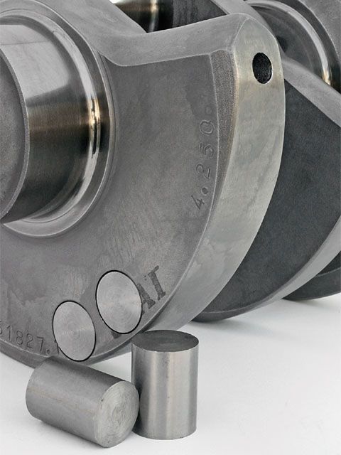

Although machining this material is challenging, there are many other important uses for Tungsten and its alloys such as these types of tungsten parts:
Crankshaft bearing cap and connecting rod bushings in machining context.
Tungsten weights inserted in crankshaft for balancing...

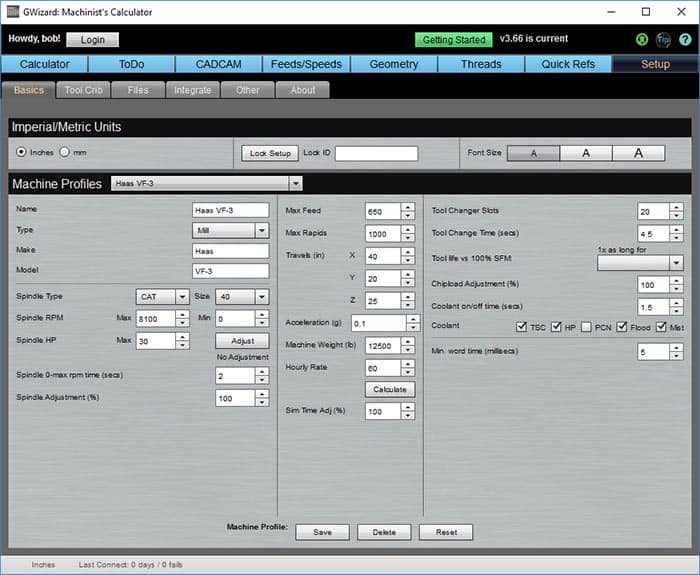

Our G-Wizard Feeds and Speeds Calculator is fully calibrated for Tungsten and includes multiple alloys in its Material Database.
