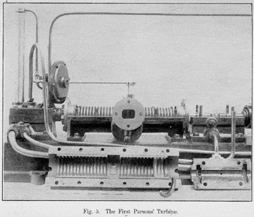

The first modern steam turbine was invented in 1884 by Englishman Charles A. Parsons:
Parson’s First Turbine…

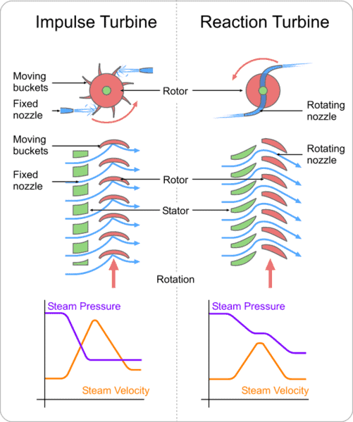

There are two kinds of turbine, the impulse and reaction varieties:
Two kinds of Steam Turbine. Most models will be “impulse” turbines…
Most models will be of the impulse variety due to the difficulties of producing the complex curves for a reaction turbine. Most commercial turbines are reaction. With an impulse turbine, steam velocity is everything, but there are tradeoffs. An air powered engine will generate the most velocity with a converging nozzle such as is described on the three rotor turbine below. However, steam is heated and can expand. In that case, providing more volume just before injection to the rotor blades converts as much heat as possible to velocity. So, a diverging nozzle (such as the “trumpet” nozzle on de Laval’s turbine below) works better there.

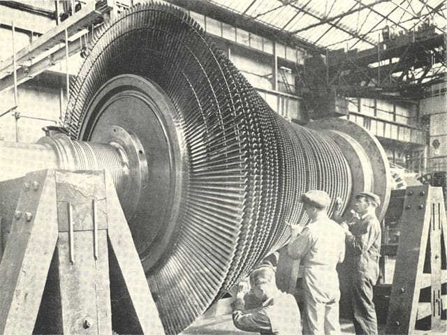

In fact, it is the use of multiple stages and more gradual steam expansion among the stages that leads to the greater efficiency at slower speeds of Parson’s design. The different diameters at each stage are what allow for expansion on this 70,000 HP steam turbine rotor:
Increasing rotor diameters allow for steam expansion…
Here is a rotor from Parson’s first turbine:
Straight bladed rotor must have been difficult to construct without CNC!
The blades were made of drawn brass. Each blade was fitted into a groove with a wedge, called a “distance” piece in the drawing. Here is some more on the labyrinth passages that connect each stage:

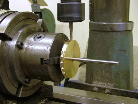

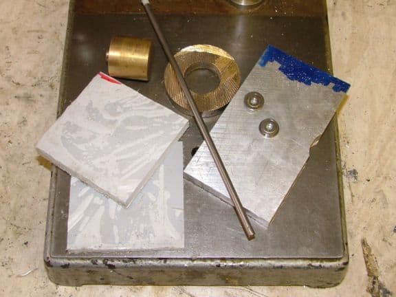

Raw materials, and machining the “buckets” on the rotor…

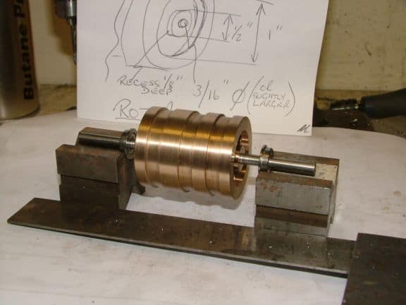

Sketch. Note how the leftmost rotor is a reversing rotor, so the “buckets” go the other way?

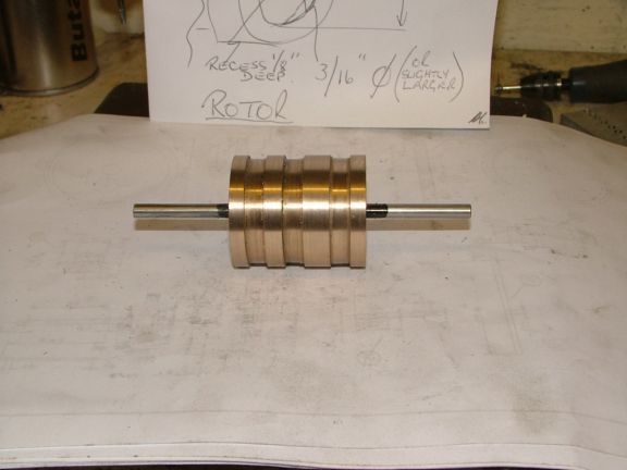

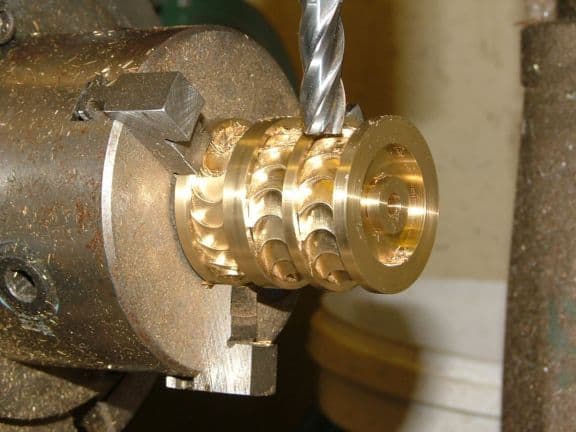

Turning the basic shape in phosphor bronze

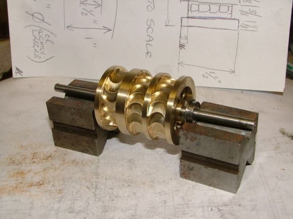

Rotor stack is drilled to lighten it…
Areas in green on the shaft are knurled to hold the shaft and rotor together…
With the shaft press fitted, skim cuts are taken to ensure balance relative to the shaft…

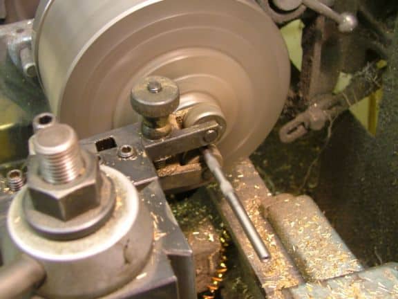

Now the buckets are being cut. It comes out looking quite exotic and beautiful, no?

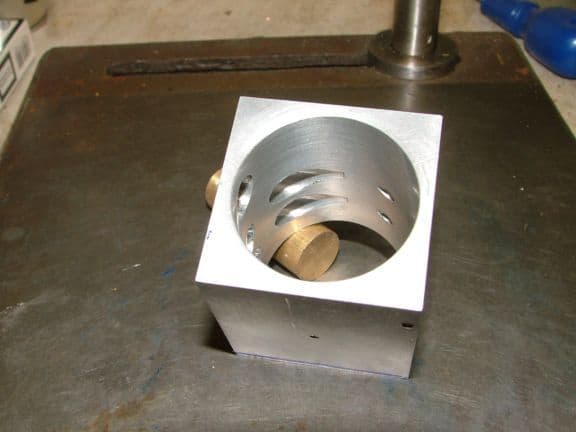

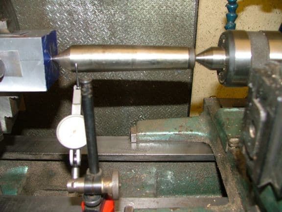

A squared block is placed in the lathe and aligned with the pump center…
First the big drill bits, then boring. Here is a trick if you don’t keep your boring bars all in holders. Use a regular tool that is known to be set correctly to center to mark the workpiece…
Now line up your bar on that mark. Clever!
Rotor assembly fits just right after boring. Note the balancing holes on that rotor.

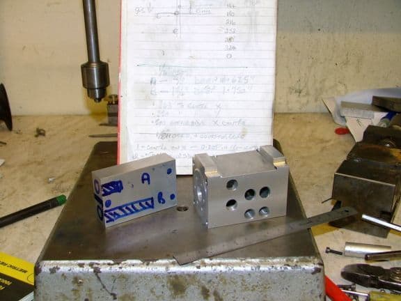

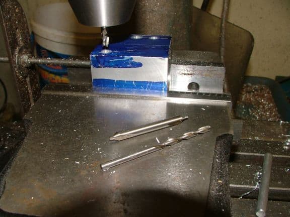

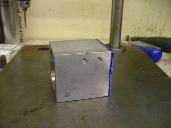

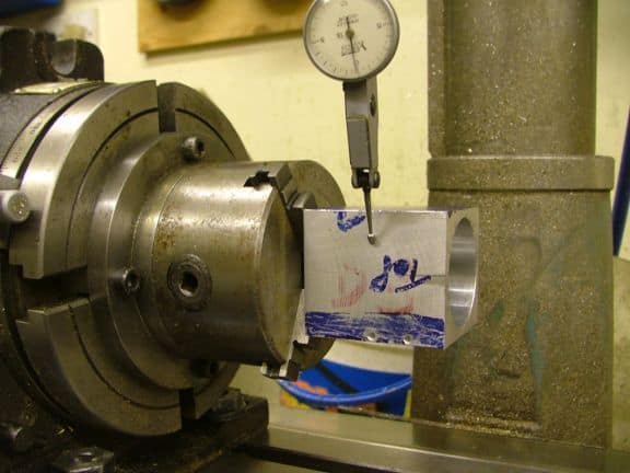

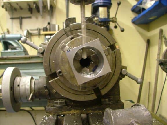

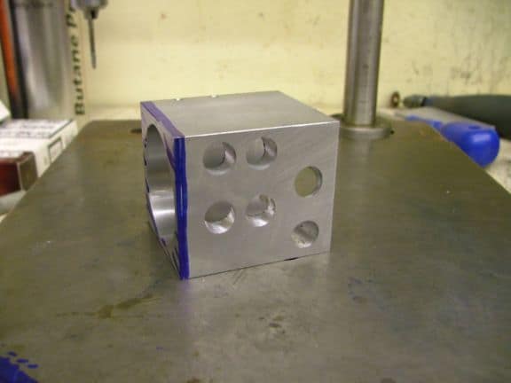

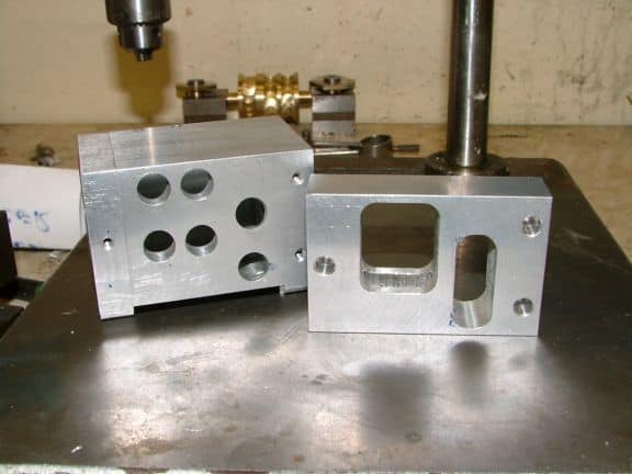

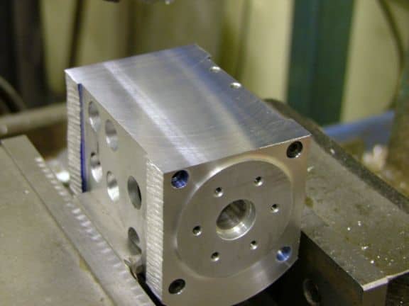

Nozzle holes are 1/8″ followed by a 3/16″ endmill to countersink an area for the connector to seat in. Next is the dividing head work. The face marked “top” was aligned along the rotational axis with a machinists square. The dial indicator is swept to be sure the axis is parallel to the mill’s X-axis…
Now the mill is lined up on the original holes, the table is moved 3/8″, and the head is rotated 20 degrees to achieve the correct tangential angle for the inlet port….

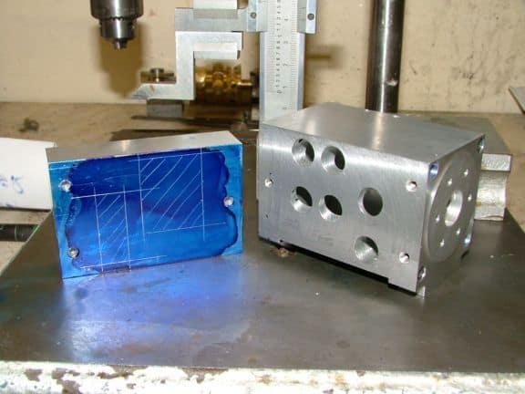

Here are the exhaust ports, which are much larger than the inlets to keep back pressure down…

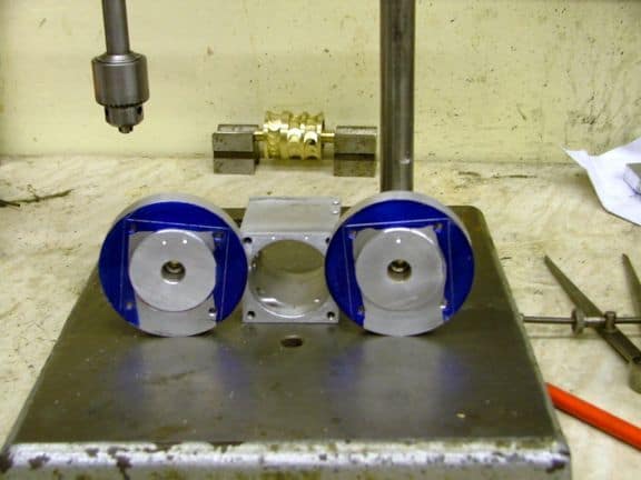

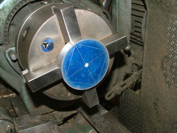

Next up are the endcaps. The housing is scribed to the endcap material and then a circle is drawn around with a dividers…
The endcaps are trimmed close to the outline on the bandsaw to save too much interrupted cutting on the lathe…
Watch this interesting trick to secure the workpiece. First, masking tape on the back side of the workpieces provides some friction with the chuck. Put a piece of stock in the jaws large enough so that when the jaws are tightened on it they are slightly smaller than the OD of the workpiece…
Now trap the workpiece against the chuck with a live center and you’re ready to go! This is another reason Bog avoided a nasty interrupted cut: that masking tape only provides so much friction!

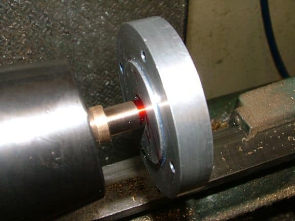

End pieces are close. About 1/8″ too thick. Next up is machining the bearing pockets. This is done with softjaws on the 4-jaw chuck (this one is self-centering, an independent jaw wouldn’t need the soft jaws) to make it as accurate as possible.

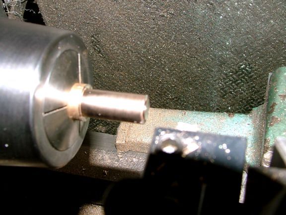

Bearing fit is good, so the workpiece is flipped and now a spigot is turned that will be a “wringing” fit to the bore…
The wringing fit is good and things are starting to take shape…

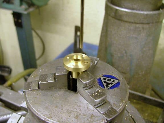

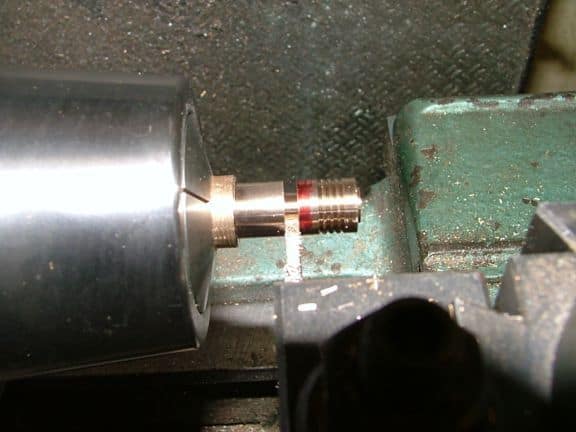

Next step are the bearing caps. Round insert tool makes a pretty radius…
Parted off and you can see how they look…
They need to be the same thickness, so the difference is measured on the surface plate…
And they’re faced off in the collet chuck…
Bearing pockets cut…
Trial fit looks good. Here is the hardware to mount the end caps and bearing caps…

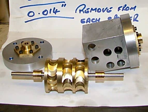

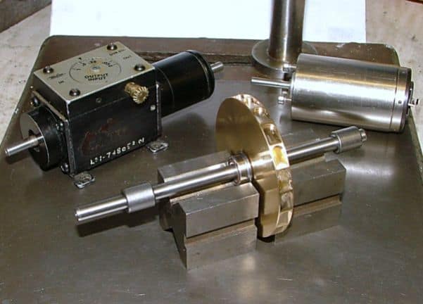

These are the rotor spacers. These are set up with 0.002″ clearance at either end to allow for thermal expansion…

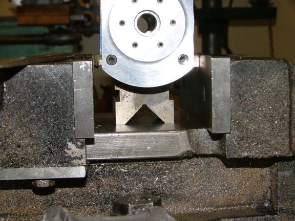

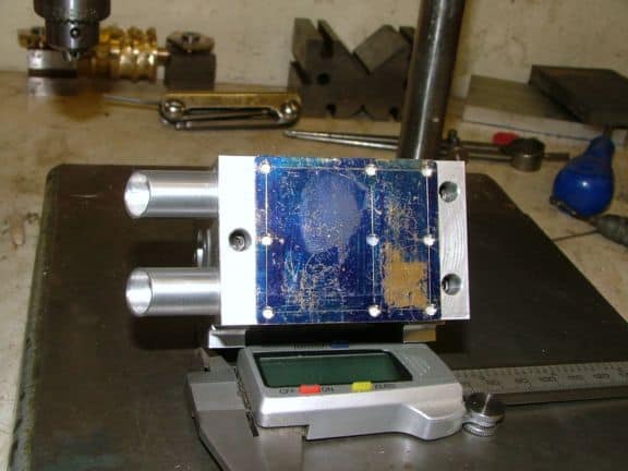

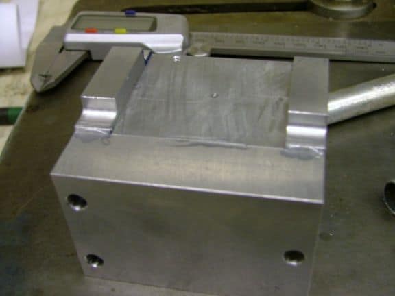

Time to modify the end plates some more. First they’re marked off on the inside (where it won’t show!). Then the outside gets a final facing to get rid of the old scribe marks and leave a nice blingey finish. This creates a nifty boss for appearance sake.
The Bogstandard wacks off the sides in the bandsaw. I keep thinking, why didn’t he do more work in the mill and start out with a square piece, but I suppose he wanted the accuracy and finer finish of the lathe…

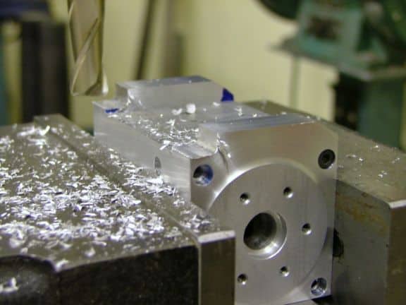

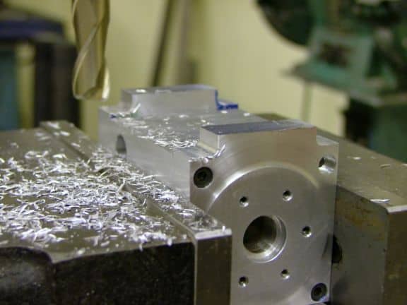

A nice flycut makes it look all better. In fact, it very nearly looks like a single block of metal there…
More cleanup, and a slightly radiused end mill result in mounting blocks…
Doesn’t the result look sweet? Needs a shot of brake cleaner to get rid of the remaining blue in the holes…

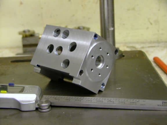

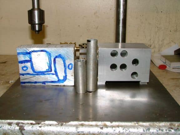

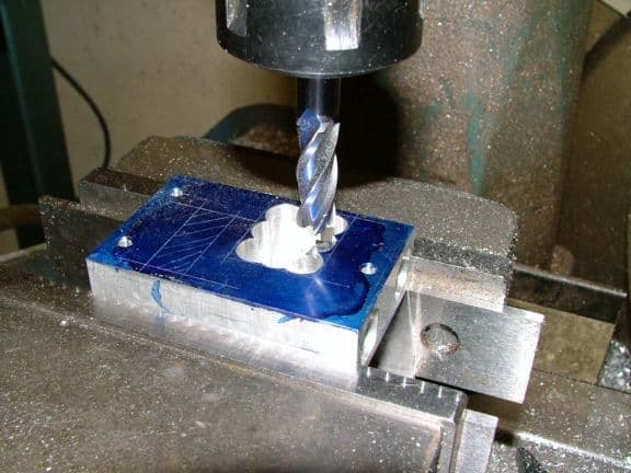

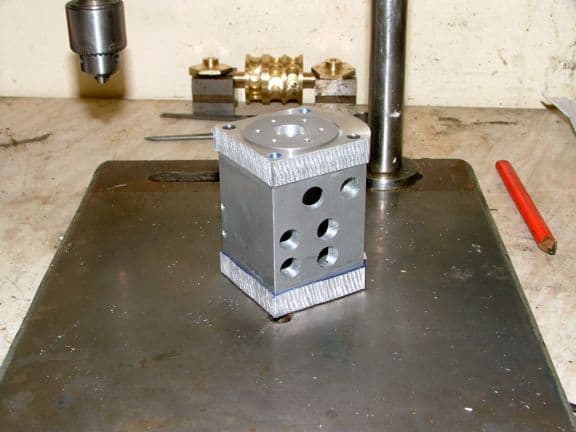

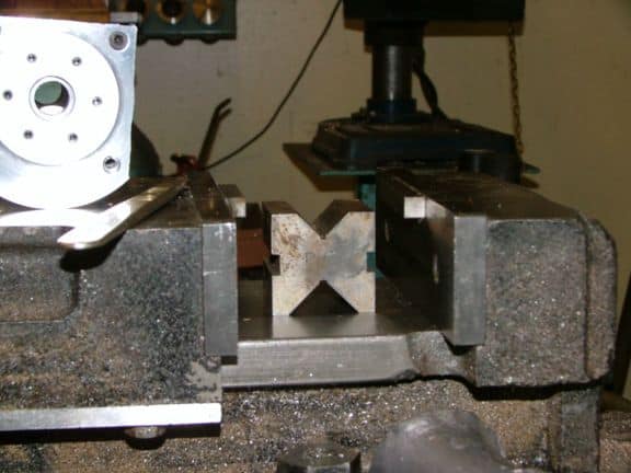

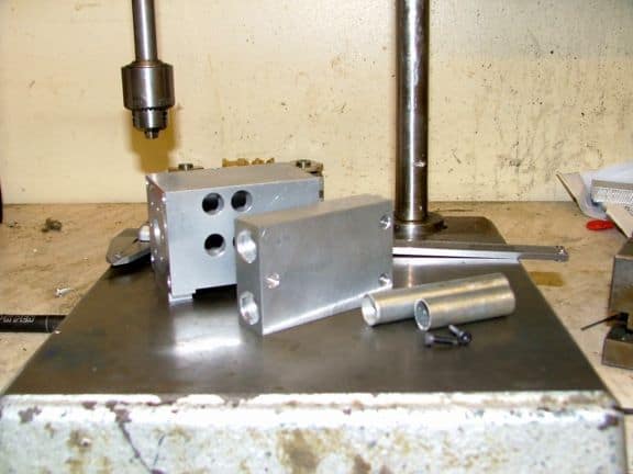

Now the exhaust manifold is a somewhat complex part…
Plunge cuts for the pocket. Bog was at pains to machine without damaging the parallels. A better solution would be a set of softjaws with a step in the vise…
Woohoo, looking good with those big exhaust pipes! The blued piece is a brass plate: more bling!
Holes are carefully drilled while the plate is held in place with double sided tape…

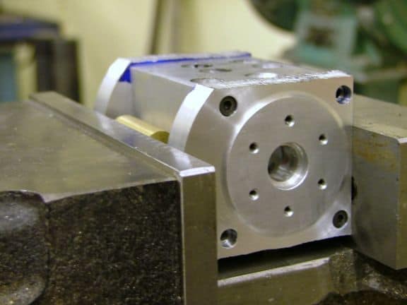

Sketches for the control valve…
Housing is turned to size, parted, and inserted in the collet block for edge finding…
3 Holes are drilled and then it’s back to the lathe for boring. Hmmm, why not bore first? I guess it keeps burrs out of the bore…

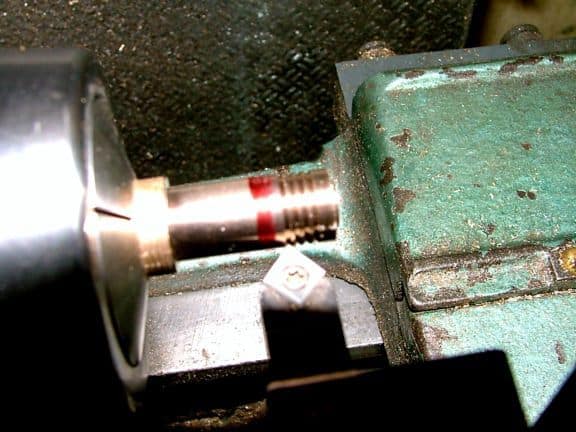

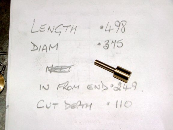

Checking the spool fit.
A precision drill blank rod held in place with a wooden wedge allows indication relative to the holes. A straight piece in the drill chuck locates the center hole to 0.002″ under the lathe axis. I’d be using my Blake Coax for that, but I don’t think Bog’s mill has that much Z room…
Final dial in to clean up that 0.002 and the mounting holes can be drilled…

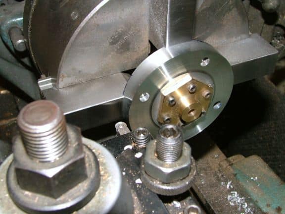

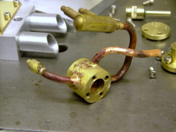

Groove on either side to join passages….
A bit of dry fit up and it’s time for the silver solder…
Comes out all blotchy, but it can be cleaned up quickly with a little Scotchbrite pad…
A marble makes an excellent control knob for the valve!
