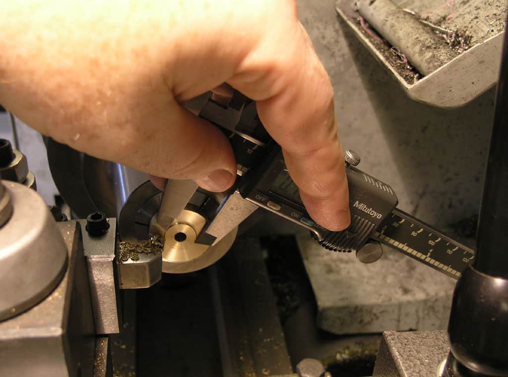

Next up: cutting the shoulder for the hub. This will be a little facing cut that doesn’t go all the way to the center. To start, go back and just touch the cutter to the face gently…
Zero your compound DRO. What’s that, no compound DRO? Well, I made mine just for this project, but I can tell I’ll use it a lot!
Pull the cutter back with the cross slide dial and set the depth of cut with the compound. I want a 0.156″ shoulder, so I dial that in as best I can on the compound…
The first time through, I stopped a couple of times and checked with the digital calipers to see what the diameter of the hub was…
After that first time, I knew what the cross slide dial should read (“50” for this part). You can tell by looking which revolution to stop at that dial number on. Goes really fast that way!

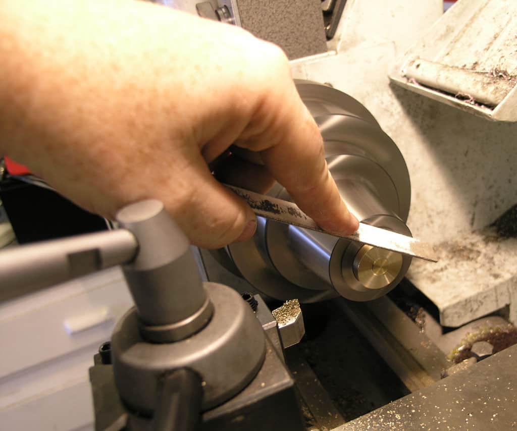

Deburr With File
Forgot to take a picture, but the last step before removing any part from the collet is a little deburr with a file. The reason is so that when you flip the part around there is no burr to interfere with the accuracy of the collet.
That part is ready to be removed…

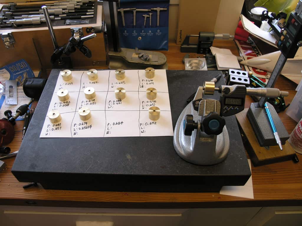

Here’s my little inspection area on the surface plate. I’m measuring each part’s width with the mic and noting under the “P”. It should be 0.6562″, so the difference tells me how much to take off when facing…

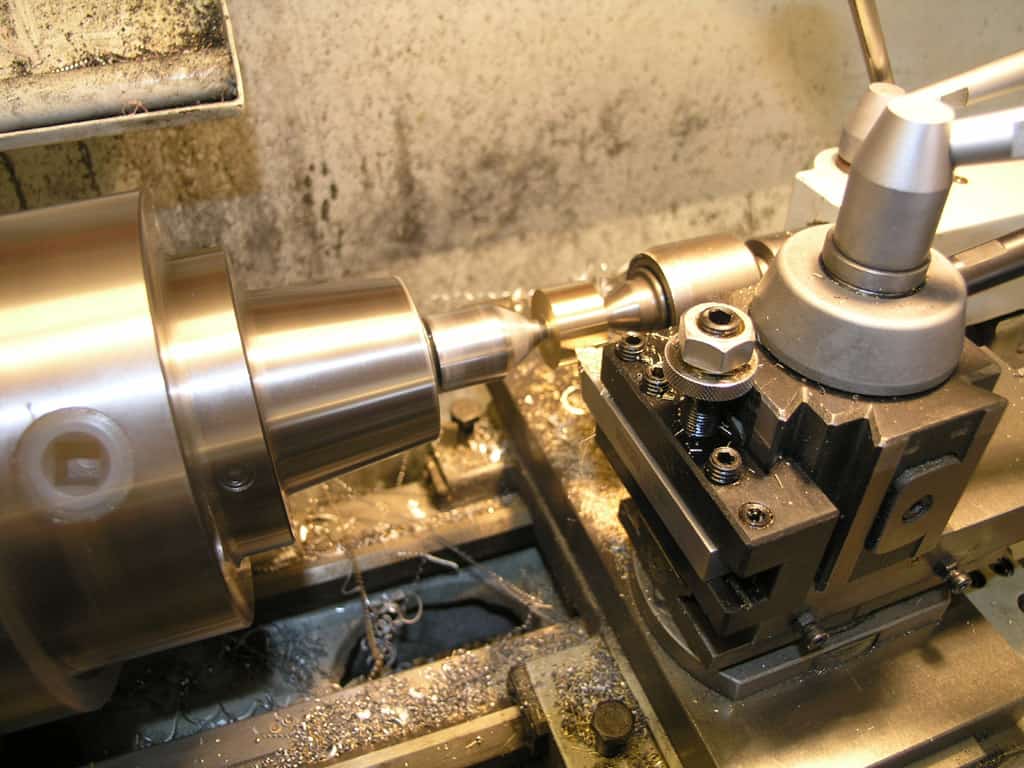

Turning Brass to 1.000″ and Polishing
I started out by sticking the brass stock in my 6-jaw and putting a quick center drill hole there for the tailstock. Boy, I sure like having a keyless chuck and a tailstock cam lock to make stuff like this go really fast!
What the heck is going on here??? That rig is called a “Constant Face Turning” setting. Sometimes just “Face Turning”. The stock is held by my favorite Royal live center in the tailstock, and driven by a special center on the spindle that is hydraulically sprung against the stock and is equipped with teeth that give it traction on the stock. I found it on eBay for $75, a cheap Asian knock off of a type of tooling that costs big bucks for the pro stuff and is regularly used with CNC. You know me: I love gadgets! This one is really much nicer than fooling around with lathe dogs to drive the work. You get access to the full length this way. Here’s another view of the face turning rig stopped from my vise stop project:
Another view of the constant face turning head…
I’m doing several experiments on the project. For example, I start out turning with my CCMT turning tools until I get things into reasonable shape. Also, I wanted to see how close I could come to holding 1″ along the entire 8″ length of this brass cylinder by tuning up the lathe tailstock set over, and then by hand tuning the dial while the feed was in motion. Such accuracy is not needed for the flywheel, but these are experiments I like to do as I go to stay in practice or learn something new.
What I’m doing here is cutting a bit, measuring the taper with a micrometer (I have both vernier and digital and make myself use the vernier for the first 5 or 6 measurements on a project before I go to my Mitutoyo digitals. That’s just to stay in practice), and tweaking the tailstock until I got the tailstock end to be smaller than the headstock end. That’s as much as you can do adjusting the tailstock set over. When was the last time you adjusted yours?
Once I got happy with my taper adjustments, and I got the shaft a lot closer to 1″ in diameter (I was about 0.050″ over), I pulled out my HSS steel finishing cutter. It has a big radius and a sharp edge. Folks say it leaves a nicer surface finish. I think the latter is very slight compared to my CCMT’s, but it is discernable, so why not use the HSS? Isn’t it nice to cut brass? So shiny! So easy!
Okay this one is tricky. Remember I said I would tweak the dial during the feed to offset the taper? I mic’d both ends after a shallow (0.005″) cut. I determined that based on the taper I was seeing (0.003″ over 8″), I could turn the dial by eye a little less than half a division each 1/4 of the shaft length. I performed my final pass while doing so, and then mic’d the resulting 1/4 sections of the shaft. You can see my results rounded to the nearest thousandth though my mic reads to 1/10 of tenth. Not too bad. The second quadrant I was a little too aggressive and it’s 0.999″. The leftmost quadrant I was a little late and was 0.001″ too big at the end. I know exactly how both happened. On the second quadrant, I got confused about diameter versus radius (move the dial 0.001″, did diameter reduce 0.001″ or 0.002″). Things were moving too fast and I’d never tried this. I knew as soon as I’d done it I went too far. So I slowed up to try to compensate on future turns. On that 4th quadrant (leftmost), I was lagging it and hence was 0.001″ over. All in all, I rate this as not bad for a first try. As I said up front, the little flywheel doesn’t need even a thou of accuracy on its diameter. This was just a random exercise in precision to sharpen my skills and try a new technique. You’ll notice also no use of calipers! I went back with my Mitutoyo calipers and it would be easy to conclude the whole shaft was dead nuts on with them. Calipers are not precision instruments, micrometers are!

Use your file to knock the shoulder burr off before removing the part from the collet. The part wont seat accurately in a collet with that shoulder burr there after facing! I can’t tell you how many times I pulled the part out and had to put it right back in to take that burr off. Develop the habit!
Using a small chalked file to knock the shoulder burr off before removing the part from the collet…

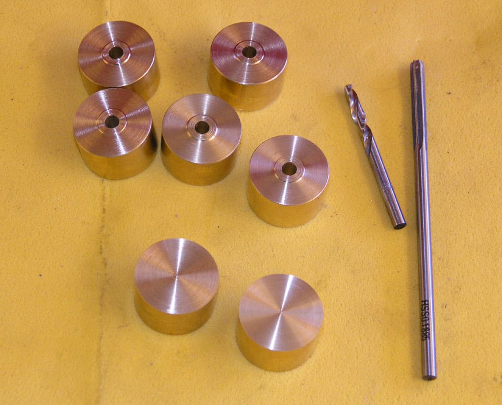

Drill and Ream the Bore
I go in with the center drill, then the twist drill, and finally the reamer to clean up the hole. This is pretty fast with my camlock tailstock and keyless chuck…
First the center drill, then the twist drill…
…and the reamer finishes up the bore…

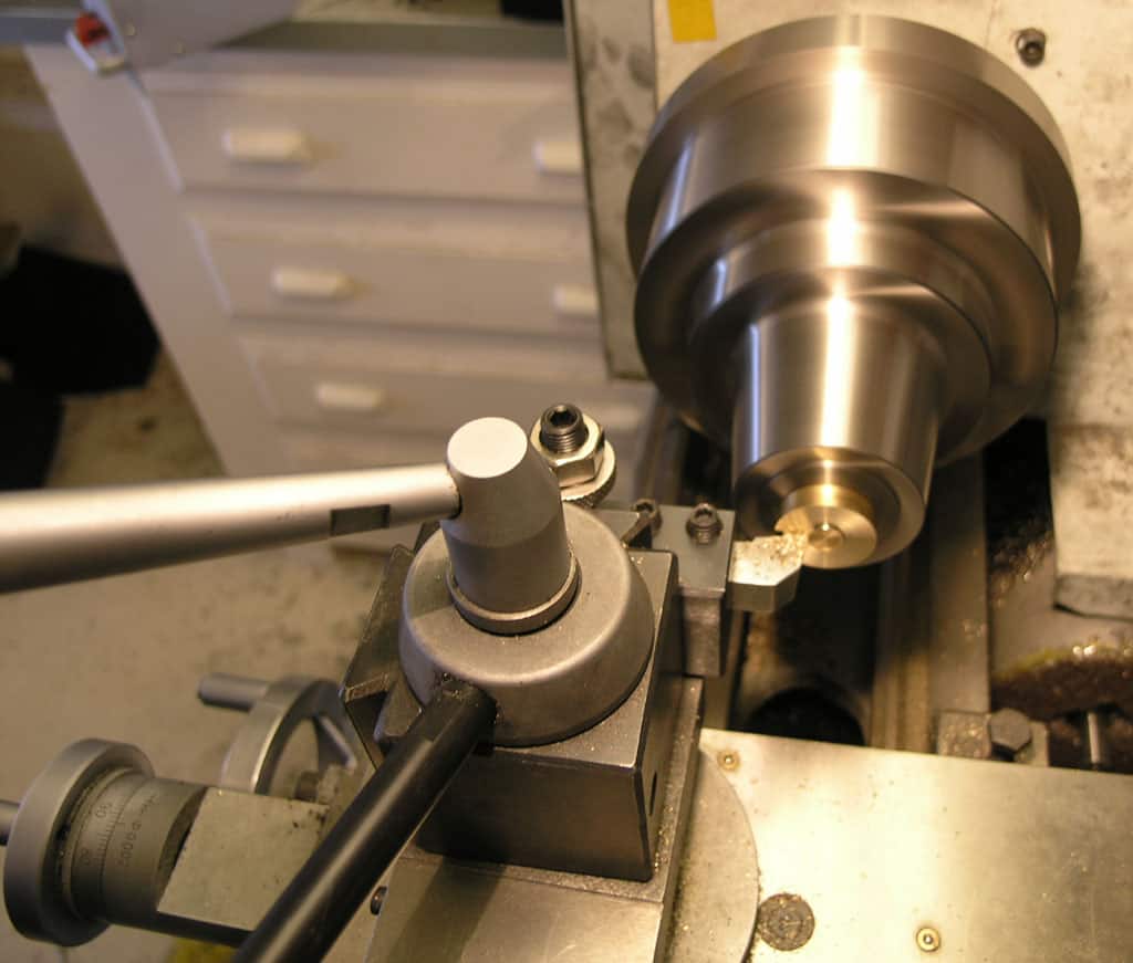

Cutting the Shoulders
To cut the shoulder, I zero the tool by touching it to the work face and zeroing this crude DRO. Then I crank the tool back out of the way and turn the compound dial until the DRO reads how much I want to take off…
I then take that cut…
I know how far to go because I used my calipers on the first one…
Then I noted where the dial should wind up when I was done with the shoulder. Fast and easy!
What We Got
