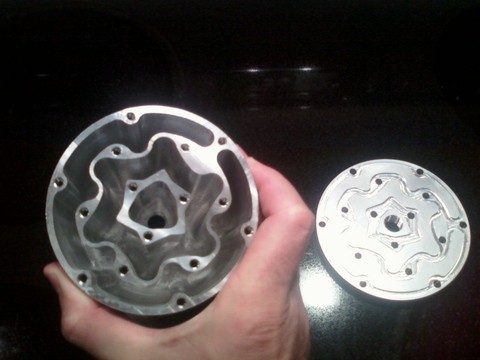

All this adds up to poor tool life, breakage, and longer cycle times. Couple all that with thin walls and you have this part Eric Tate recently showed on the Yahoo Tormach forums:
Deep pocket of 3.125″, endmill of 3/8″, and thin walls as well!
With a part like that, if the tool doesn’t chatter from the long reach the thin walls will chatter.
Tate reports taking 0.030″ depth of cut passes and 600 rpm were the secret, discovered after some trial and error experimentation and a broken endmill.
