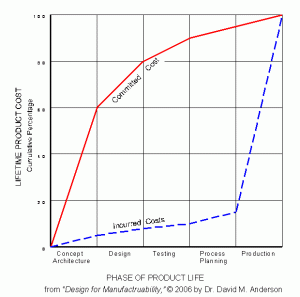

80% of the cost to manufacture a product is determined at Design Time...
In this step, we will evaluate how easy it is to manufacture our part, change the design as desired to make it easier to manufacture, and arrive at a plan for how to manufacture the part which we'll capture in our Setup Sheet Outline.

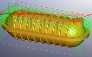

Rounded metal tank with yellowish hue and ridged surface.
Using MeshCAM to create a G-Code Part Program...
Armed with a CAD model and our Setup Sheet Outline, we're ready to dive into CAM, Conversational Programming, Hand Coding, or whatever method we want to use to create a G-Code Part Program.

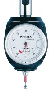

A dial indicator with a black plastic casing and white face.
Setup is where we get the CNC Machines all ready to run the part. We need to make sure it has all the right tools in the tool changer, the right gcode program loaded, and in general that the machine is ready to go.

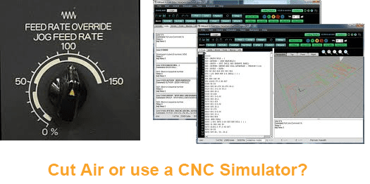

5
Program Proofing ▶
Deliverable: Program is Proven, Ready to Run the Part

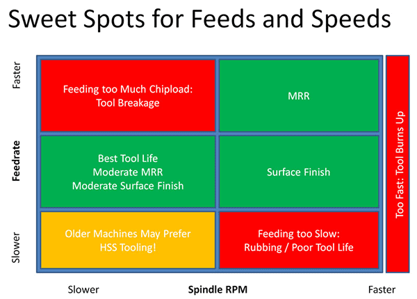

Machining feed rates comparison graph with software controls.
Proofing the program is the last step before we actually make real cuts. The goal of proofing is to verify the program is correct and the CNC machine is setup correctly so that there will be no problems when the g-code is run for the first time.  Proofing can be done either by Cutting Air (simple but very time consuming) or by using a CNC Simulator (also called a G-Code Simulator).
Click the section title to drill down and see which is better.

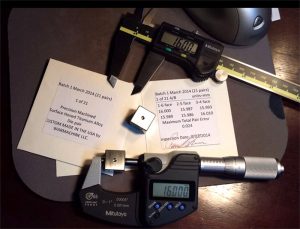

Digital caliper on wooden table with ruler and paper featuring a displayed measurement of 15.000.
Having finished the CNC machining, it's time for Quality Control. We'll inspect the parts to make sure they meet the desired specifications, tolerances, and surface finishes.  But first, most parts will need deburring.  See our article on Deburring Tools for Metal to learn more.

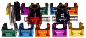

Colored metal parts in various shapes and sizes arranged on a light gray background.
Our last step involves finishing the parts. It's optional, as our parts may not require it. But, there are many forms of finishing possible ranging from paint, to anodizing, to bead blasting, and more.

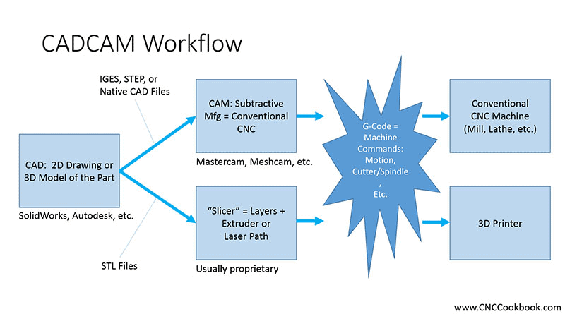

CNC Basics: The CNC Software Stack
Now you've got the Big Picture for How CNC Parts are Made.  Cool beans!  That's an awesome framework to help file away future CNC learnings and concepts.
Let's get another framework in place: The CNC Software Stack.
By "CNC Software Stack" I mean, "What are the different CNC Software packages used and how do they fit together?"
There’s a fair amount of different software that is involved when making a part with CNC.  At the very least that includes a CAD program with CAM (or perhaps Conversational CNC instead of CADCAM, but let’s start with CAM as a newbie) to generate the g-code, and your machine controller, which turns that g-code into machine motions that make your part for you.  There’s a lot of other software out there that you’ll hear about and wonder about.  It’s helpful to get a mile-wide-but-inch-deep overview of what all that software does and how it fits together.  You won’t need all of it to get started, but it’s still worth understanding it because it’ll help you understand a lot more about the workflows going from a design concept to a finished part at the software level.
To help folks understand the CNC Software Stack better, we wrote an article called CNC Software: Digital Tooling for CNC that explains all about what kinds of CNC software are available and how it all fits together.  Here’s a diagram that shows how the most important pieces of software work together:
CADCAM workflow diagram illustrating CAD to CAM conversion using software tools like SolidWorks and Mastercam.
That article gives you the overview and background.  Even better is our Beginner’s Guide to the Best CAD CAM Software.  It’s laser-focused on exactly the software Beginners need to get started.  Even better, it’s chock full of buyer’s guides, evaluation tips, learning help, and even a guide to the secret deals on the Internet that will let you buy the most popular software uber cheap.  Check it out!

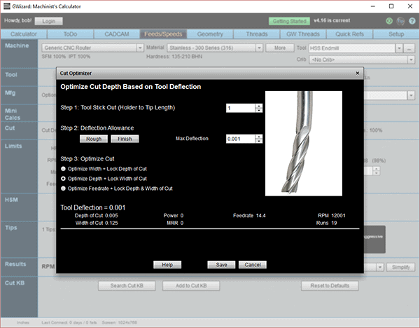

G-Wizard Calculator
Master Feeds & Speeds to Stop Breaking Tools.
CNC tool deflection calculator screenshot with customizable settings.

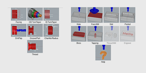

Easy Point-and-Shoot G-Code Wizards so you can skip CAD/CAM.
Machining tool 3D CAD icons
Conversational is Free with G-Wizard Editor, our g-code editor and simulator.  GW Editor can really help beginners get their arms around g-code.

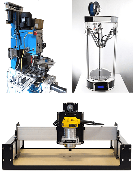

What Kind of a CNC Machine Should You Get?
Three distinct 3D printing machines in various designs and configurations.
This is an important first question to answer.  Most CNC'ers want one of 4 machines:
  1. CNC Router
  2. CNC Mill
  3. 3D Printer
  4. CNC Plasma Table
A distant fifth place might be a CNC Lathe, but let's put that on hold for a minute.  The good news is we've put together a fabulous article that walks you through it.  It considers all 4 machines and walks you through what their capabilities are, how hard they are to build, what it will cost, and so on.

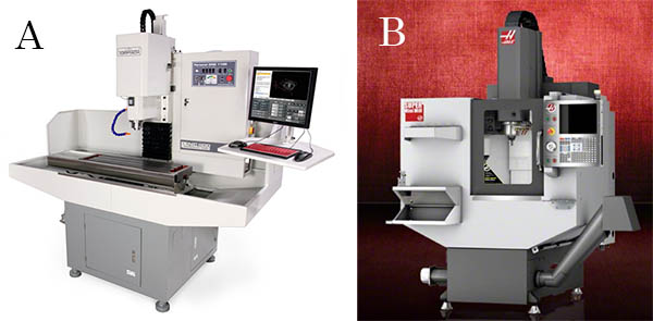

Two distinct machines: compact milling machine on white background, and elongated drill/tap machine on red background.
Which machine is better for your business, Machine A or Machine B?
We’ve all been there–pouring over machine catalogs and specifications.  This one is so cool–the spindle goes 86 zillion rpms, the rapids are faster than light speed, and the tool changer, oh my, THE TOOLCHANGER!!!
But is the biggest baddest machining center always the right choice for your business?  Or maybe you can justify an even more potent machine than the ones you are considering?  How would you know?  How can you make that decision based on logic and hard facts that will pay off in the long run?
These are questions every would-be CNC Business owner faces when they start, and if the business is successful, eventually they’ll need to revisit the question again.
To see how to figure this out objectively, with an eye towards maximizing your success, check out this article:

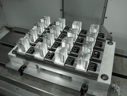

CNC Milling Machine Workholding
Silver-colored metal fixture with multiple holes in a grid pattern on a gray workshop background.
Workholding is all about how to hold your parts down for machining so they can't move or flex...
Milling Vises, Step Clamps, Fixture Plates, and all the rest. There's a plethora of workholding solutions available for mills and this article walks through them.
