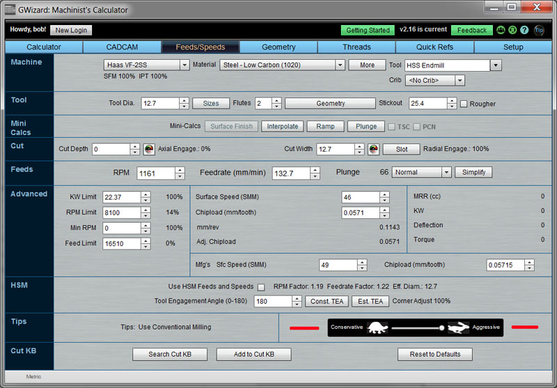

Feeds and Speeds Calculator Basics

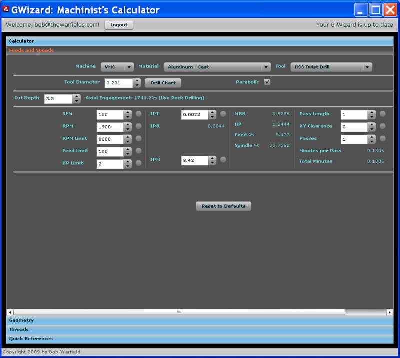

To use the Speeds And Feeds Calc is simple. Just start filling in the form from left to right, top to bottom and your answer comes out at the bottom:
G-Wizard's Feeds and Speeds Calculator...

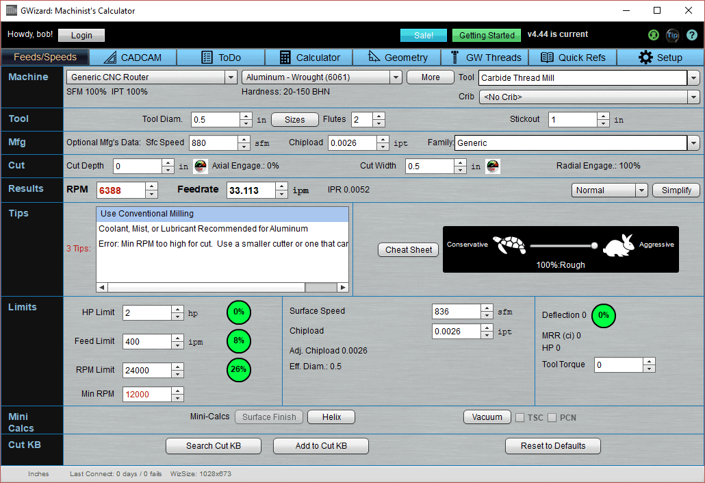

Traffic Lights & Tips With Warnings
I want to come back to this in more detail, but more now, notice the big green traffic lights scattered around. Also notice the Tips box. This is where G-WIzard will give you warnings by changing the traffic light colors or adding tips. Red on a traffic light means you've hit a limit of your machine.
In general, go ahead and enter all the values for your cut before worrying too much about the traffic lights and warnings, but make sure to come to grips with them before actually using the Feeds and Speeds. If you're going to cut with warnings or red lights, you want to be sure you know exactly what's going on and that it'll be okay.
Parameter Locking and Overrides in the Speeds And Feeds Calc
Many of the parameters sometimes have a little padlock next to them, for example there is one next to the Surface Speed parameter. The padlock only appears when the parameter has been overridden by the user. Let's say G-Wizard is recommending 400 SFM for your Surface Speed, and you think that's too fast. You can simply type "200" into that field and override the recommendation. Once you've overridden, the field stays overridden until you click the padlock, press the "Reset to Defaults" button (which resets all padlocks), or restart G-Wizard.
The little padlock indicates this RPM parameter was overridden by the user and G-Wizard is no longer calculating a value there...
Here's the thing:
Beginners shouldn't lock values. If you see a padlock, you probably don't want that.
The reason is that G-Wizard quits calculating everything upstream of the padlock. Unless you know what you're doing, locking a field and ignoring G-Wizard means it can help you. You can enter information that just plain won't work and G-WIzard will let you do it. So, unless you know exactly what you're doing when you override, it isn't recommended. Just click the padlock and it will disappear, letting G-Wizard go back to recalculating what it can.
A good rule of thumb is if you see any parameter with a padlock or that is red, make sure you know why and are comfortable leaving it that way.

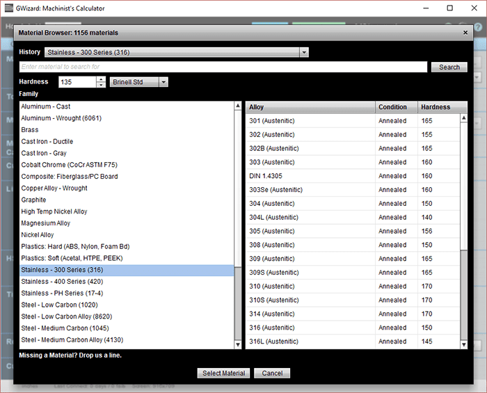

Material
The next choice is the type of material you will be cutting. G-Wizard supports the following materials:

To select a Material, we use the Material Browser. Just click the down arrow on the Material list to bring up the Material Browser:
Materials Database is organized by Family, Alloy, and Condition...
As you select families on the left, the Alloy list shows all available alloys. You can just run with the Family and no alloy selected, which causes G-Wizard to use the average alloy for the family.
History List
Many times you calculate multiple feeds and speeds for the same material. Rather than selecting it every time, use the dropdown History list to choose from your most recently used materials.
Search
Use Search to see if a word you enter is used by any of the Family + Alloy combinations. Search makes it easier to find materials in the large G-Wizard Material Database.
Hardness
If you know the Hardness of your material, it may make sense simply to choose the correct Family and enter Hardness. That's all G-Wizard needs to fine tune Feeds and Speeds.

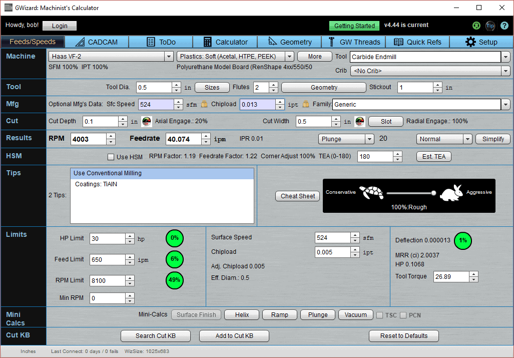

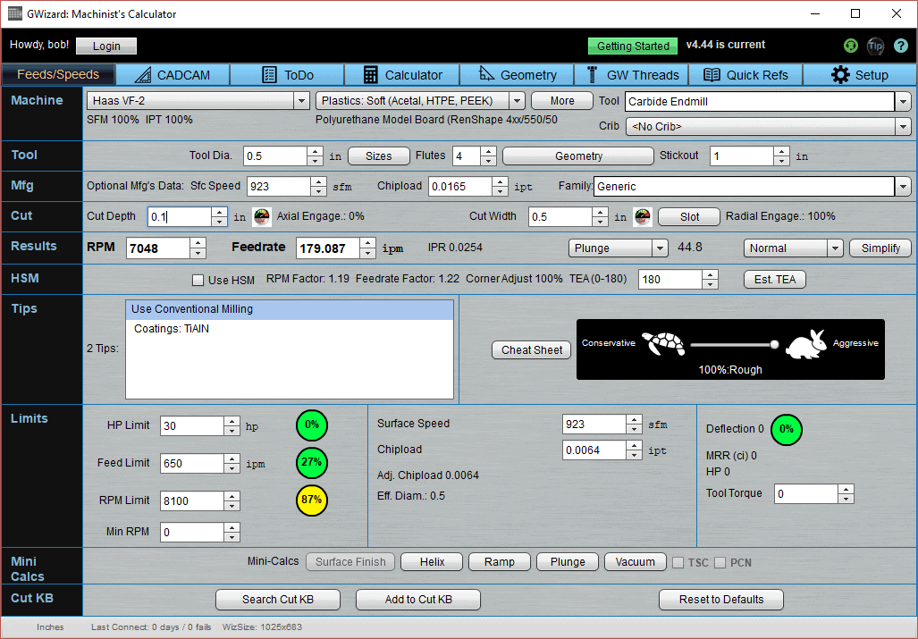

Using Manufacturer’s Recommended Feeds and Speeds
For this example, assuming you want to cut some aluminum composite foam board. Here is the description:
DIE PLANK® DP-1051 is an aluminum filled urethane Tooling Plank specifically developed as a lightweight, tough, and cost effective alternative to aluminum for abrasion-resistant applications such as checking and assembly fixtures that experience abusive production environments.

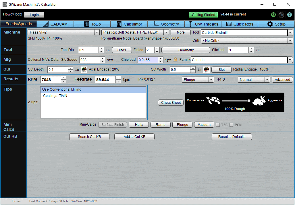

He’d been told it would cut very similarly to RenShape 4xxx, which is in the Material DB. Here is a typical cut set up for the RenShape:
Using this as a baseline, I compared it to what the manufacturer recommended for their DP-1051. They called for 4000 rpm and 40 IPM feedrate for a 1/2″ endmill. Some things to note–I specified a Cut Depth/Cut Width scenario above that doesn’t really penalize the final Feeds and Speeds too much. The manufacturer data sheet didn’t really say anything about Cut Depth/Cut Width or even (as we shall see) how many flutes on the cutter. They just gave a typical rpm and feedrate for the 1/2″ endmill.
Comparing the numbers, we can begin to see how to set things up for G-Wizard to work with DP-1051. The easiest is the Surface Speed, because it is constant for all cutter sizes. Just enter values in the “Mfg’s Sfc Speed” prompt until you match up to the rpm being recommended. In this case, 524 SFM put us where we wanted to be.
Next is the chip load. We use the same approach–enter values in Mfg’s Chipload until we can see the same feedrate. I decided to go to a 2 flute scenario, because the datasheet called out 40 IPM feed and 20 IPM plunge. Typically, plunge should be the feed divided by number of flutes, hence I went to 2 flutes. Just going to 2 flutes got us pretty close-50.8 IPM feedrate with the defaults. But, here is what I got to match the recommendation perfectly:
This matches very closely what the datasheet had called for. We could stop here, assuming we are only in need of Feeds and Speeds for 1/2″ endmills, but it’d be nicer to find a more general solution.
As I mentioned, you can use the surface speed with any size endmill, provided they’re all Carbide (or whatever endmill you’d selected), so that number is general. The chip load will change with tool diameter. Best thing to do here is to scale. Our chip load of 0.0135 IPT is actually 55% larger than the G-Wizard default value. So, whenever we want to do Feeds and Speeds for this material, we would work through everything using the default Mfg’s values. Then, we would bump surface speed to 525 SFM and increase chip load by 55%. BTW, the latter is easy to do since G-Wizard can do math in the fields. Put the cursor at the end of the number and enter “*1.55
Going to be doing this a lot?
Well, you could set up a Tool Crib entry just for endmills cutting this material. What you want is what we call a “Generic” entry. You click the Generic checkbox on the Tool Editor in the Tool Crib. This lets you type whatever sizes you want for the endmill over in the Feeds and Speeds Calculator.
Set the Mfg’s Surface Speed to 524. Leave chip load alone, but set the Chipload Compensation to be 155%. Now G-Wizard will do all the fiddling for you.
Want even easier? After you do this research, send it all over to me with links so I can verify it. Assuming all looks good, I will add it to the Materials list for G-Wizard and it’ll be built in for everyone.

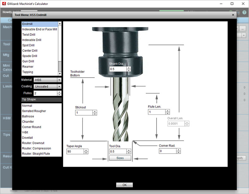

Tool
The last choice on the top row is the type of tool you will be using:
Tool Selector...
There are 2 options to select a tool:
- Use the down arrow to get a quick list of tools and geometry options:
Click the dropdown button to see the Graphical Tool Selector...
Note that G-Wizard supports a huge variety of tooling. The list will change to reflect lathe tooling if a lathe is selected.
- Alternately, to select a Tool from the Tool Crib, first select the crib with the crib menu and then the Tool Selectors will be updated to showing only the tools within that particular Tool Crib.
Note that after you select from the Tool Crib, the Tool Size and Shape Options will be greyed out. You can see what they are for the selected tool, but to change them you will have to go to the Tool Crib.
Some of the most common Tool Size and Shape options are called out in the "Tool" row:
On the Tool Row, you can specify (sometimes depending on tool type):
- Cutter diameter and number of flutes. BTW, if you double click the "in" or "mm" unit indicator, it will toggle to the other units. Handy!
- The Sizes button will let you select standard end mill and twist drill size for the cutter diameter.
- "Geometry" button tells you the currently selected geometry (e.g. "Ballnose") and will bring up the Graphical Tool Selector so you can change geometries.
- Stickout is important for Tool Deflection calculations. It is the distance from the tip of the tool to where it goes into the toolholder.

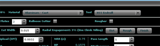

Cut Conditions: Cut Depth and Cut Width
Now you've fully specified what sort of cutter you're using, and it is time to specify the cut. Parameters relating to the cut appear on the next row down:
- Enter the cut depth and the cut width (also called stepover).

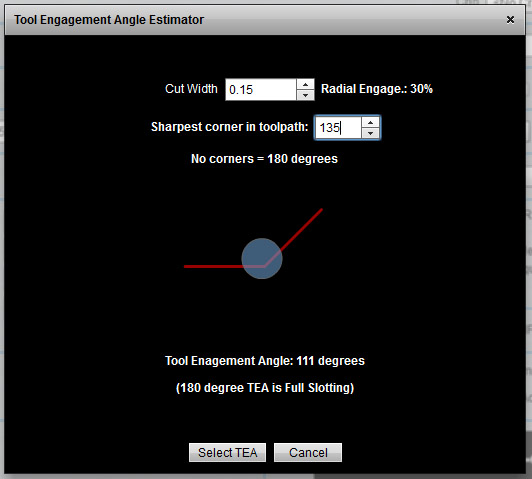

- Cut Width and Cut Depth are also expressed as a percentage of tool diameter: Axial Engagement is lengthwise along the cutter. Radial Engagement is hole diameter or slot width.
Optimizer
If you're wondering how to choose the best Cut Width and Cut Depth, welcome to the party. Many machinists are brought up on rules of thumb, trial and error, and what has worked in the past. G-Wizard introduces the Cut Optimizer to help calculate more optimal depths and widths of cut based on an analysis of tool deflection. It's possible to get much more scientific about your choice of width and depth of cut, and hence way better at choosing. But hold that thought. We're going to describe the Cut Optimizer on its own page.
Check out the Cut Optimizer after you've read through the basics of the Feeds and Speeds calculator.
The "Gas Pedal" or "Tortoise-Hare" Slider
The Gas Pedal gives you finer control over what you want to accomplish with a cut:
The Gas Pedal is at the bottom, marked in red...
The Gas Pedal is calibrated from Conservative to Aggressive in multiple steps. The conservative end emphasizes Tool Life and Surface Finish. It lowers the feedrate to just a little above where the rubbing warning would be given in the Tips area to the left of the Gas Pedal. If you go much slower, you start risking rubbing, which can shorten tool life. In the Full Tortoise conservative position, not only is feedrate limited, but the deflection allowance is reduced to be that of a finish cut. The aggressive end emphasizes Material Removal Rates. The Gas Pedal always comes up in the far right "Full Hare" roughing position.
If you're a beginner, crank the Gas Pedal over to the conservative side until you're comfortable you've come up to speed. As you get comfortable, try coming up a notch at a time when roughing.
If you're experienced, use the Gas Pedal to emphasize the difference between roughing and finishing. Or, to give a job a little more safety margin. For example, if you're down to your last cutter of a certain size and the job has to get done that day, be a little more conservative. If you want to emphasize a finer surface finish, be a little more conservative. If you are working on a job that's been going on for 2 weeks and would be expensive to start over on, be a little more conservative.

Feeds and Speeds
This is what its all about: G-Wizard has calculated your feeds and speeds by telling you the RPM and Feedrate you should be using. But, it's also gone the extra mile by telling you the feedrate to use to enter your cut.
What Feedrate Should I Use to Enter a Cut Using a Helix, Ramp, or Plunge?
Yup, CNC’ers deal with this quite a lot. For starters, which method of entry is better?
I’ve written a whole chapter in our Free Feeds and Speeds Course on Toolpath Considerations. That chapter deals with these kinds of considerations. When entering from the top, typically to cut a pocket, the order of preference is Helix, Ramp, and then Plunge.
Those preferences are based on what is gentlest on Tool Life. Where possible, you should just avoid plunge. You can’t do it unless your endmill or indexable tool is center-cutting anyway. Helix is the most gentle, and ramping is nearly as good.
Great!
Now, what Feeds and Speeds do I need for these various entries?
First thing is your rpms can stay the same–just vary the feedrate. And G-Wizard let's you select the entry method in order to calculate that new feedrate just like this:
The dropdown lets you choose your cut entry style and see the feedrate…
There’s a drop down that lets you choose whether you want to Plunge, Helix, or Ramp into the cut, and it gives feeds and speeds for the entry based on your choice.
Some things to note:
- The Helix mode assumes you’ll get to full depth in 1 turn of the helix in a diameter of 1.5x tool diameter. This is an aggressive helix which means the feedrate is pretty conservative. If you want faster, use the Helix mini-calculator (renamed from “Interpolate” to match this dropdown choice).
- The Ramp mode assumes you’ll get to full depth in the same distance as the Helix mode, so it figures the ramp length as the same length as one Helix circle. Just as for the Helix, this is an aggressive ramp and it means you could probably go a bit faster. Use the “Ramp” mini-calc to see how much if you’re in a hurry.

Advanced Cutting Parameters
There is a lot more information available to help you understand what's going on and potentially fine tune further. You can hide the additional information by pressing the "Simplify" button. Most of the time, you have everything you need already, so all that extra stuff is hidden so it won't be distracting.
Note that if you are hitting the limits of your machine in some way, there will be red traffic lights and that forces the "Simplify" mode to be turned off so you can see the problems.
Simplified View. Switch to advanced view with the Advanced button in the Feeds row...
Full view with advanced cutting parameter information in the "Limits" area...
The first column in this section is related to your machine limits. They're set up based on which machine you have selected. You can override them here, or you can set up a machine profile in the Setup Tab that matches your machine. Here is what you'll find in this column:
- HP Limit: The maximum number of horsepower for your spindle motor. Note that not all spindles can make their full horsepower at all rpms even though G-Wizard assumes they will! When a cut is specified that would exceed the HP Limit, G-Wizard scales back the feedrate until the operation is within the HP Limit specified.
- RPM Limit: That maximum RPM your spindle is limited to.
- Spindle %: The percentage of the available rpm you are using.
- Feed Limit: The maximum feedrate your machine can manage.
- Feed %: The percentage of the available feedrate you are using.
Keep in mind, not all machines can offer their full HP over the entire RPM range. You may need to be conservative about approaching your machine's HP limit. I "derate" my HP by specifying a little less in the machine profile. Also, some machines become less accurate at higher feedrates, and should only use the higher feedrates for rapids. So you may want to derate the feedrate as well.
Cutting Parameters Column
The second column in this section is related to a deeper analysis of the cutting parameters:
- Surface Speed (SFM or SMM in Metric): This is a measure of how fast the tool is moving relative to the material being cut. SFM is "Surface Feet per Minute" and "SMM is Surface Meters per Minute". If the tool were a wheel rolling along the workpiece, that's how fast it would be rolling. SFM is largely what determines tool life. If you exceed the recommended SFM, you will wear out the tool much faster. If you run more slowly than recommended SFM, you may extend the tool life.
- IPT: Inches Per Tooth, also called Chipload. For metric, this is mm per tooth. To maximize tool life, cut as close to the recommended chip load as possible without going over. Exceeding the chip load will eventually break the tool. Excessive SFM burns or wears out the tool, excessive chip load breaks the tool.
- IPR: Inches per revolution, or mm per revolution for metric. During the time it takes for the spindle to make one revolution, this how far the workpiece must move relative to the spindle to maintain the chip load given the number of cutting flutes on the tool.
- Chip Thinning and AFPT: That business of "Chip Thinning" and "AFPT" on the mill cutter screens is a High Speed Machining concept, but it matters no matter what speed you are machining at. When you use less than half of the total cutter diameter for your radial engagement, it turns out you're not cutting full chip thickness. Hence the chip is "thinned". The idea behind these settings is to bump up the feed rate until you're cutting full thickness chips again. Use the "Chip Thinning" checkbox to turn this on and off. "AFPT" is the actual chip thickness if you weren't using a chip thinning feedrate. Remember, cutting a chip that is too thin will prematurely wear your cutter. Try to approach the recommended chip loads by bumping up your feed. Chip Thinning and AFPT also come into play if you are using a high lead angle cutter. Similar geometric effects make the high lead angle (I don't know why 45 is a "high" lead angle and 90 is not!) cutters require more feed to maintain the recommended chip load.

When to Climb Versus Conventional Mill
Many CNC'ers are brought up on the notion that you should always Climb mill because it leaves a better surface finish, requires less energy, and is less likely to deflect the cutter. Conversely, manual machinists are often taught never to climb mill because it's dangerous to do on a machine that has backlash. The truth is somewhere in the middle. ABTools, makers of the popular AlumaHog and ShearHog cutters, point out some worthwhile rules of thumb:
- One cutting half the cutter diameter or less, you should definitely climb mill (assuming your machine has low or no backlash and it is safe to do so!).
- Up to 3/4 of the cutter diameter, it doesn't matter which way you cut.
- When cutting from 3/4 to 1x the cutter diameter, you should prefer conventional milling.
The reason is that cutter geometry forces the equivalent of negative rake cutting for those heavy 3/4 to 1x diameter cuts. It seems that Dapra corporation first discussed this phenomenon way back in 1971. G-Wizard now reminds you with a little hint which one you should prefer:
Just to the right of Radial Engagement it says, "Use Climb Milling"...
If you choose to climb mill, do make sure your machine is up to it from the standpoint of having low or no backlash, lest your cutter dig in and suddenly jump very deeply into the cut due to the backlash.
