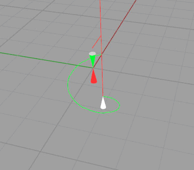

Chapter 2: Interpolated Holes (aka Helical Interpolation, Helical Milling, & Hole Milling)
If you've been around CNC for long at all, you will have seen Helical Milling, Interpolated Holes, or Hole Milling as it is variously called.  Basically, that's where an endmill follows a spiral or circular pattern to cut a hole larger than the endmill.
Gray grid background with green line, red lines, and white and red cones on a 3D CAD screenshot.
One of the great advantages of CNC over manual machining is the ability to create holes of almost arbitrary size using an end mill that follows a helical path.  And this is one of the cases where an end mill can win over a twist drill when hole making.  Twist drills can remove material faster than end mills, all other things being equal.  But, the end mill has three major advantages over a twist drill:
  1. One size of endmill can make an almost infinite number of hole diameters, provided they're the same size or larger than the endmill.  This will save tool changes, free up slots on the toolchanger, and generally be efficient.  Save the twist drills for jobs that have very few hole sizes, or a whole ton of holes that are the same size.
  2. The end mill can make flat bottom holes.  You can get special twist drills for flat bottom holes, but generally, the end is pointed and the hole bottom isn't flat with twist drills.
  3. Interpolating a hole takes longer, but it consumes less power than twist drilling an equivalent sized hole.  In other words, you can make large holes that your CNC Machine's spindle is otherwise not capable of because it isn't powerful enough.  Also, end mills are cheaper than big twist drills.
Aside from being able to remove material faster, another advantage of a twist drill is that when used properly, the position and diameter of the hole may be more accurate than when interpolating a hole with an end mill.

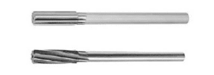

Chapter 3: Reamers (Smoother & More Accurate Diameter Holes)
Black cylindrical object with rounded ends.
Reamers offer a quick and efficient way to clean up the sides of a hole, make sure it is round, and get it to a particular diameter with fairly high accuracy,
In fact, reamers are so important for precision hole work that we've created a complete article that's just about reamers:

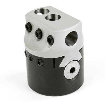

In CNC, we’re used to the idea of either drilling and reaming or interpolating a hole.  So when do Boring Head’s come into play?
The answer is that you generally use a Boring Head for larger holes when tolerances are tight. Another reason to use a Boring Head is to improve the surface finish of the wall.
A typical example of an application that might require a Boring Head due to tight tolerances would be machining a bearing pocket.
Setting up and running a boring head can be time-consuming, so they're generally only used on the most demanding applications.  Interpolation can be surprisingly accurate if you follow the tune-up tips mentioned above, so be sure and try those to see whether boring is necessary for your job.
If it is, here's our detailed guide to how to run a boring head:
[ Boring Head Operation & Boring Process Complete Guide ]

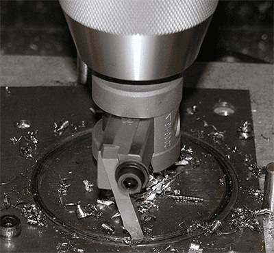

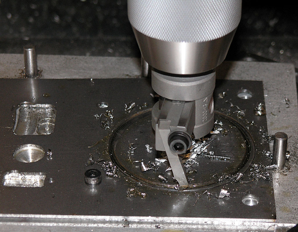

Chapter 6: Trepanning
Trepanning is a process of using a single-point tool to cut a hole.  It only works for through-holes, and then mostly for shallow sheet metal applications.  It’s not seen very often in CNC milling, though for turning, face grooving is essentially trepanning.
I see trepanning as a technique that’s handy to have in your toolkit, but you won’t use it much when you could simply interpolate instead.

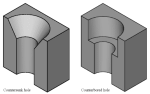

Chapter 7: Counterbores, Chamfering, & Countersinks
Three-dimensional illustration of a countersunk hole and a counterbored hole in metal.
Counterboring and Countersinking is all about special treatments at the top of the hole, typically intended to allow the top of a bolt to be recessed below the surface of the material.  A counterbore is cylindrical and typically is a larger diameter than the hole's bore.  A countersink is conical.
Chamfering is like a countersink, but much smaller.  It's more for deburring than fit of bolts.
For more on deburring holes, see our deburring tools for metal article.
Countersinks and Countersinking
Since countersinks are conical, a special tool of some kind is needed with the correct angle for the conical section to be cut.  Sometimes its convenient to use a spot drill to countersink if you have one with the correct angle and if that angle will serve for spotting.  With a little ingenuity you may even be able to use the spot drill for chamfering too, which really saves on tool changes.
OTOH, if you have special needs, you'll need to purchase a special countersink for your job.  Or perhaps a combination twist drill and countersink or countersink collar for your twist drills.  These are all possibilities.  Here's a typical countersink collar that's held on to the twist drill with two set screws:

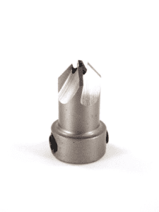

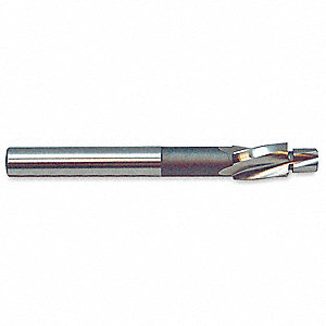

Counterbores and Counterboring
Here's a typical Counterboring tool:
Silver metal drill point tool.
There's a pilot and a helical cutter for the counterbore.  As mentioned, it's often easier just to interpolate counterbores with an endmill rather than use an actual counterboring tool.

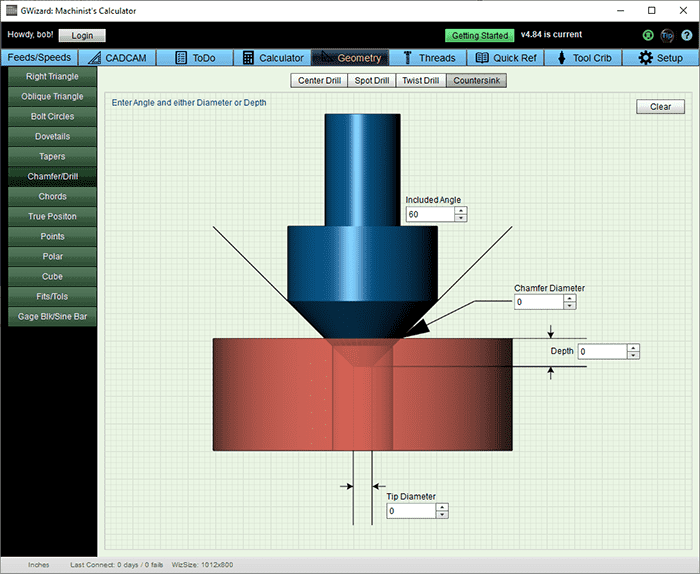

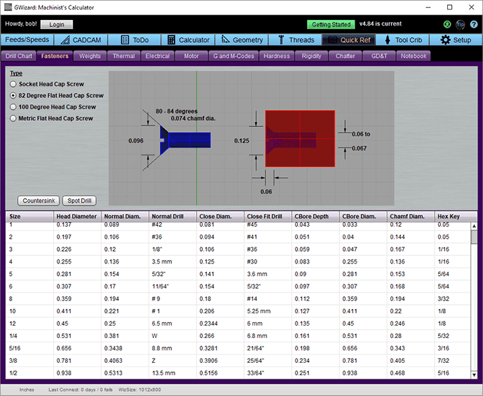

Calculating Dimensions for Countersinking and Counterboring
Any time you want to countersink or counterbore, you will need to look up the specs for the bolt you're working with.  Our G-Wizard Calculator has a handy reference for this:
Machinist's Calculator Tool for Drill Bit Calculations with table and dropdown menu
It's also handy to do depth of cut calculations in G-Wizard:
A computer screen displaying a 3D rendering of a machining tool with labeled settings.
As you can see it does Center Drill, Spot Drill, Twist Drill, and Countersink depth calculations.

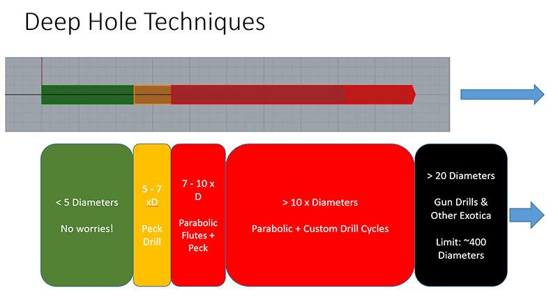

Chapter 8: Deep Hole Drilling
Deep hole drilling techniques in machining and metal fabrication.\
Deep Hole Drilling is a very specialized expertise that involves special tooling, tips, and techniques.  Fortunately, we have a wonderful detailed guide to it complete with a video:
[ CNCCookbook's Deep Hole Drilling Guide ]
[ Gun Drilling & BTA Drilling: Definitive Guide ]

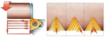

Single Point Threading is the most common way threads are cut on CNC Lathes, and they do it really well.  Here's a collection of articles to help you with it:
[ Programming Threading on Lathes with G76 ]
[ Chasing Threads on a CNC Lathe ]
[ Programming a Higbee Thread on a CNC Lathe ]
