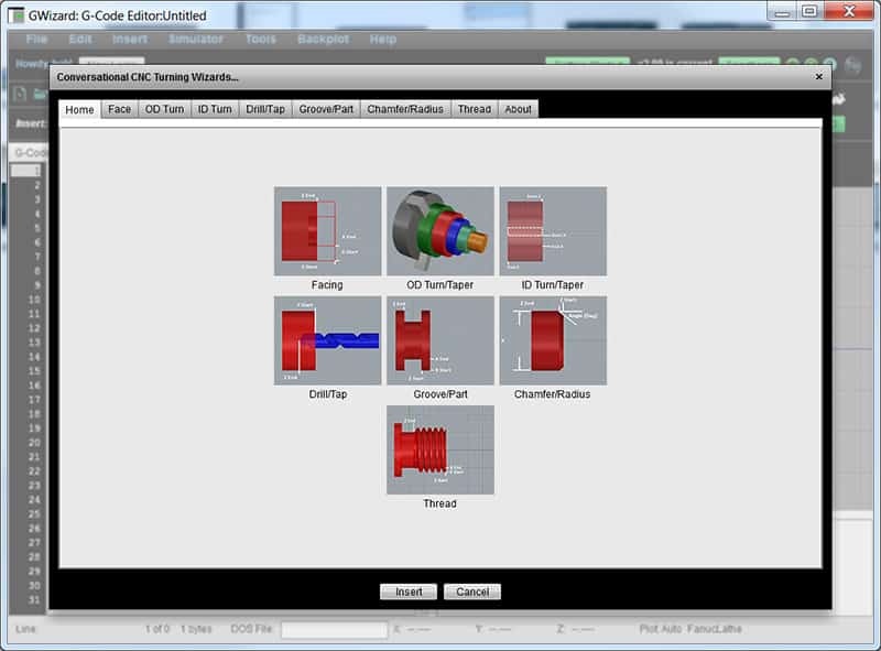

Up Your Game 7: Conversational CNC Programming
Does your shop have manual mills and lathes for jobs that are so quick and easy you don't want to use the CNC?
What's the biggest savings you get by using those manual machines?
Some would say you get to use a cheaper spindle for the simple jobs without tying up the much more expensive CNC spindle. That's a good answer, but remember, there are cheap CNC machines available too that could replace your cheap manual machines.
I think for many the real answer is that CADCAM is too cumbersome for simple parts. Suppose you just need a simple bushing for a project? It sure is easy to slap some stock in a 3-jaw chuck on a manual lathe and whip that bushing out in a jiffy.
How about a rectangular bracket with holes in each corner?
Again, it's awfully easy to stick that in the old Bridgeport in the corner and get it done without a lot of CNC muss and fuss. Many experienced machinists will get it done before they could create a CAD drawing of the parts, let alone do the CAM, get it on the CNC machine, and make the part.
So then what's this segment about?
What if there was a way to make your CNC machine just as convenient and powerful for simple parts as a manual machine? What if it was even more powerful and required no CADCAM whatsoever?
The technology to do this is called "Conversational CNC". Basically, you answer a series of simple questions, the Conversational CNC software squirts out a quick g-code program, and you can make the part very very quickly.
Here's a typical conversational CNC Wizard from our G-Wizard Editor, which includes a free Conversational Programming capability:
This simple Conversational Programming Wizard is for creating OD Tapers, and as you can see, it is super simple. Just answer a few questions and you get a quick g-code program to cut the taper.
G-Wizard Editor offers a bunch of these for milling machines:
And also for lathes and turning applications:
Using these Wizards you can make simple parts quickly and without needing to crack open complex CADCAM software. Save yourself some time and check them out with a free 30-day trial of our G-Wizard software. Here's more on the Conversational Wizards:
Conversational Programming Wizards
Show Me How G-Wizard Can Help With:

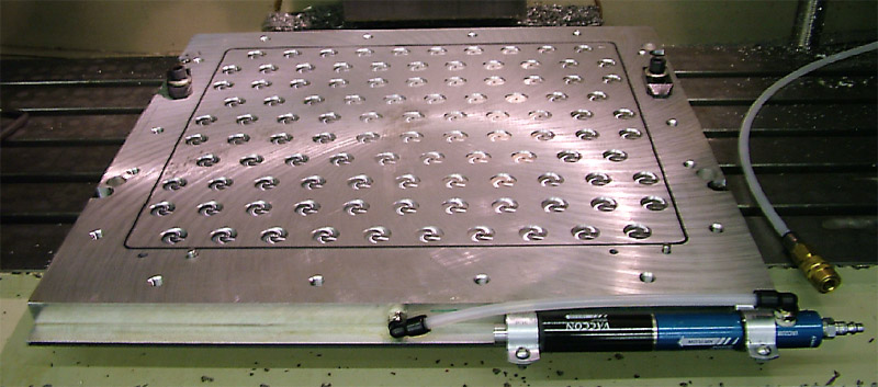

Up Your Game 9: Vacuum Fixturing
Have you tried vacuum fixturing?
If it'll work for your application, it can be one of the slickest workholding systems imaginable. In fact, for some applications, it's the only way to fly. For example, small thin plates. Say you need to engrave name plates or serial number plates. They're the devil to hold down and keep from flexing but a proper vacuum fixture can make short work of them.
There are some important ins and outs you'll need to know about vacuum fixturing to be successful such as:
- How to generate the vacuum
- How to protect your vacuum pump from coolant
- How to seal leaks to keep your vacuum working at maximum strength
- How to limit the cutting force of your tools so they don't pop the parts up off the vacuum fixture.
You can learn all that and more in our Complete Guide to Vacuum Fixtures:
CNC Routers often work with sheet material for projects like signs that are ideal for vacuum fixturing. See our special CNC Router guide to Vacuum Tables for more:
CNC Router Guide to Vacuum Tables

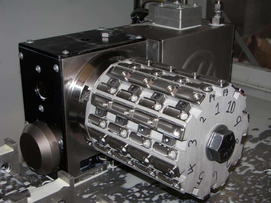

Up Your Game 12: Make Your 4th Axis Sing
Do you regularly use a 4th axis?
If not, you are probably missing out on the productivity gains they can provide. Forget continuous 4th axis contouring. There are definitely projects that need that capability, but most of the advantages of 4th axis boil down to putting more parts on the table and being able to access more sides of the parts without manual intervention.
When you use a 4th axis for indexing, programming couldn't be easier. Yes, most CAM packages will handle it. But, you can also just enter the axis moves yourself to rotate the axis to a fixed degree position before you continue machining. So, for example, suppose you've got a fixture that holds 10 strips of small parts on a 4th axis like this:
Each move is 360 degees divided by 10 or 36 degrees. So, start at 0:
A0
A36
<etc.>
See how easy that is?
If the tombstone on your 4th axis is easy enough to change, it can serve as a pallet too.
Check out our article on 4th axis fixturing for more ideas:
14 Great Ideas for 4th Axis Fixturing

Up Your Game 14: Learn Macro Programming
The reports of my death are greatly exaggerated — Mark Twain.
The death of G-Code programming is also greatly exaggerated!
We're getting near the end of the list, but I've same some real powerhouses for last. Take Macro Programming, for example. Many CNC'ers think they'll never have to deal with g-code because CAM can do it all.
Myth: G-Code Programming is a Thing of the Past
Reality: G-Code Programming Compliments CAM Extremely Well
Like Mark Twain sort of said, “The reports of GCode’s death are greatly exaggerated.” Even MMSOnline agrees that the idea G-Code programming by people instead of CAM software is still relevant.
How can that be true though? After all, modern CAM software is pretty darned wonderful about doing things a manual g-code programmer couldn’t even attempt. Programming a complex 3D surface is trivial with software like MeshCam, but pretty well impossible to do by hand unless the surface can be described by fairly simple mathematical equations. Why would you want to program any g-code by hand?
The answer lies in finding cases that are valuable but not addressed by CAM. These fall into the following general categories:
- Simple parts can be easier with g-code than CAM. You want a rectangular cover plate with 4 holes in it. If you’re proficient with g-code you’re done before you can create a CAD model, run it through CAM, get the gcode onto the machine, and run it. With Conversational CNC, you don’t even have to be proficient at g-code. For all those cases where you thought manual machining was faster, g-code or Conversational CNC will make the CNC machine an even better choice.
- Getting a Second Opinion on Your CAM Code. Even expensive CAM software can have bugs. Or, if they’re not strictly speaking bugs in the CAM, they may be problems with the post-processor. With just a little bit of knowledge about GCode and the help of a GCode Simulator, you can get a second opinion on the CAM-generated GCode and fix minor errors before you have to discover them on the machine.
- Specialized or Downstream Tasks that Complement CAM. As great as they are, CAM programs don’t do everything. There are many specialized tasks that are difficult or impossible to do with CAM. In addition, there are downstream tasks–things that come up when the job is actually on the machine that weren’t contemplated by the CAM or Post. Sometimes these tasks are relegated to GCode because the CAM software won’t do them. Sometimes it’s because the CAM is aiming at a generalized common denominator and something special comes up on the Shop Floor–for example, a slightly different cutting tool has to be used while we wait for another shipment of the normal tools. A simple feeds and speeds change in the gcode will handle it far faster than re-running the CAM, assuming we’re capable of making such simple changes.
It’s this latter category that I want to focus on here by providing an Omnibus List of Applications for GCode Programming alongside CAM. This article talks about 37 very cool things you can do with a little g-code that most CAM software can't do for you:
37 things you can do in g-code that CAM won't help with
