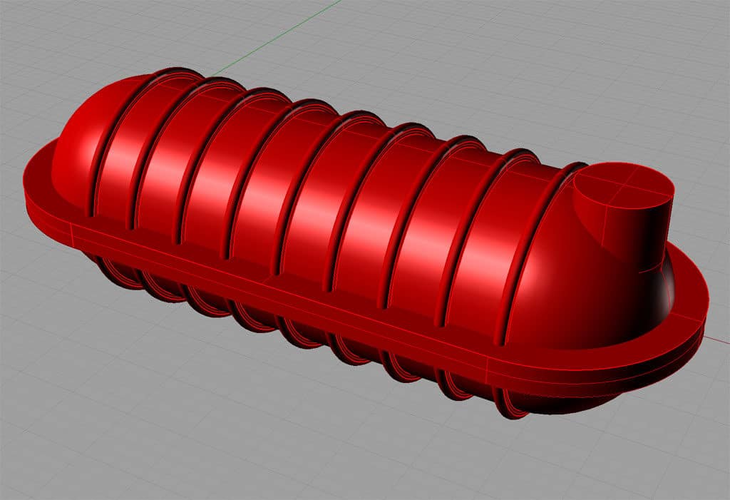

First, I went and found a suitable 3D model I had done in Rhino3D. MeshCAM imports STL files for its 3D models, so I exported one from Rhino. Here was my Rhino model:
Coolant overflow tank…
It’s a coolant overflow tank inspired by parts I saw at my friend Joe’s CNC business Crime Scene Choppers. I’m not so into bikes as hot rods, but I dig his retro-WWII-aircraft look. I do most of my machining in 2 1/2D, but this kind of part will certainly need 3D profiling to come out right.

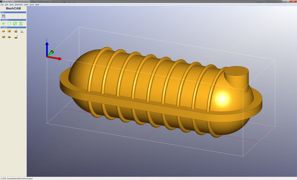

Okay, here’s our tank loaded in MeshCAM and ready for some toolpaths:
Note the nice clean and very graphical UI…
There are a variety of options available from the little icons that match the tank’s color:

Okay, let’s click that “Generate Toolpath” choice:
Toolpath options…
Other than selecting an appropriate milling cutter, all the right options come up pre-selected. You can fiddle around with them to optimize for your situation, or just let ‘er rip. Note that these are basically the same toolpath choices for 3D as my OneCNC uses, with some differences. I don’t have the highest cost version of OneCNC, so I don’t get a “Pencil Cleanup” path like we have here. They’re nice for running your ball endmill around the edges where things come together. It really helps smooth that “raster look”. Waterline is often called “Z-Level” in case you’re wondering. And, I have to do a fair amount more work to just bang out a quick program like I did here.

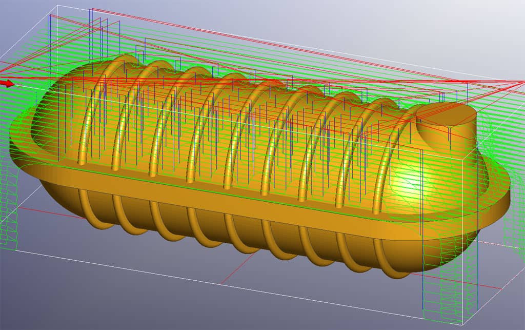

This is the backplot from just the roughing pass–too many lines if I add finishing to make sense of it:
